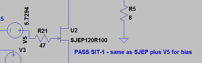

Yo Pa - I needed prediction for few values for servo circ and level shifter .......
I solved my dilemmas in simple way - - looking at Pass SIT-1 U/I graph , finding Ugs voltage for 22V/2A35 (ring a bell ?) , then finding by LTSpice shown Ugs voltage of SJEP'100 at 2A35 ;
so - for static biasing sim in LTSpice , PapaSit is SJEP'100 + DC Vgen of 5.7294V tied to gate ; 'course plus of it connected to gate , minus to other end , which will drive precious unobtanium

is there anywhere LTSpice model for SJDP ?
The following LTSpice model is courtesy of my graduate student who used it to sim power switching for his dissertation. One warning, no one I know has got the characteristic soft transition into saturation of a SemiSouth JFET modeled well in spice, despite some tries. He even worked at it for awhile until I stopped him because us power switching guys don't worry about precise modeling of the transition to saturation. We're trying to get out of it as quick as possible! So, no guarantee that this will predict subtle distortion properties convincingly.

Oolala. Thank you very much. Seems i have some simming to do.
Your welcome! You may notice that the model includes temperature variations. The value of that won't be lost on a Class A crowd like you all!
BTW, the credit for this model belongs to Dave Sheridan, SemiSouth's long time VP for Engineering. My student "borrowed" it for his work.
