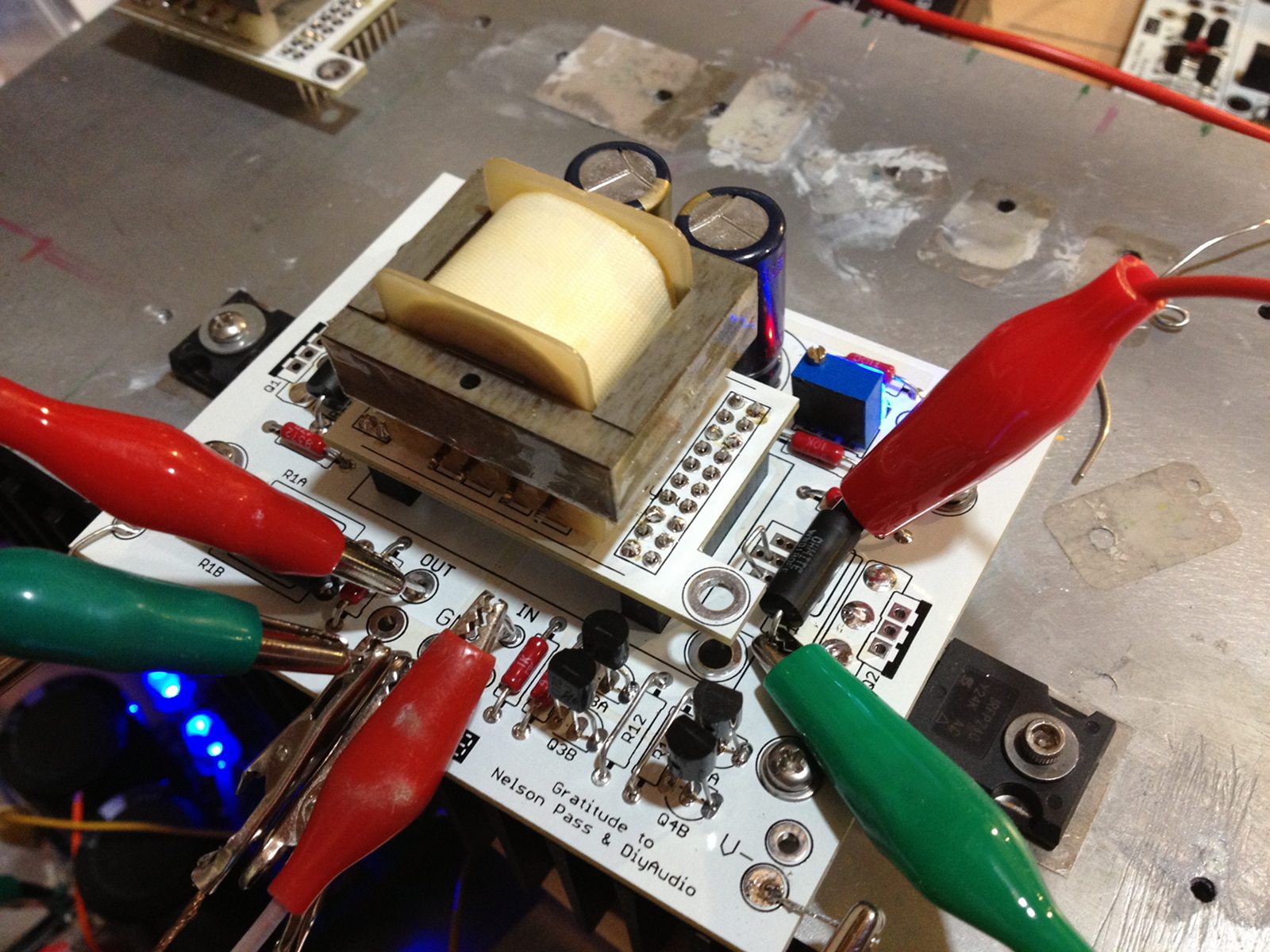

I completed F6 with IRF240's.
I used 1R Source resistors. The bias only went to ~500mv with existing 5K Pot.
Assuming I go, to .5R resistor, I think this will give me enough room to bias higher. I was too scared to add pots across the source resistor. With IRF240's I am not sure if that's a good idea, assuming the overall source resistance goes below <.5R overall.
If not I was considering changing R3-4.
Any thoughts?

nothing is stopping you from testing it

Good looking boards. Yup - you need to put LEDs in series or use zener diodes up around 6 volts.
