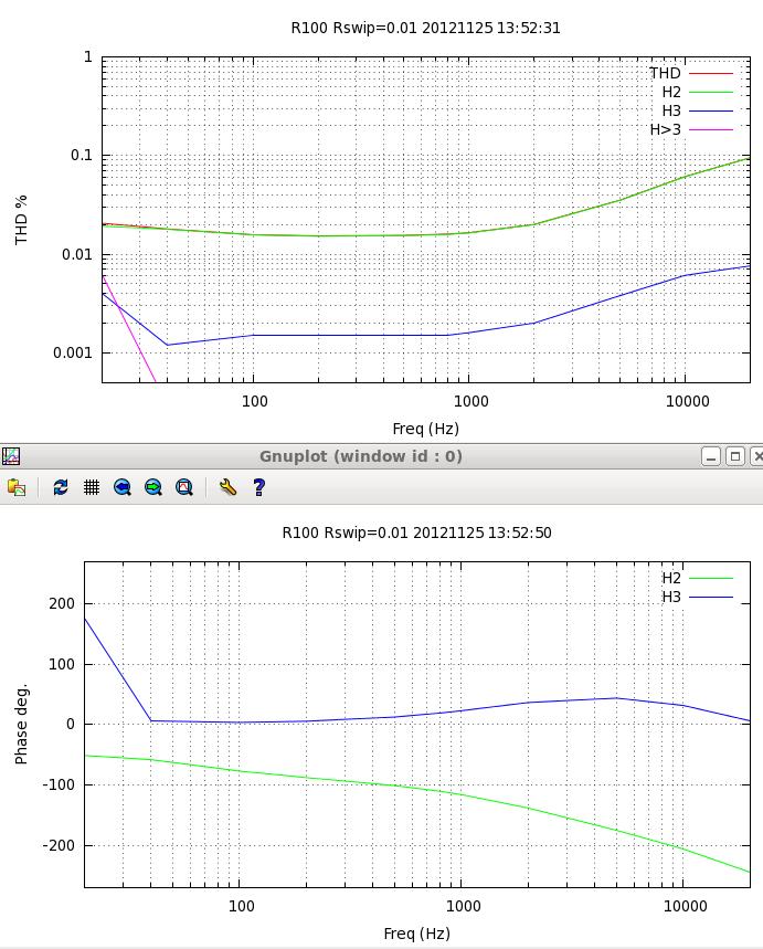

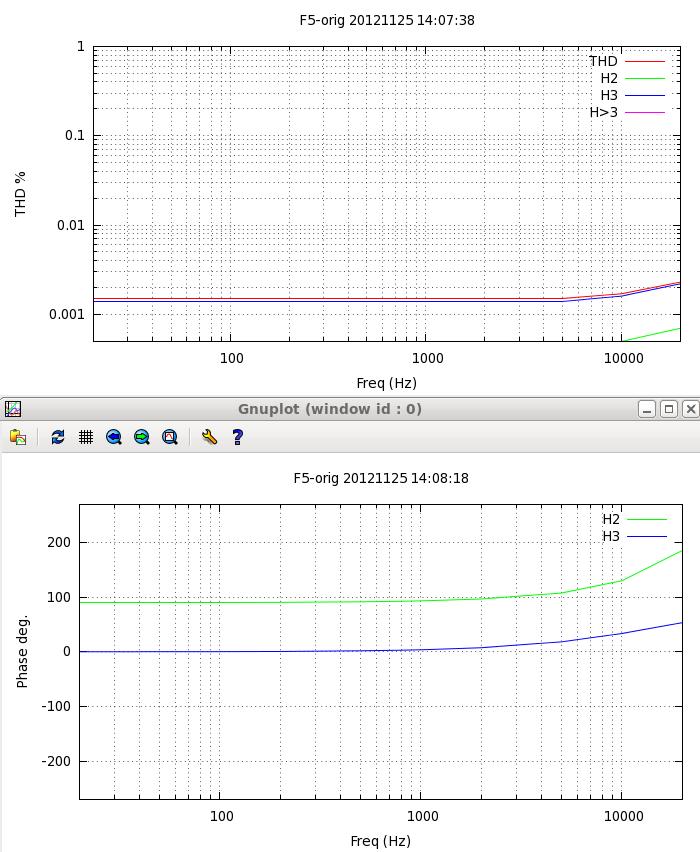

The transformer coupling in the F6 feedback loop cause the phase of the 2nd harmonic to vary with frequency. Here are THD vs Freq and Phase vs. Freq plots for the F6 and the F5. Not how much greater the phase shift is for the F6, particularly in the mid frequencies.
I suspect that this changes the sonic signature of the amplifier.

In my previous post, the F5 THD was so low that the phase change was totally determined by the MOSFET gate capacitances.

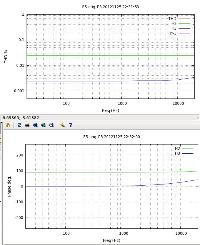

Here is the same F5 circuit with P3 adjusted for 0.025% 2nd harmonic. As you can see, the phase is essentially constant to 20kHz.

It would be hard to adjust the F5 to have 3rd harmonic high enough or
to have the H2/H3 vs frequency at all similar to the F6.
What would be interesting is to see H2, H3 plots with phase for some vacuum tube amps with sonic signatures that are at all similar to the F6.
Interesting thing would be to listen to both circuits adjusted for similar harmonic structure and see if they sound the same.
What I was really interested in with these curves was the variation of phase of H2 vs. frequency. Nelson has talked about having a positive (expansion) or negative (compression) phase relation between the H2 and H1, but this relationship is obviously non-constant for the F6, even over the range from 100Hz to 5000Hz, where there is about 100 degrees phase change.
I meant in general ratio, not 100% matching. At the very least, it would tell you the importance of having it flat across frequency. In reality, things start to become background above 8K-10k
If I had a 300B amp, I would mail it to lhquam asap. That was very interesting! Thanks.
I think the relative amplitude and phase of harmonics is what imparts a characteristic sound. You may be on to something here.
I find your choice of a triode amp for study by lhquam to be interesting. I have speculated in earlier posts that loop feedback in F6 reorganized its intrinsic OLG pentode charateristic curves to triode-like ones; by analogy with Schade Feedback in vacuum tube circuits. OLG F6 is a voltage controlled [modulated] current source which has published pentode characterisics for its output stage JFETs and also for the future diyF6 with output MOSFETs. The question which hangs or put this way: how does one prove whether CLG F6 has been transformed to a voltage controlled resistor like a triode and/or its amp?
