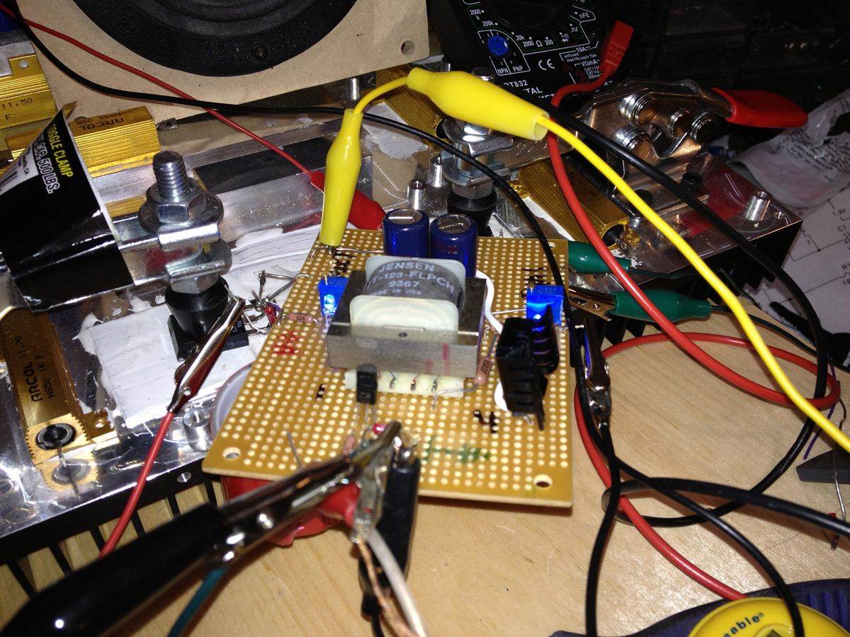

Has anyone built an F6 with "standard" MOSFETs? What is needed for temperature stability? Will source degeneration be enough or will active thermistor control of the bias be needed?

Is the extra 5 watt gain in the F6 due to the transformer in the circuit or the quasi push-pull output stage?
Another question- Can SemiSouth 085 be used?
You mean extra 5 dB?
I should explain myself. Most FW amps are low watts 5w-15w, but some are 25w. The F6 is 30w. The PS voltage is 23-24v on most FW amps. The F6 is also 23v. So, is there some effeciency gained somewhere in the F6?
From 6Moons article. "You've seen this supply many times and here it is again. It's got 18-volt secondaries that you can get from Antek or Plitron."
"As a push-pull Class A amplifier we traditionally expect it to operate in Class A to peaks of twice the value of the bias current. With degeneration a circuit designed to operate at 30Wrms into 8Ω in Class A would by definition leave Class A at 60-watt peaks. "

Here is my P2P F6. Not exactly totally safe construction.
I biased at what I think if 1.5A.
Measuring V across resistors in standard Pass supply.
1.5 x .(4x.47R) in power supply = .176
No big sound evaluation yet, just one mono CHR-70 running no baffle.
I have ordered The Cree SIC Mosfets, and will modify this to use them adding more LED's.
When no degen., the mosfets square law allows one half to run more than twice the bias before the other half cuts off. This for class A power.
There is more power into 8 ohms because less voltage losses due to no degen..
