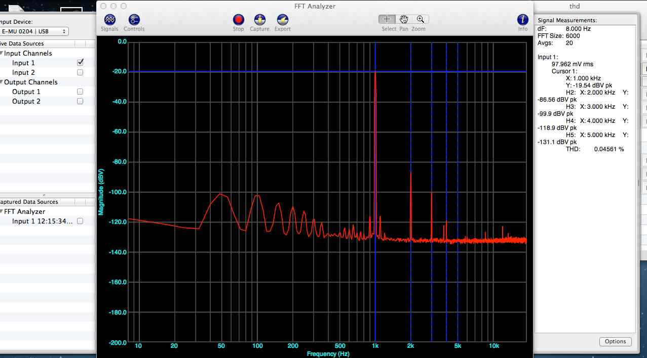

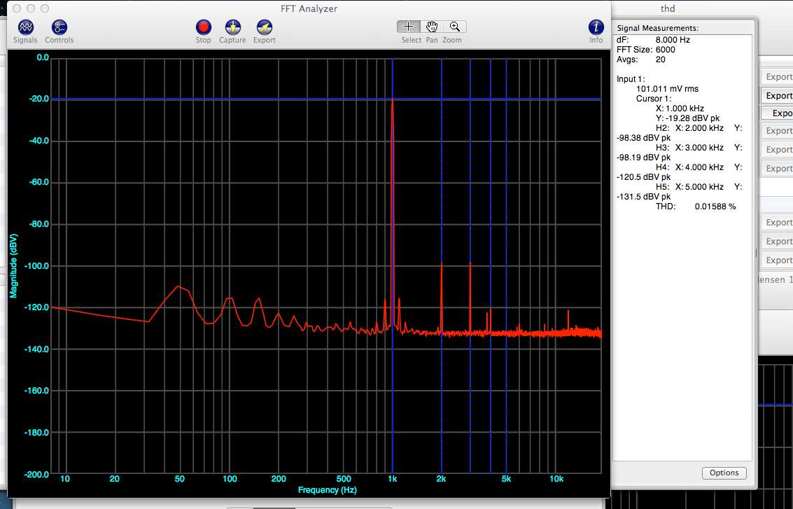

some news from Frankenstein 6....:)
very different pictures, may explain a bit the different character of sound Jensen versus Edcor with my build ...first picture Jensen, second Edcor...
I have to play with the two pots over the two secondaries..... 500R are a good starting point to mistune the distortion ......:D ?

Edcor looks good to me, but if you can tune out some of the third on the Jensen, you are sitting pretty, I think. I guess that you will probably obly be able to add second, but you never know. Does this show that the Jensen's secondaries are more balanced. This assuming you just swapped the trafos.
Joined 2009
yes I just swaped the trafos...same SS side. But of course the data of the Xformers are different.
I will try some more feedback on the Edcors and when I trim the Jensens to have about 12db more k2 over the k3 I have a THD of 0,086%, unfortunately!
