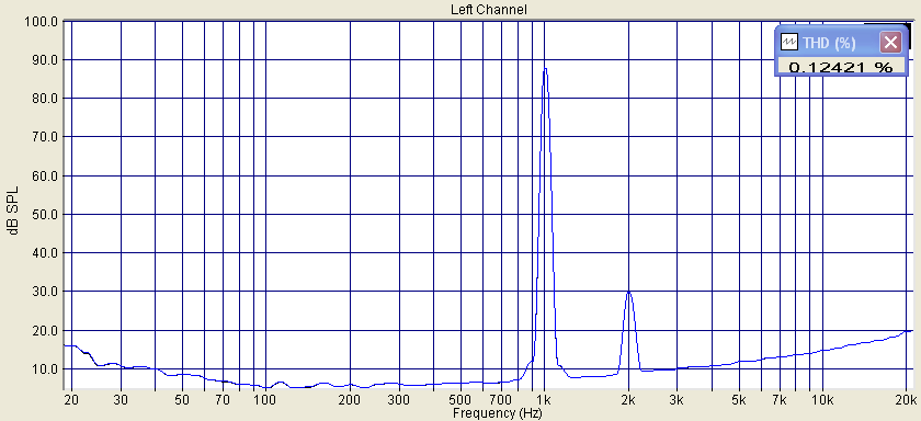

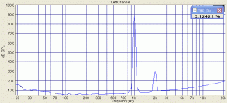

Trying to get there. Still got this prooving somrthing bug I gotta grow out of. Stupid kid. Here is THD spectrum of 6V6 Pre. B1 is clean and neutral. THis thing of course adds something. I like both. Its like picking vanilla or chocolate.

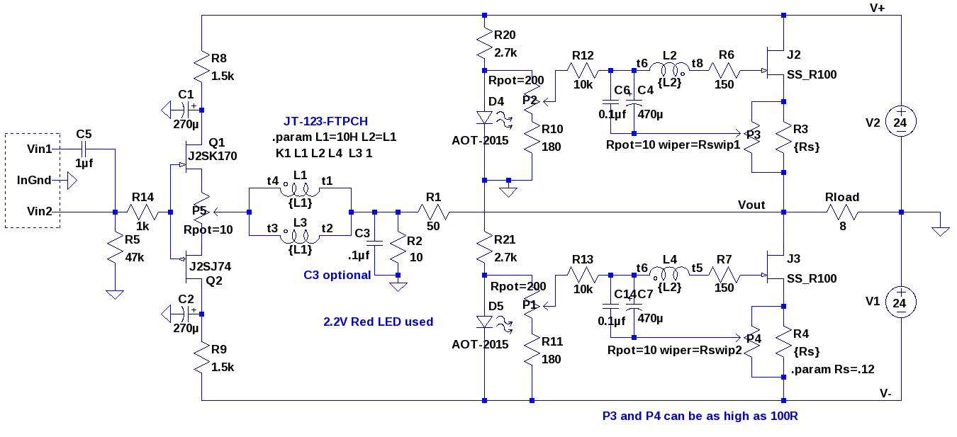

Got Turkish coffee for this guest; semi-sweet pls? Back to IGBT. It expands the universal scope of Conceptual F6, and more importantly may simplify its assembly because of the integration of multiple IGBTs in one package.
  • IGBT has the high input resistance of MOSFET [no DC through transformer] and the high transconductance of BJT which may give a higher OLG [and benefits or ills ] than attained with JFET.
  • The attached file shows the diagrams of packaged IGBTs [K, L, M] from a catalog of International Rectifier. Package M has the output stage of a clone of Conceptual F6. Most probably this pair has matched characteristics if cut from the same fabrication die. Packages K and L have multiple IGBT pairs.
Rush is interested in using MOSFETs in his clone of F6. This file also shows packages with multiples of MOSFETs which may have matched characteristics.
