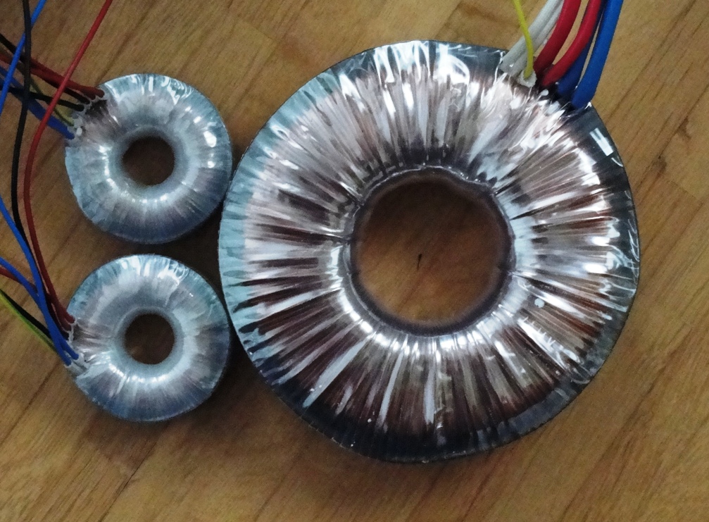

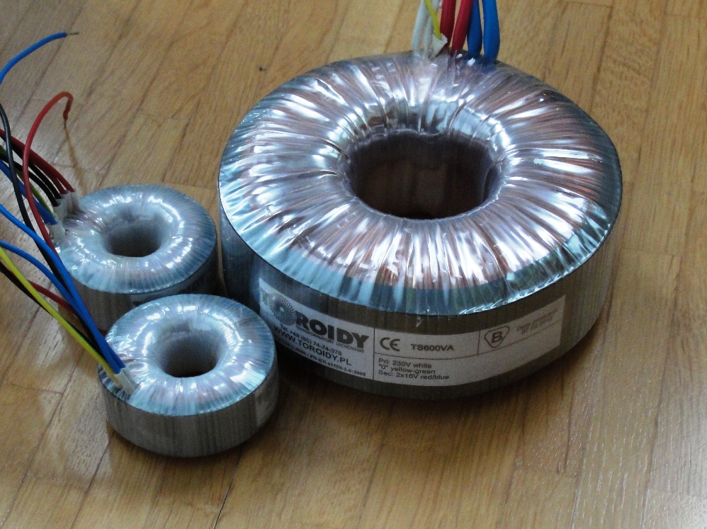

Got my pair today.
Measured the idle current with open circuit secondary.
Careful, the phase of the secondaries is not marked.
@ 230Vac Ipri=13.5mAac
@ 240Vac Ipri=14.7mAac
@ 254Vac Ipri=17.3mAac
That 254Vac primary current is very good for a 230Vac transformer rated at 600VA.
We will have no problems running these transformers on any of the 220/240Vac supplies.
