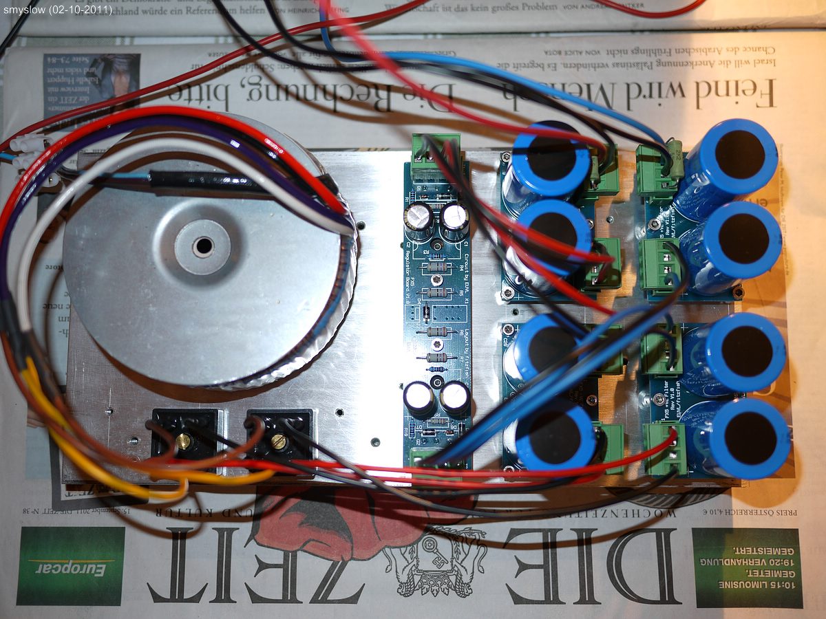

I have another piece of good news for you. :)

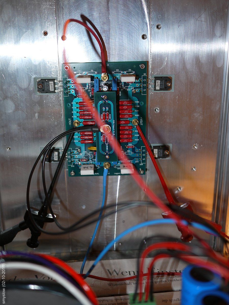

A test team member has his proto fired up and working.
So the PCBs should be OK, thanks to Dave's immaculate work.
I shall release them next weel to the forum so that you can pre-order.
As you can see he is not using the current limiting circuit.
He is also on a special mission to test other output devices other than 2SK1530/2SJ201.
Distortion measurements next week if he can find time.
Herzlichen Dank Uwe.
The schematics of the standard circuit will be released once it has been tested.
I am busy arranging that right now.
Greg, please kindly get in touch by email.
Patrick

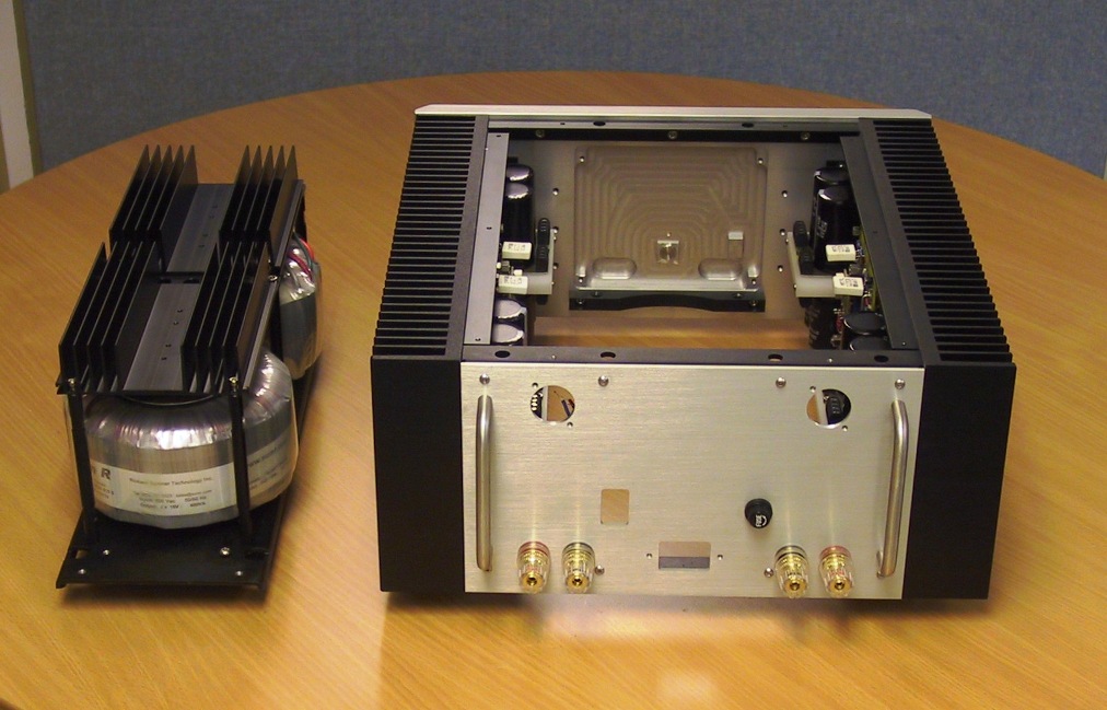

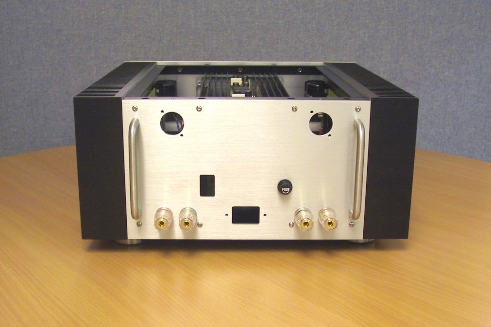

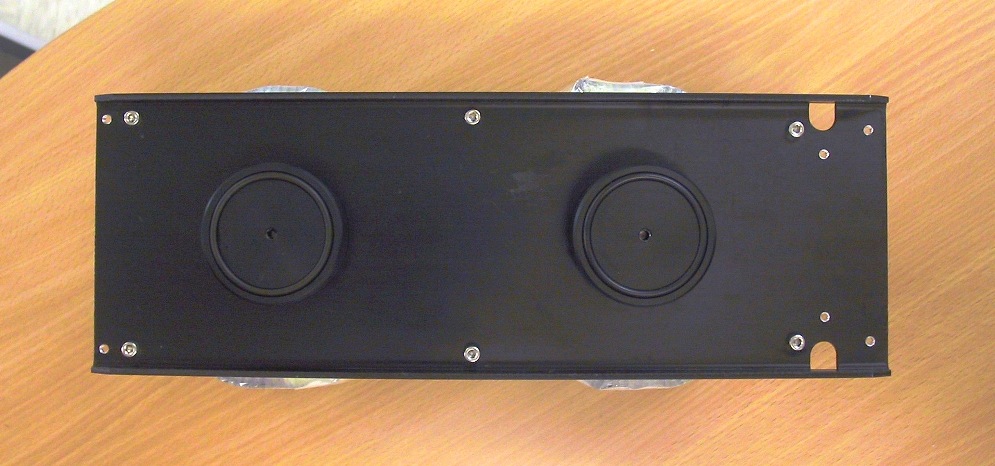

Mark & I spent the most of today to put one of the Gb F6\5X Case parts together.
The good news is that there is neither design nor manufacturing errors.
Everything fitted perfectly. And the appearance turned out as we expected.
The vibration isolated cradle can also be locked and unlocked as planned.
Wiring space is tight, but not as tight as I initially thought.
So I declare myself more than happy with what we are offering you.
As said, I would not hesistate to use it myself, which is the standard of acceptance.
Patrick

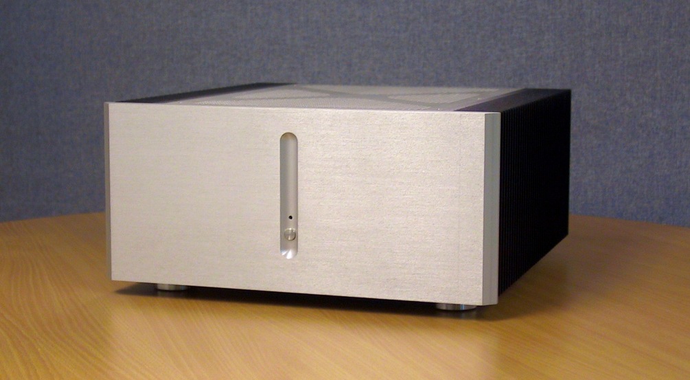

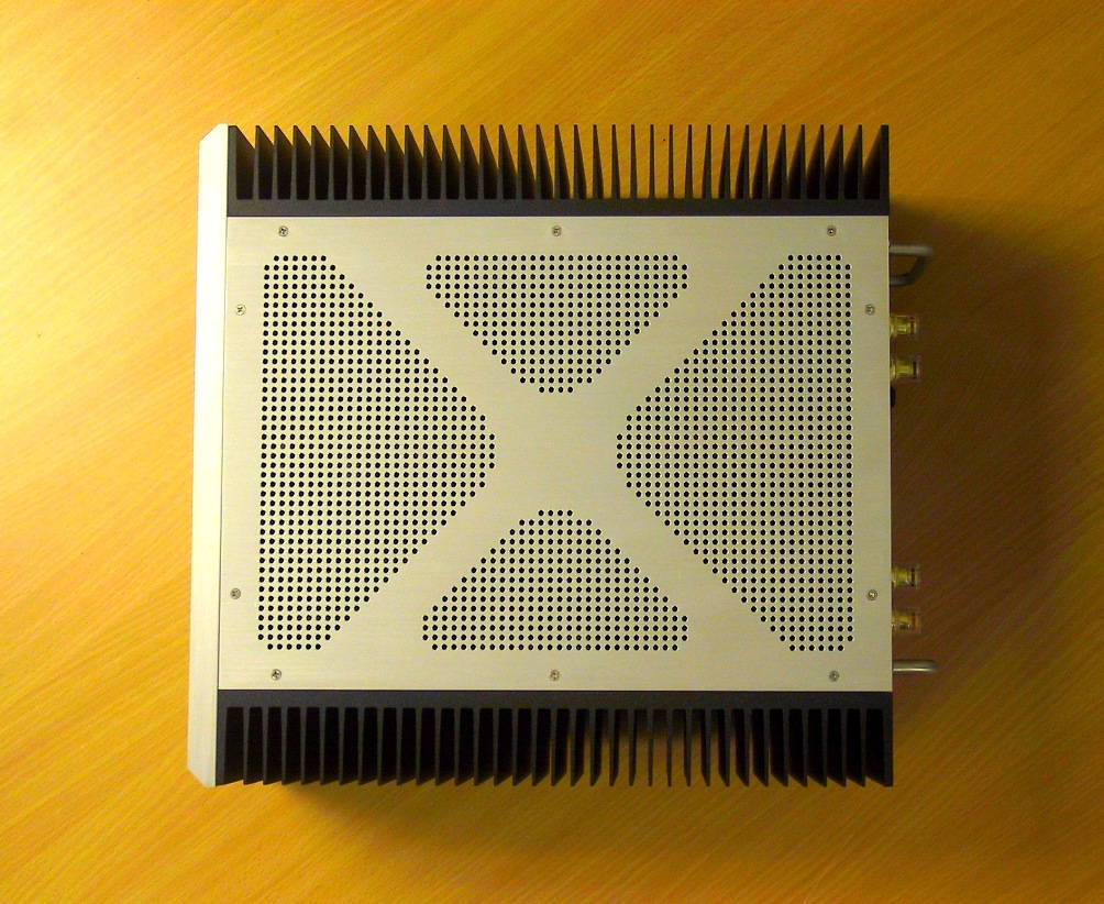

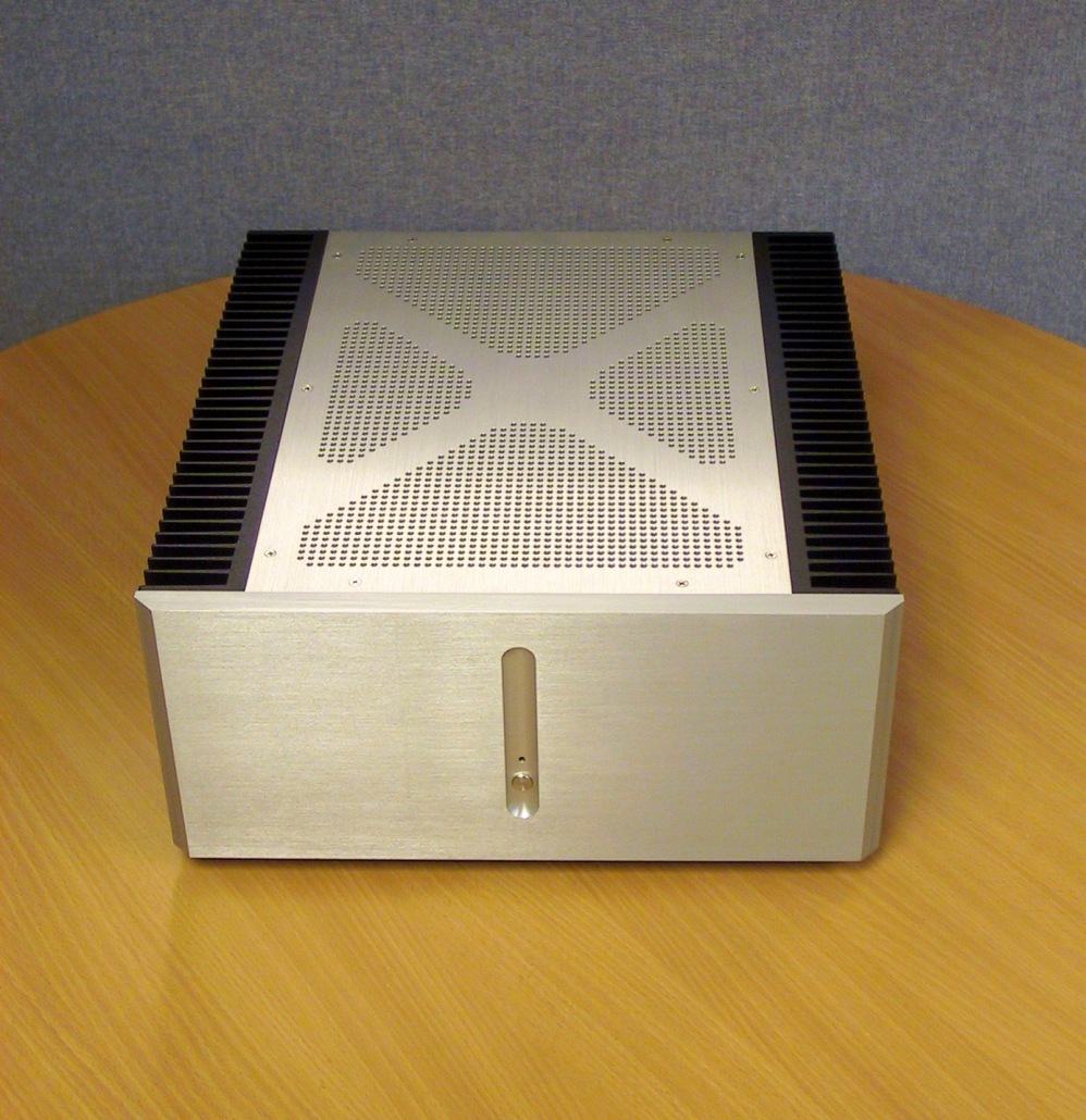

We are going to take you through the assembly, starting from the finished product, and removing parts to review the inside, one by one.
Starting with the overall views.
Only the few screws on the top are visible, and nothing protruding above the metal surface.
This is only possible when the machining tolerances are tight enough.
Patrick

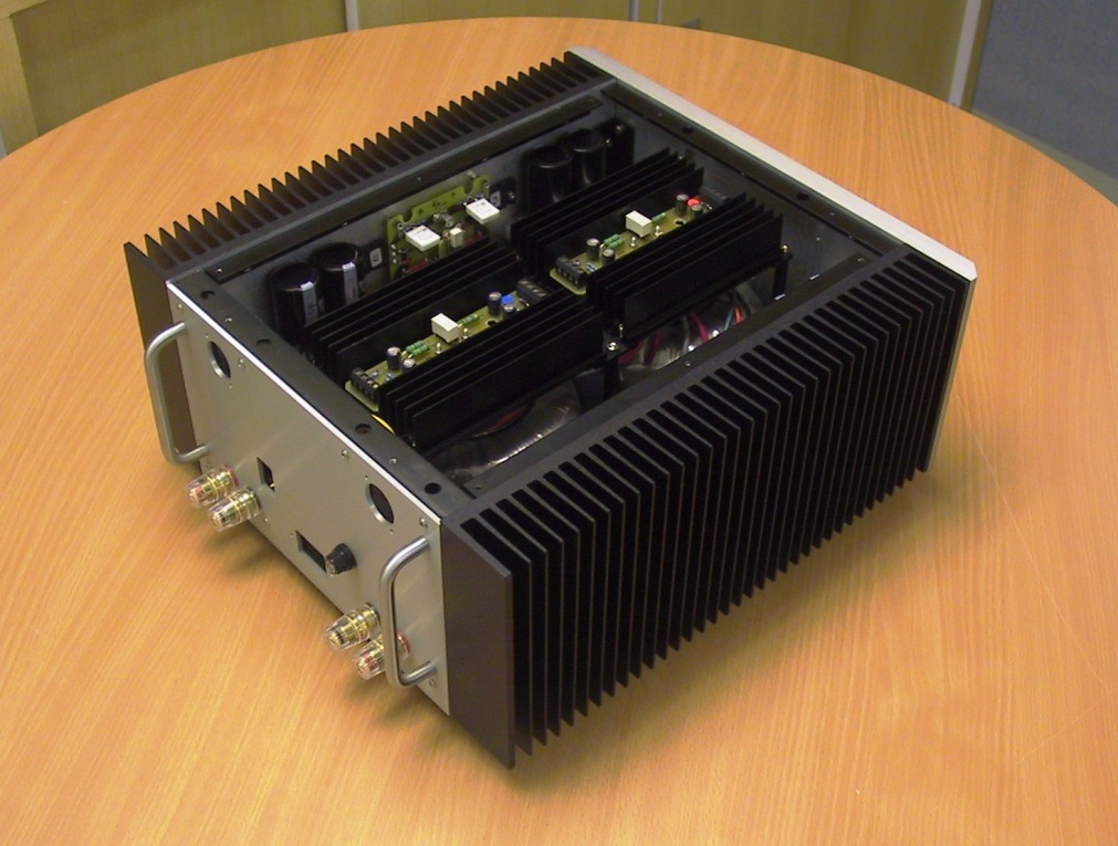

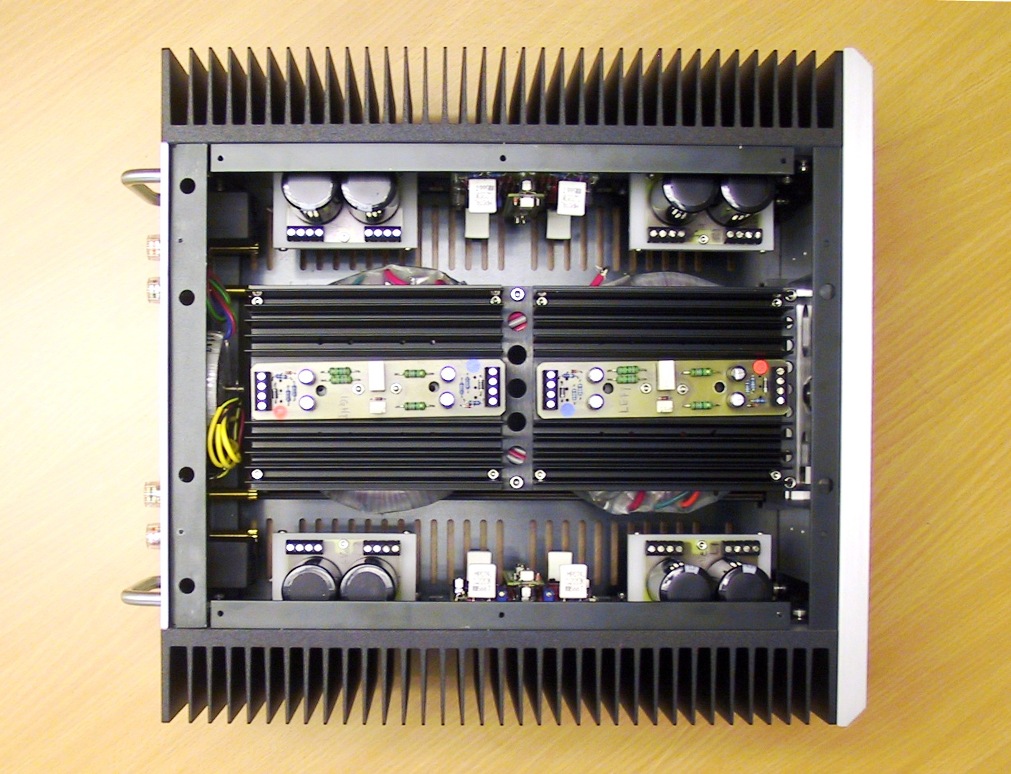

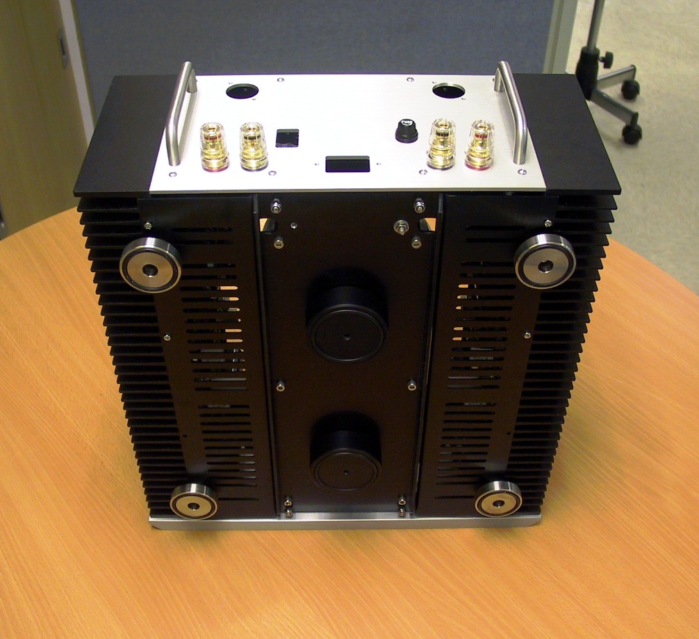

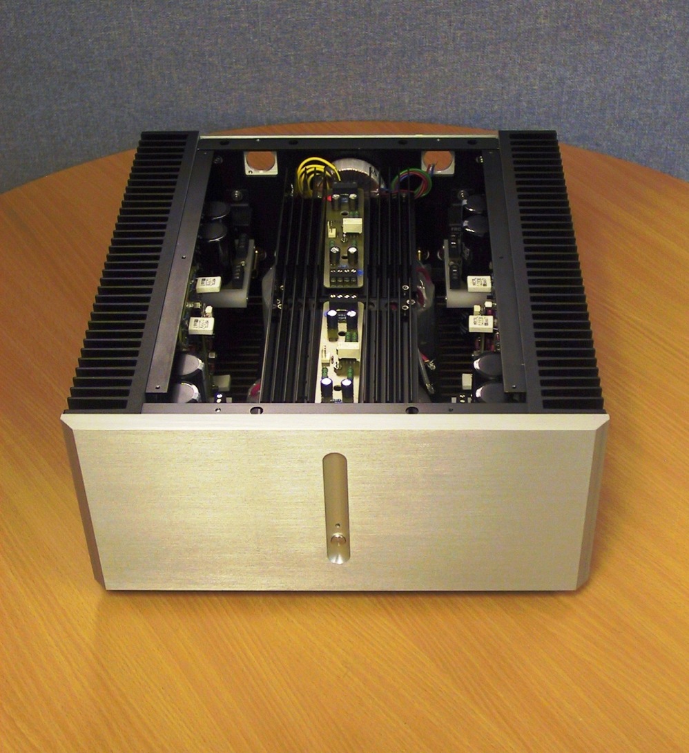

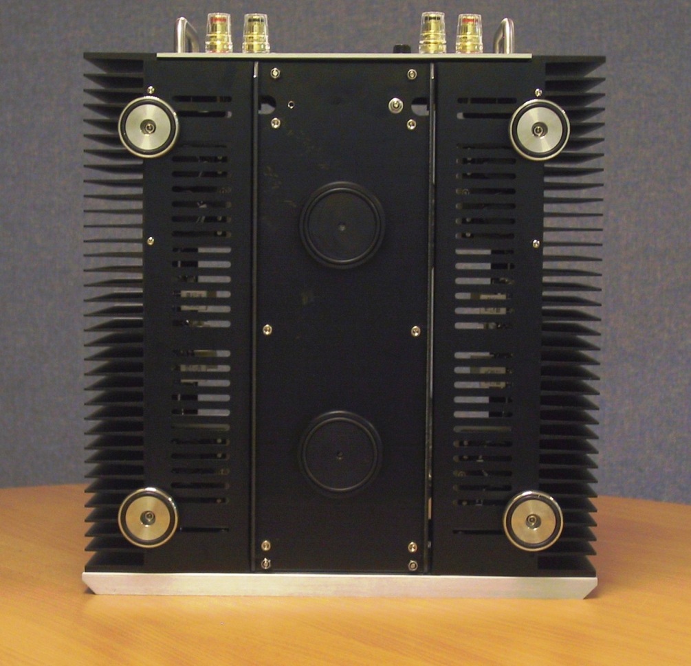

Removing the top plate to show the components inside.
Overall wiring not completed yet.
Amplifier modules, Capacitor modules, Regulators are all clearly visible.
Patrick
