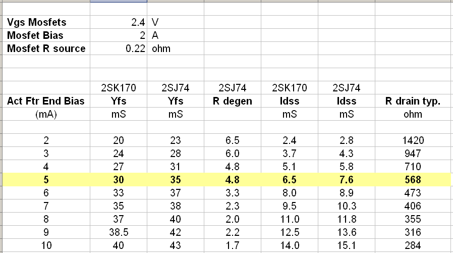

6-7mA Idss are rare for BL grade. Most of them are around 8-10mA.
That is why I give you a table so that you can pick what you can get your hands on.
The only difference is the amount of negative feedback, which is proportional to the drain resistor value.
That is, the smaller the Idss, the larger the Rd, the more NFB you get.
But load impedance also has a direct influence.
So for your purpose, anything from 6-9mA bias is OK.
