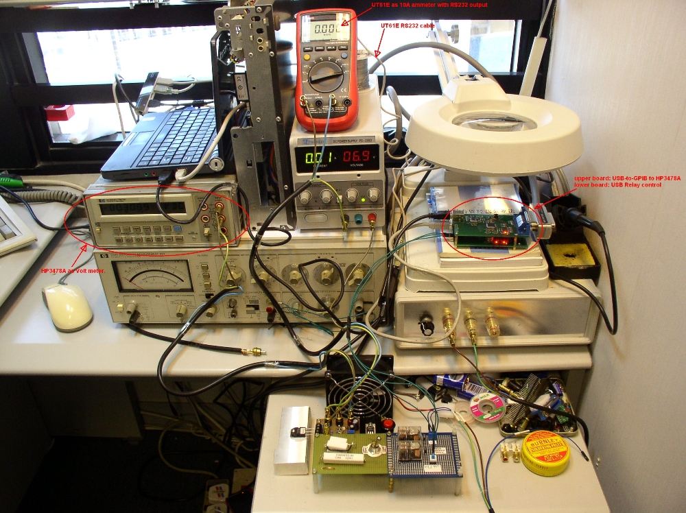

We have matched all regulator MOSFETs and will ship them in the next 5-10 days.
The mean Vgs for 2SJ618 at 4A is -2.79V, that for 2SK3497 is 2.56V.
There is not one single N-P pair of FETs where the P device will match the N device.
But N-N, P-P pair match is much better than 10mV in almost all cases.
For regulator use, this is totally overkilled, since the output voltage determining Zener diode has much more tolerance.
The P-N mismatch can be easily overcome by buying a bunch of Zener diodes and cherry picking.
Fitzfish will demonstrate this with an example in his test build report later.
Patrick
For those interested a picture of our quick & dirty computer-controlled matching station.
Matching was done at 4A (exactly as in circuit), 5 readings for each device.
Patrick
