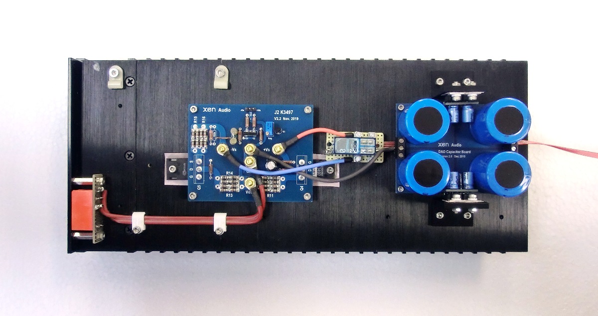

Another component that I have changed for my own monoblocks are the speaker relays.
Initially I have chosen high current automotive relays for lifetime reasons.
But these require a corresponding high minimum current for it to make electrical contact properly.
So in my J2 build, for example, I have tried out gold plated 8A relays :
Schrack RY212024 or RTE25024
The gold plating helps against oxidation and is worth having in any case.
FirstWatt J2
https://www.diyaudio.com/forums/att...477061-firstwatt-j2-191204-j2-k3497-proto-jpg
If you wish to try these, there is no change required in the protection circuit.
Just sibstitute. And you need a slightly different mechanical mounting, without saying.

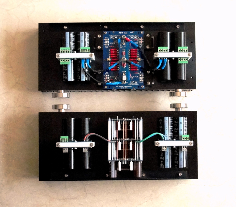

F5X Monoblocks
I guess an update to the F5X project might provide some additional motivations to the GB3 subscribers.
The original prototype from 2012 is now with another XEN team member in Hong Kong.
So it is time that I rebuild a new pair, to go with my finished F5X Pre.
It is also known that I have a pair of Accuton CELL speakers with active crossovers.
Milestones Speaker project
The new F5X should therefore be adapted to drive the Accuton mid-range and tweeter.
Whereas the bass unit is to be driven by 3x LM4780 in parallel, configured as inverted balanced.
The difference in closed loop gain between the F5X and the LM4780 has to be taken care of in the active crossover.
This will be placed on the rear panel of the case.
So each case now accomodates the two amplifiers for one channel.
But it only has the dissipation of one F5X, plus a tiny bit extra from the chipamps.
Here is a picture of the finished amplifier modules.
More will come in the next weeks and months, as I finish the other modules.
Patrick

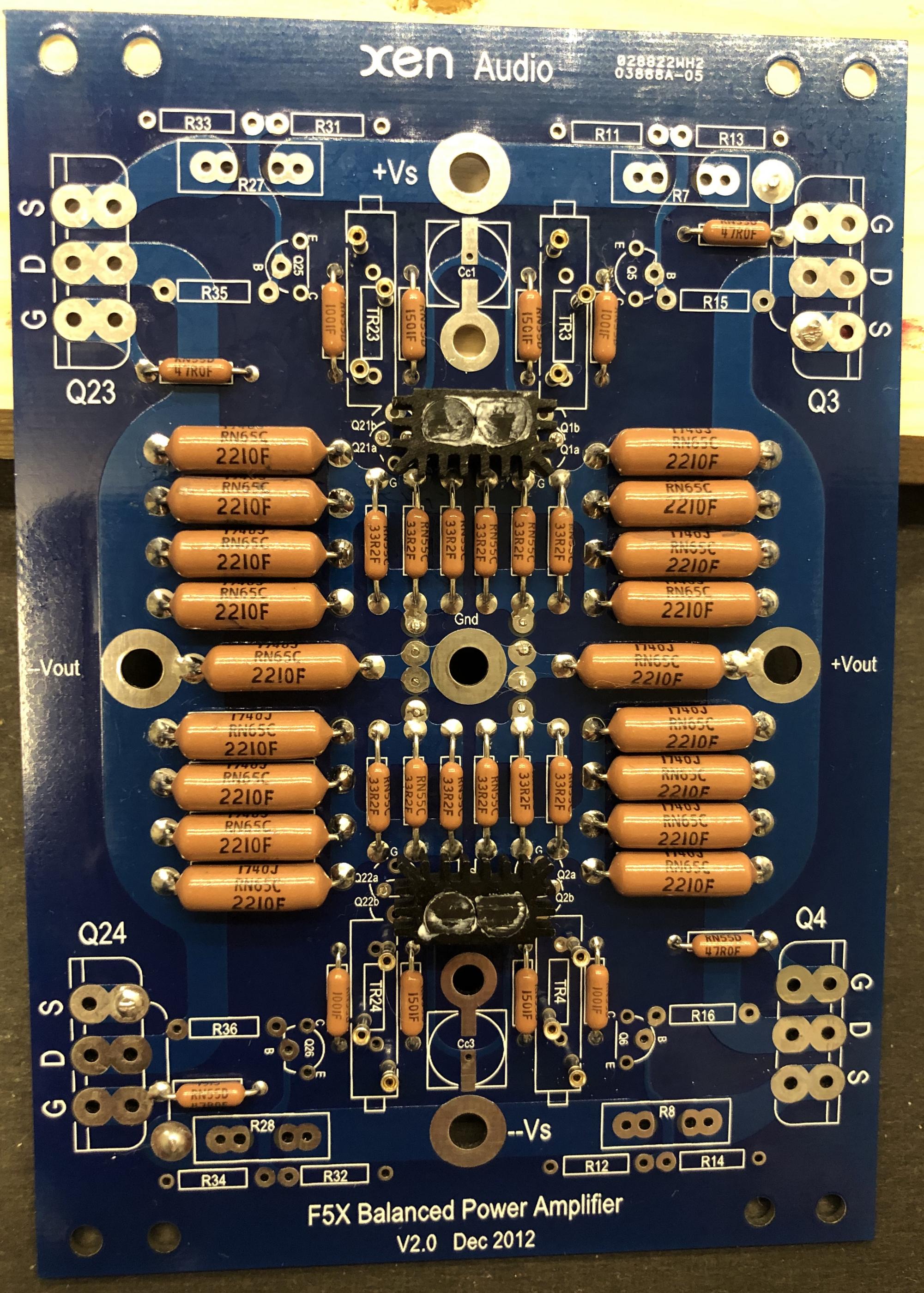

I started to fill my Mouser shopping cart with the F5X power amp PCB parts in order to reach MOQ for free shipping and noticed that the RN55 33ohm and RN65/70 220ohm resistors are out of stock and available in June 2020. Is it ok to replace the 33ohm ones with Beyschlag MELF? There are pads for MELFs under the PCB.
How about Vishay CPF3220 for the 220ohm replacement?
Hificollective seems to have PRP 30 and 220ohm resistors in stock, but I guess they are out of the question. How bad were the reliability problems with these? Maybe they have improved.
I want the boards to look good as well, so I tend to use the same type throughout.
The pads at the back can be used, but they were primarily intended for trimming purposes.
(I might remove the trimmers later and replace with fixed Rs.)
And Mouser has plenty of 33.2R in stock.
Also CMF55 is essentially the same as RN55, so those can also be used.
In choosing resistors, I would be willing to spend a bit more and choose a lower tempco (e.g. 50ppm/K or lower).
It reduces distortion.
CPF3320 is not thin film.
CMF65 and CMF70 both have 250R, which you can parallel with a 1.8k (e.g. RN55) to get 220R.
I have not been using PRP lately. So I cannot comment.
But when we talked to them last, they had such a poor attitude to that defect, that we deciced not to deal with them anymore.
I rather trust Vishay for their quality control system, especially for MIL spec products.
Patrick

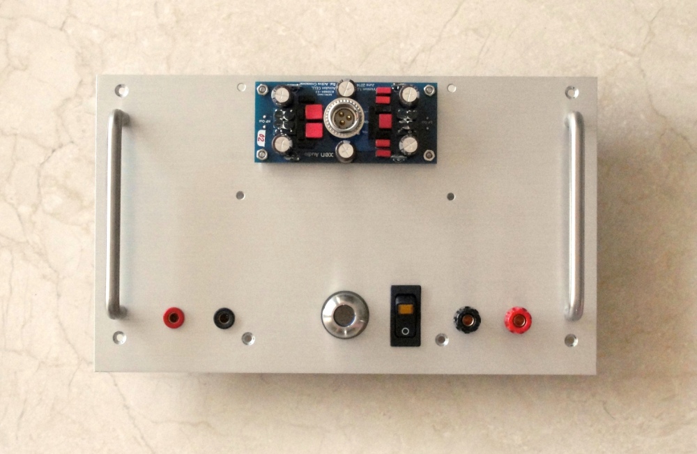

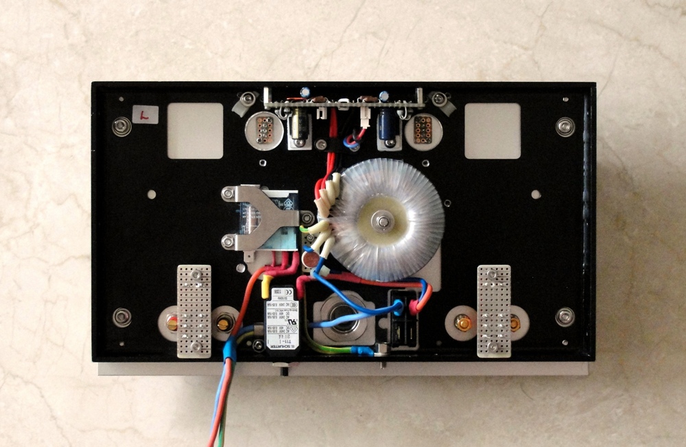

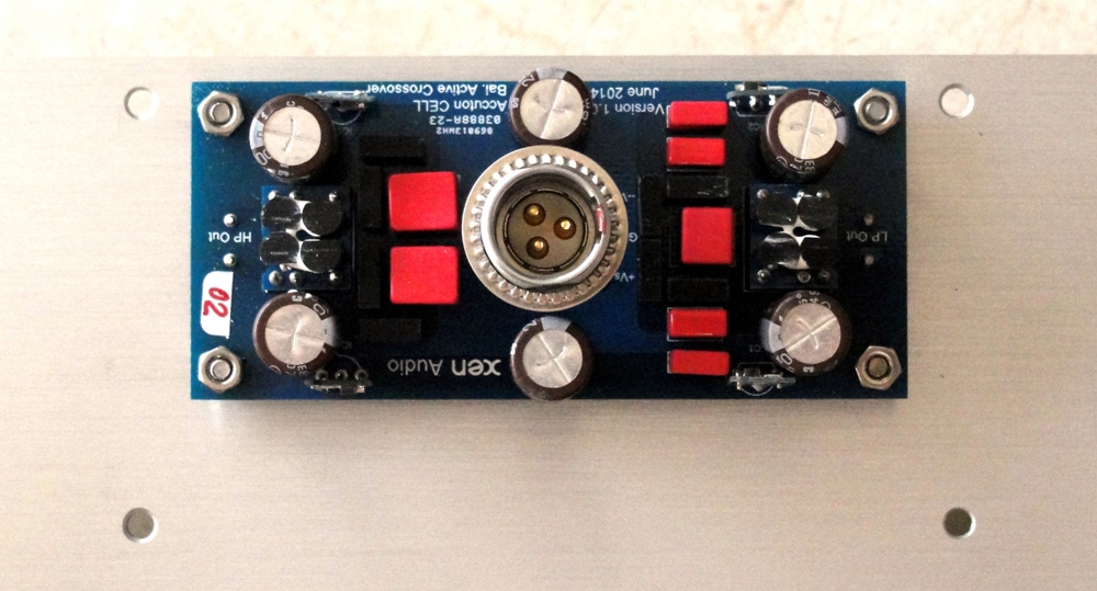

Some more progress in lock-down time.
As you can see, I do not follow the standard layout, which was decided by majority vote in GB1. :)
The aux. transformer supplies the active crossover and the protection board at the same time.
They are isolated from each other by separate 7812/7912 regulators.
The active crossover has additional local LT1761/1964 regulators.
Patrick
