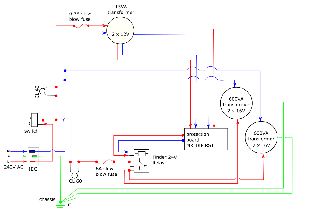

How does the protection board control the regulator board? It seems that the common connections have by-pass the relay on the regulator board.
thank you for that connection schematic

anyone using F5X without protection board ?
Not that I know of.
You can do it without the protection board but obviously, you won't have speaker protection and the standby mode.
Use the CRC filter board. Then you need not the auxiliary transformer and also the mute relay on the daughter board of the main board.
You can opt for the slow start board and the speaker protection from diystore but i am not sure if you can use the speaker protection board.
