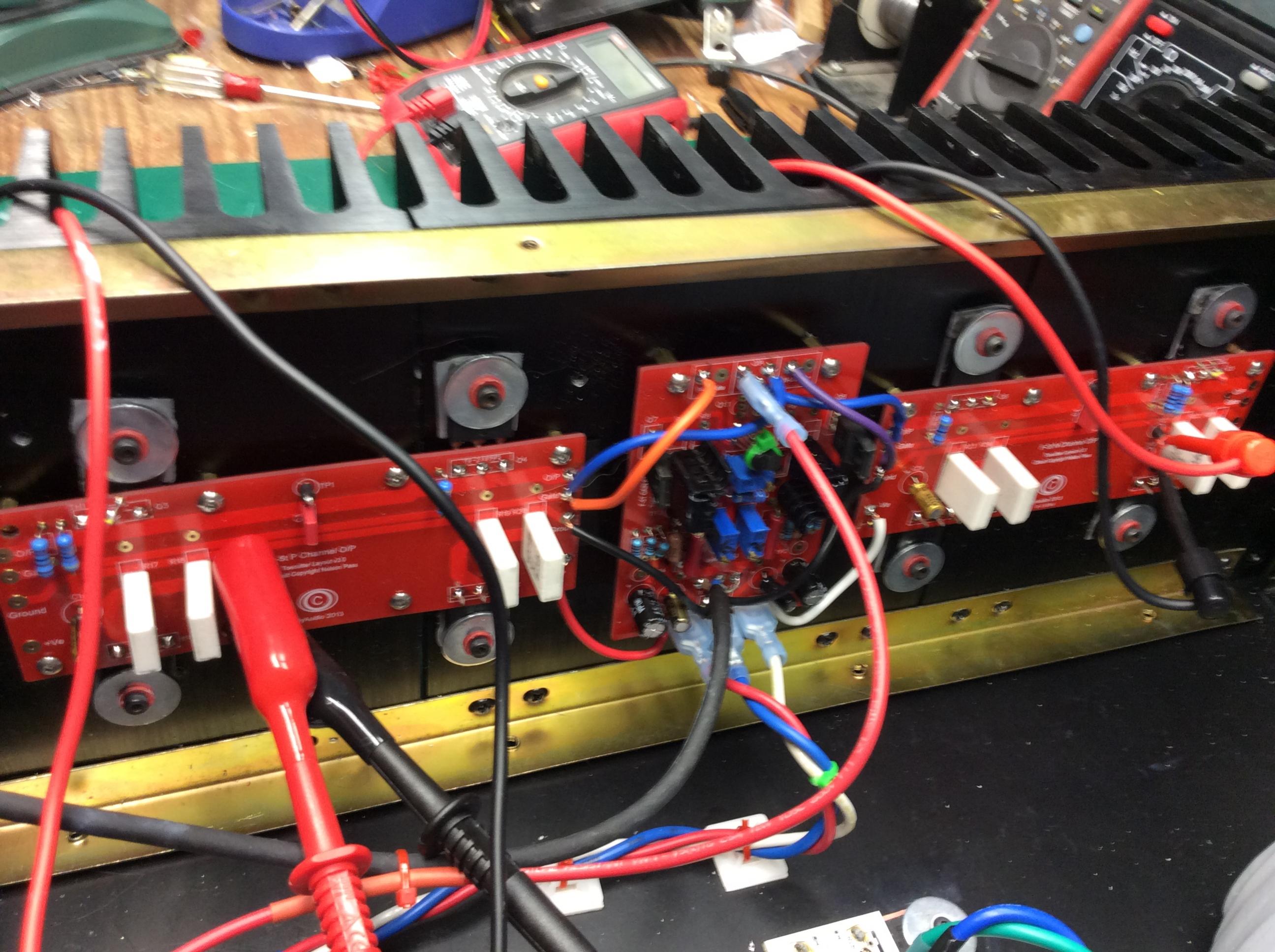

Bias stopping at 11.5mv?
I finished building the F5T vs with cascode and I'm setting up one channel and it set up just like it mentioned in the build guide with one pot adjusting the bias and the other adjusting the offset. The problem is the 5k pot reaches it's maximum turns at around 11.5 mv.
I'm using FQA16N25 and FQA12P20's the input fets are matched and the output mostfets are tested on my Peak Atlas and P's are matched to P's and N's to N's.
I was wondering if I need to change the values of P1 and P2 or do I have another problem. Heatsinks are not warm at all so I don't think the MOSFETS are really turning on?

Try increasing R5 & R6 up to 2k. It could be the gate threshold is a little higher for the FQAs. Don't forget to return P1 & P2 to zero before powering up again.
It's not really one is bias and the other offset. They're both bias adjustments, one for N channel and the other for P channel. After turning up say P1 and then you turn up P2 until you get zero offset, it means the N and P channel bias currents are in balance, which gives a zero voltage at the output.
Start with around 200-250 mV and let it cook for while with the cover on. Then go back and increase to around 300 and let it cook again. Then go a little closer to your goal, let it cook, and so on until bias and offset is stable at the desired level. (should be around 350 mV)

What's important - Iq (measured as the voltage across source resistors; the Mosfet bias) must be very low , offset is irrelevant in this moment .
Now turn one pot one turn ( assuming that you have multiturn pots) then turn other pot one turn. Continue, one turn at a time on each pot until something happens.
Observe voltage across resistors and output DC offset.
Proceed one then second pot , again just one turn
Observe Iq and offset
Again one turn + one turn
Now you are probably in range when you can see which pot is pulling offset in right direction - to 0 . It will feel like one of the pots is controlling the bias on both sides, and the other is controlling the DC offset.
It’s best to increase the bias a bit, and then zero the offset. As you zero the offset you will decrease some of the bias, so it will be two steps forward and one step back. That action is normal.
As you increase the bias and zero the offset, remember to always keep the offset near zero. If you run out of turn on the pots, determine your max bias, with zero offset. (It’s useful for troubleshooting)
Proceed iteratively with pots , while you set - say - 75% of desired bias, with zero offset.
Now - put lid on box and let it cook for a while - until you get thermal equilibrium on heatsinks

I had some 4.7 k dales and I tried it with those and it biased up without any problems. I set it at around 250mv and it behaved well.
I noticed the pots are very sensitive so I will drop the R5 and R6 resistors down to about 3k tomorrow.
6L6 I did print those procedures out before I began testing and I also read through the build guide, I don't think I made it through enough of the thread to see the bias issue being discussed. Anyway, thanks.
Well, I finally settled on 2.3k resistors for R5 and R6 and everything is working as it should.

I'm guessing that the bias would not come up to where it needed to initially because I had not achieved my VGS-on voltage and the larger resistor solved that problem?
I ran the amp for almost an hour and a half with the bias at about 300mv with my top cover on but not screwed down my heat sinks measured about 46C I was planning on bringing about to about 350mv after a couple of days and I was wondering what operating temperature I should keep it below? I had read someone said about 55C but I wanted to make sure.

Yes. You weren't getting enough Vgs voltage to 'turn on' the mosfets
to the level required. It's usually a combination of jfet Idss on
the low side/mosfet Vgs on the high side. Also my recollection is that
the Fairchilds has higher threshold Vgs than the IR parts.
