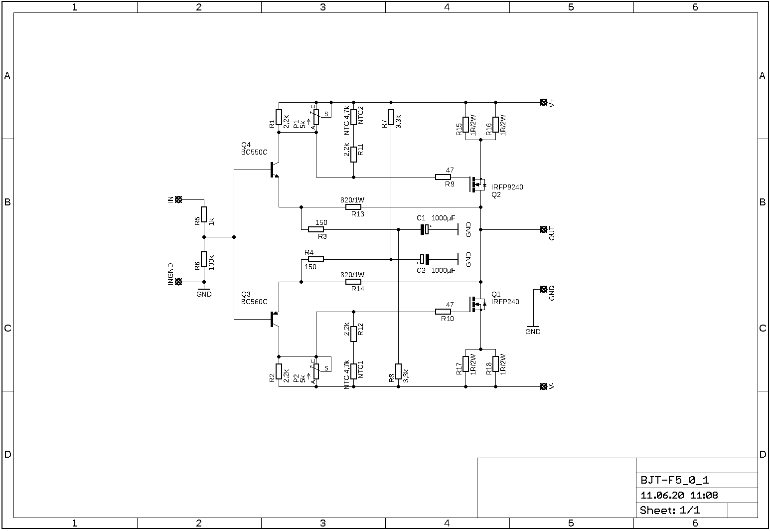

Thanks for looking Juma, attached the schematic with values as used. Only difference that I haven't incorporated are the input network values (51k/249 ohm), and a few small values such as gate stoppers (56 ohm). The key front end parts are almost identical to your original schematic in the first post, except the feedback network. The 150 ohm resistors are 3W, and the 22 ohm and 2.7k resistors are 1/2w. The 2K is a 1W Holco, because I had them on hand.
Basically now that I've drawn it I see the two B-E voltages are superimposed across the 150 ohm resistors, the series combination is in parallel to the B-E junctions. 1.2V across 300 ohm is almost exactly the 4mA that I am seeing on the meters. The max resistance I can set using the pot is 1.15k, if I remove the 2K resistor I can probably get this to approx 2.4k. Would you say it's worth a shot? This should yield 7.5V of bias with the same 3mA, which should be sufficient. However I don't know if it sufficient to properly drive the output device.
Or, do I need to revise the feedback network values again (please don't say yes, those Dales are very pricey!!) or can I get away with increasing the bias in the FE?

The values I gave were calculted for +/-24V psu and you have less than +/-20V ... Also, lower resistance in the feedback network will draw more current. Combine those two factors and you have a problem.
With Vgs of output MOSFETS being only 3.5V it's obvious that you need more current through the input stage so decrease R14/15 from 2k7 to 2k2 or 1k8 and see what you get (don't change the feedback network values, just increase the current through the input stage).
Also, with 22R in feedback, C1 and C2 should be 4700uF if you want good bass response.
If you want to have 51k at the input your BJTs will have to be nicely matched or you'll have substantial DC offset at the input (which is not important if you use input cap).

Thanks for the insights, will try to increase the current by using 1.8k resistors. Should I also try and remove the 2K resistor in the collector circuit?
I do have some caps on order, is the rolloff still calculated in the standard 2x3.14xRxC? I was looking at some 2700uF which would yield corner frequency of 2.7Hz. However I do have some cheap and chirpy 4700uF caps in case the value is non-negotiable, maybe will need a small parallel cap for decent midrange and treble with those in the feedback net.
On the input mismatch causing offset, won't the trimmers be used to null that out anyway? Sorry if I'm missing something here. The problem is that the BC550 and BC560 we use are from different manufacturers (NOS parts are unobtanium here) so chances of a good match are non-existent. I was able to bias fine with zero offset at the output and input when the original feedback net values (4k7/249R) were used, btw. There was no issue in basic operation, sonics notwithstanding.

It's not just about frequency but also about phase response - that's why I wrote:"If you want good bass..." . Just read carefully what I wrote.I do have some caps on order, is the rolloff still calculated in the standard 2x3.14xRxC?...
Read again - I wrote:" input DC offset". The trimmers will set the output DC offset. Input DC offset can make your volume pot squeak or damage your source component.On the input mismatch causing offset, won't the trimmers be used to null that out anyway? Sorry if I'm missing something here.
You are sweating it too much. Just change those two resistors.The problem is.... I shall also try ...

This worked out very nicely indeed. I put a set of 3.3k resistors in parallel with the existing 2.7k, and changed the feedback caps to 4700uF. Also used a small 100nF film cap in parallel as the big caps are not very good. The input pair gets warm but still in the early 50s. No input offset either, so guess I was lucky!
Biases up really well and sounds great, still trying to find the limits of my heatsink and power supply so I have them running slightly underbiased. I don't have the original F5 on hand to compare but this sounds just as good as my memory of that amp.

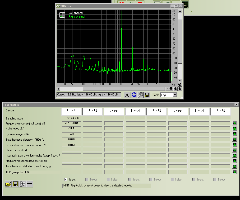

I find there is absolutely silent output even with ear to the cone and 90-92dB speakers. I don't know why this is so, I was expecting some HF ripple, but there is none at all. Of course since the SMPS are regulated there is no sag in PSU voltage even at full bias. My total power supply capacitance is 3,000uF per rail. No problem with bass though, it's nice and solid. Using with Zaph Audio L18 standmounts as their long-term partner.
I have a problem with output devices after one blew and the substitutions do not work correctly, so am waiting for some new matched devices to come in at the end of June. Before that though it sounded great.
What I will do is attach a picture of the test results, which look a lot better than the amp itself! I guess I may have been slightly clipping the input, because I was able later to get the H2 down to about -85dB and vanishing traces later. Ignore the bumps in the lower frequency, that is due to ground loop because the input and output are connected to the same physical device with no isolator. I shall update results after I get new devices and a working amp.

It doesn't matter if your amp is not in a case. I also makes prototypes and I found it useful to see how people's do prototypes with simple means. But you do what you want of course.
On my part, I thought it can be interesting to show that a 15W with 10w in class A amp can fit in a small enclosure 12" x12" ( exterior).
Thanks for sharing the distortion spectrum.
