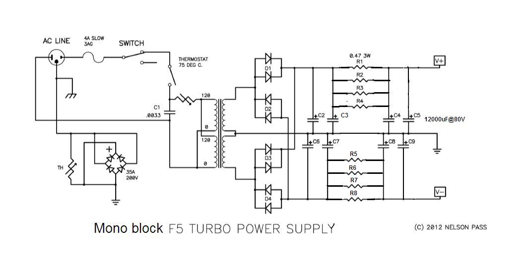

To build the power supply for a monobloc F5T V2, is it the best way to do it?

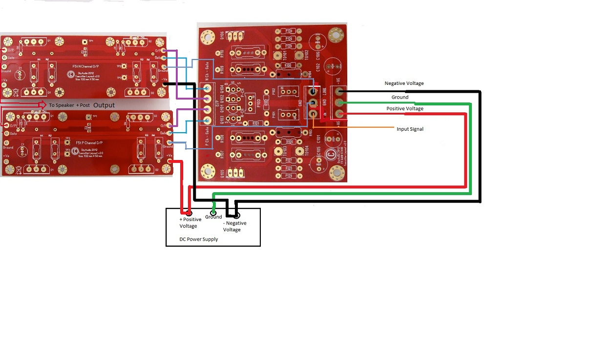

Joined 2000
Hi Everyone,
Can someone tell me if this diagram is correct or not?
My big question is how does the output sum between the N channel and P channel boards?
What is "LINK"? Looks like Ground.
All other ground best be sent to the power supply as a star ground.
Modify this diagram or please draw up another diagram.
Made in Microsoft Paint and the file is a jpeg.
Thanks,
Vince
