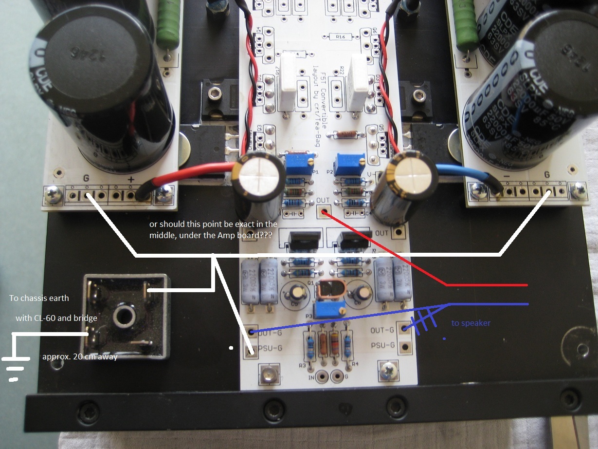

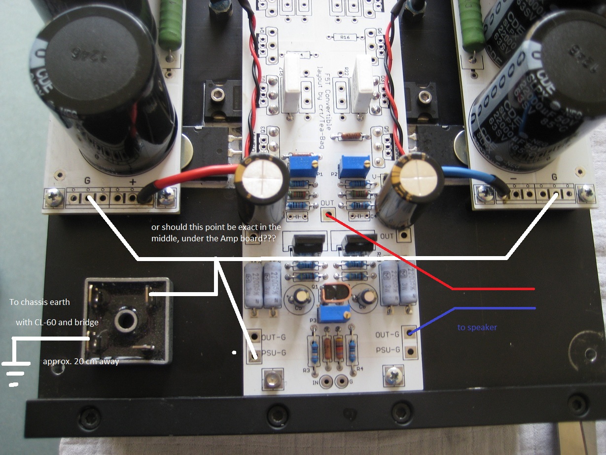

Buzz,
In this setup on your photo you did use the 'jumper' on the PSU boards, to connect the two grounds.
But in my setup with the two PSU boards separated, should I connect this 'jumper'? Or put a ground wire of each PSU board to the F5T convertible AMP board?
Because on the AMP boards there is a coppertrack on both sides connecting the two PSU-G 's. So i think I will introduce a ground loop if I connect the 'jumper' on the PSU boards also...
Are you still with me? Sorry if it is not clear...
That point becomes star ground. It is from that point that you ground the entire circuit to earth through the CL60/Bridge combo(Ground lift). What is important is that you have a central point to return all the power grounds to. The main board becomes your star ground for the signal wires. In truth, you could take signal grounds to PSU as well, but it is convenient and noise free just to take them to the boards, plus it allows for twisted pairs to the inputs and outputs.

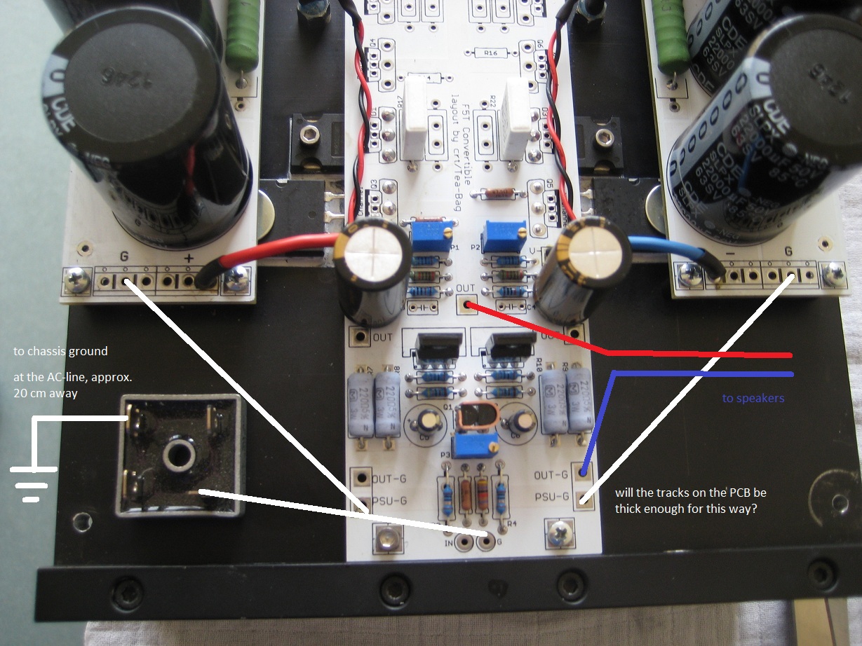

Made two pictures of what I mean. Which one is preferred?
Grounding of an Amp is always an issue... :eek:
Grzz, Walter

I don't understand what is not ideal? Should the grounds of both PSU's be closer together? What if I connect both grounds with very thick wire or copperstrips?
How do I get it ideal?
When to connect both grounds together? (Same transformer)
IMO if you have derived both channel PS from same secondaries of one transformer then you are going to get one ground loop when both inputs grounds are connected. Then you need to connect both grounds together at the output of PS. This case applies mostly for floating ground not necessarily transformer CT as ground. But ground from same transformer CT may also need this.
If its required to connect both grounds together then I suggest using thickest copper wire (at least 4X of transformer lead thickness).
When its not required?
While both channel PS are distinct, I mean two transformers or different secondaries, then its not required. Here both grounds are separate. It does not matter if they are connected together. While connecting both of these (floating?) grounds one must use ground isolaters to keep them distinct.

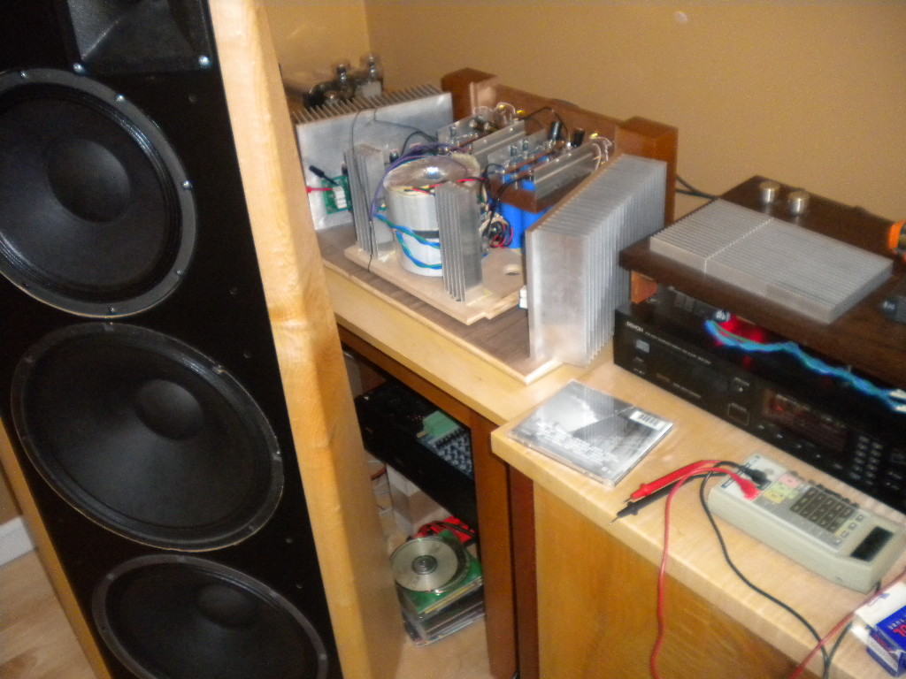

OK so I didn't build it , but thanks to the extreme generosity of a fellow member I have been listening to this for a few hours. Fairchild outputs. I simply put the boards in place of my f5 boards, set the bias and sat back to listen. WOW... At first I had the bias set very conservatively, but at .5 amp per device this thing really sings. As the name implies it sounds like my f5 only on steroids. I will be adding the diodes to this build tomorrow and will report any difference. As it stands, after running a few hours, the output fets seem to have settled at 56c and the sinks are 48c. I attached some pics...don't laugh..
Evan
