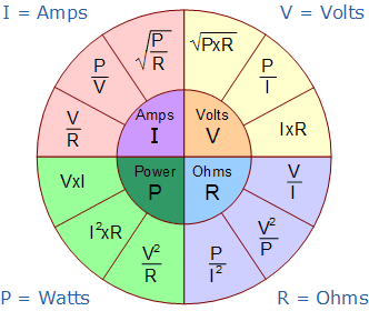

Emphasis added in your quote is mine. 1 and 2 are dictated by the fact that you chose 100W and balanced. There is only one answer for output voltage for a certain load. Calculate what you need. See chart below. Many people assume 8 ohm load. If you know your speakers are not 8 ohm, and you want to adjust for 100W at your speaker's highest, lowest, or nominal impedance, go ahead. It's DIY.
Remember that you have double the voltage swing with balanced vs. SE.
I usually assume that I'll lose ~4V from when calculating the rails from desired output voltage.
The current at maximum output power into the load (speaker impedance) you've chosen uses the same math. Iq is dictated by whether you want all of that power in Class A or not. For 100W balanced monoblocks in a typical 5U, I would not set my Iq based on the highest heatsink / device temperatures I could safely achieve, but that's just me.
The other thing you could do for fun is check out any of the First Watt amplifiers that show roughly 100W power output balanced. Many of the First Watt amplifiers use a common transformer / rail voltage. It may help verify your math.
Ask if you need more help.
