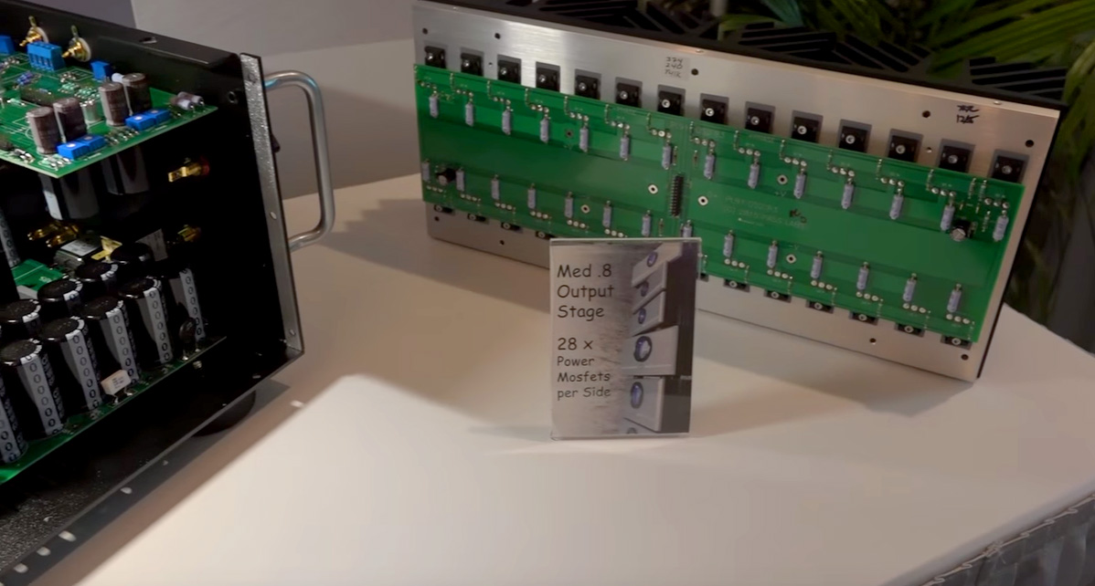

Ah, so I mount the outputs transistors to the plate and mount the plate to the sinks? Why can't I mount the outputs transistors to the sinks directly?

you would't be able to evenly distribute the heat over 3 parts of heatsinks without the baseplate as a heat spreder.

Also, since this is a DC coupled SS amp it relies on balance between the P and N transistors or you will get DC on the output. Sounds scary, but it's really not...it's common in SS amps. Temp differences effect this balance. So you want the transistors to be the same temp...thus the baseplate to spread the heat.

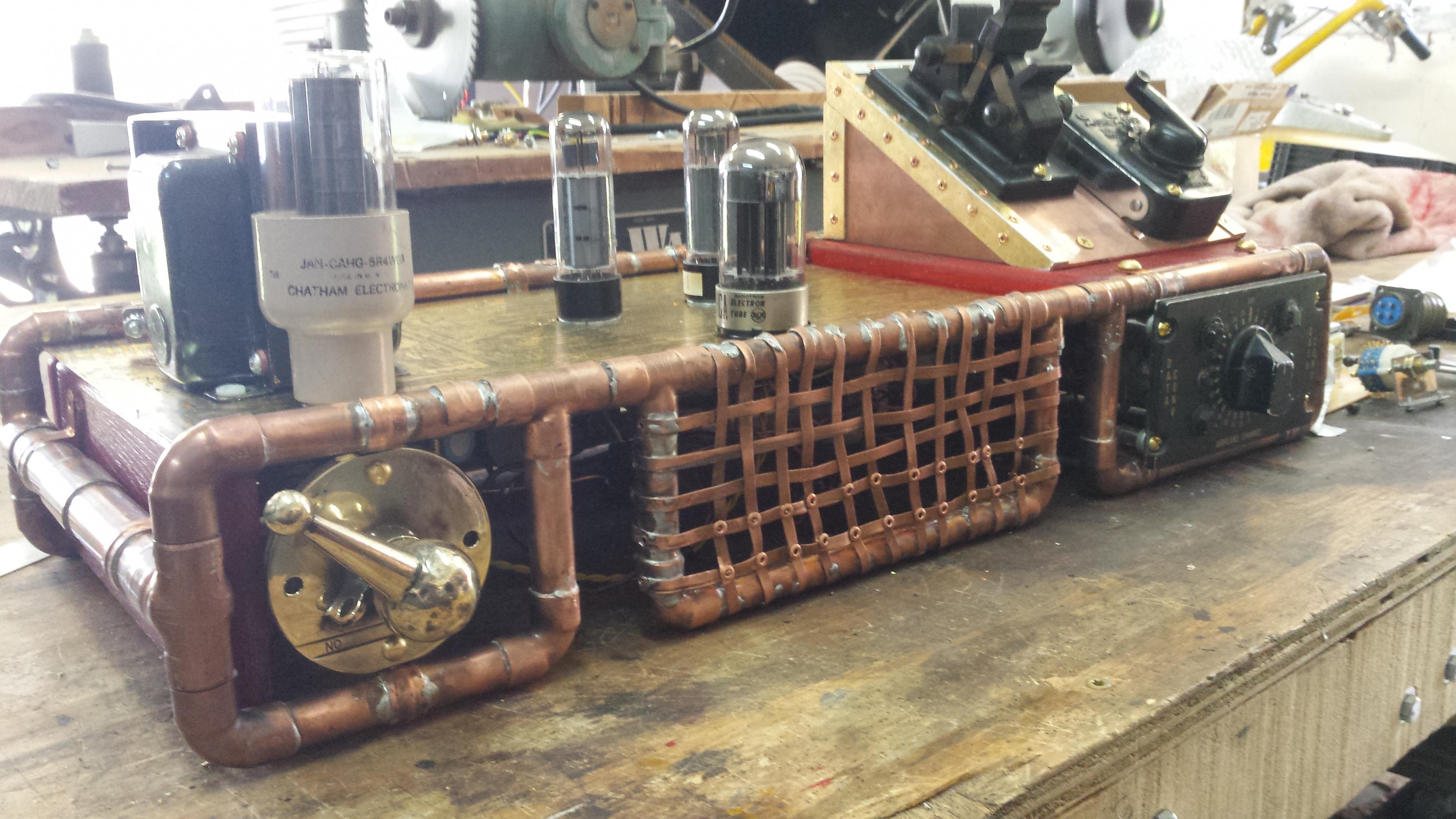

I approach audio gear as much as art as for the sound quality. Here is my pre amp. I've got some ideas about what a SS amp should look like.
Judging by this pic it looks like you are a candidate for water cooling.
