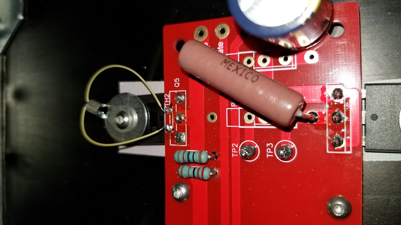

I have a problem that is not clear as to how to solve it.
I turned the unit on today with P1 P2 turned down to zero ( no smoke YAY!). P3 is set to where is was when it broke. However, all output transistors were removed checked and reused/replaced, but probably not in the same spots.
It looks like an output board does not want to pass the right amount of current. I think these are new Mosfets too. All insulators are Keratherm.
Power supply voltages measure well at the board about 38VDC.
The boards for each channel are wired in parallel.
The gate wiring is twisted together at the Front End board. Gate wiring shows continuity between both boards, ohmed out on unused PCB connections.
Since I have just started biasing, it's not at full power.
The measurements are:
DC Offset: less than 3 mV.
P Channel
Board 1 bias voltage ( with thermistor ): 35 mV Across either pair of source resistors.
Board 2 bias voltage 230 mV ( no thermistor ). Across test points
N Channel
Board 1 bias voltage about 125 mV (with thermistor) Across test points
Board 2 bias voltage 131 mV (no thermistor ) Across test points.
Clearly Board 2 P channel is doing most of the work to balance the N channel current flow.
Any help would be very appreciated. Maybe P Channel Mosfets static damage on Board 1? Guessing, as I don't know the symptoms....
