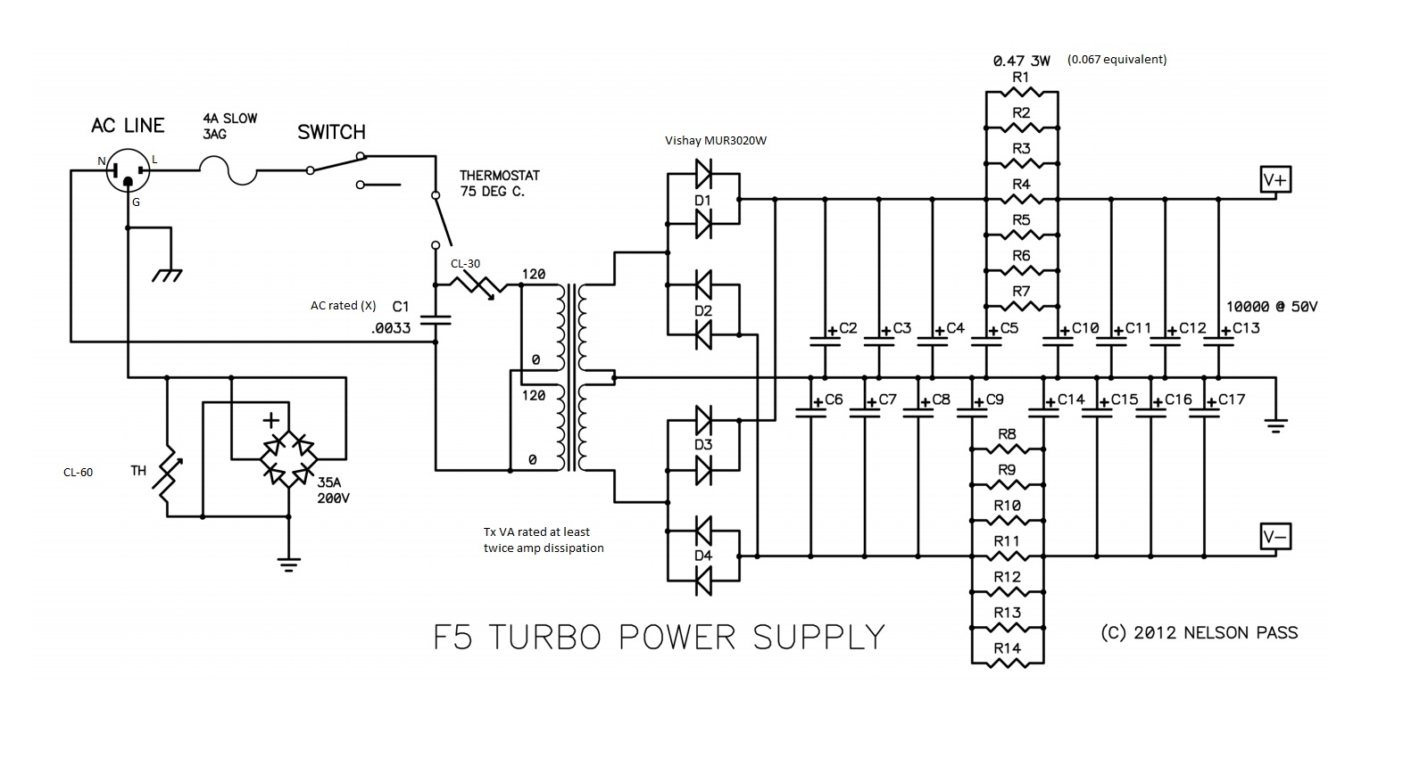

It's probably better to arrange as CRCC, to keep losses to a minimum. This is a power amp after all...
(6) 0.47 3W resistors in parallel (as in the original PSU) is roughly an 18W 0.1ohm resistor.
You could search for something like that, or just parallel a bunch of the 3W resistors, which is a lot easier.
Many thanks Gents
I now believe I have a way forward. (CRCC).
As I have some Dale .47ohm 1%, I will be using these. (would that be six or seven).
One further question ;I have some BYW 99W 200 for the rectifiers, or is it worth going the extra mile and purchase some MUR 3020WT.
I suppose I should have asked this before ordering, but what about ETU3006 rectifiers? (For both an F5 and an F3.)
http://www.mouser.com/ds/2/427/vs-etu3006m3-250141.pdf
The Vf is a bit high (1.4V), but that won't sink me, will it?
look at the datasheet again.
Fig 1 shows the typical Vf vs Ia for three temperatures.
@1.4Vf the diode is passing between 30A and 60A
@0.7Vf the diode is passing <5A
It is little different to many other Power Diodes.

sorry, maybe and already been told here but, x F5 tube v2 that transformer I have to use; 600 w / 800w, 2x18 or 2x24 ??? thank you
everything is in article .... all you need is to read it 100 times and use some brain and one calculator
so , F5T V2 , xformer needs to be 2x24Vac (or written differently - 48VCT (48Volts with center tap))
dissipation is in range of 100W per channel , so use no less than 300VA xformer per channel ....... or 600VA if transformer is common for both channels
decent PSU is shown on page 11 in article

x F5 turbo v2, example Psu just one x the way the channels ?? thank you :D
