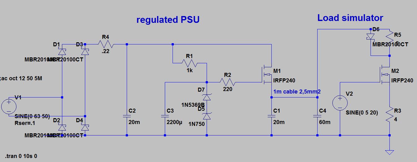

This is the regulated PSU layout:
View attachment 06_220mR_20m_reg_20m_60m_load.asc
The parts used on LTspice are not exactly the real circuit parts. LTspice do not provide all this parts.
Also the load is a simplified F5T without bias. Here you can see what happens on source resistor and diode.
Insert a 20R between rail and GND to simulate the bias .
To get a picture what is going on its good enough.
When biased to 2,4A and after 10s the regulator MOSFET sees only about 10V.
During startup only, the MOSFET has to dissipate more.
The heastsinks on the PSU are:
Fischer SK47/100 Rth 0,7

The current limit is given by the MOSFET.
Paralleling the MOSFETS should help, but not the Zener Diodes.
For better current distribution source resistors may be needed.
Another option is to use a MOSFET with lower VDSS and higher ID compared to the IRFP(9)240.

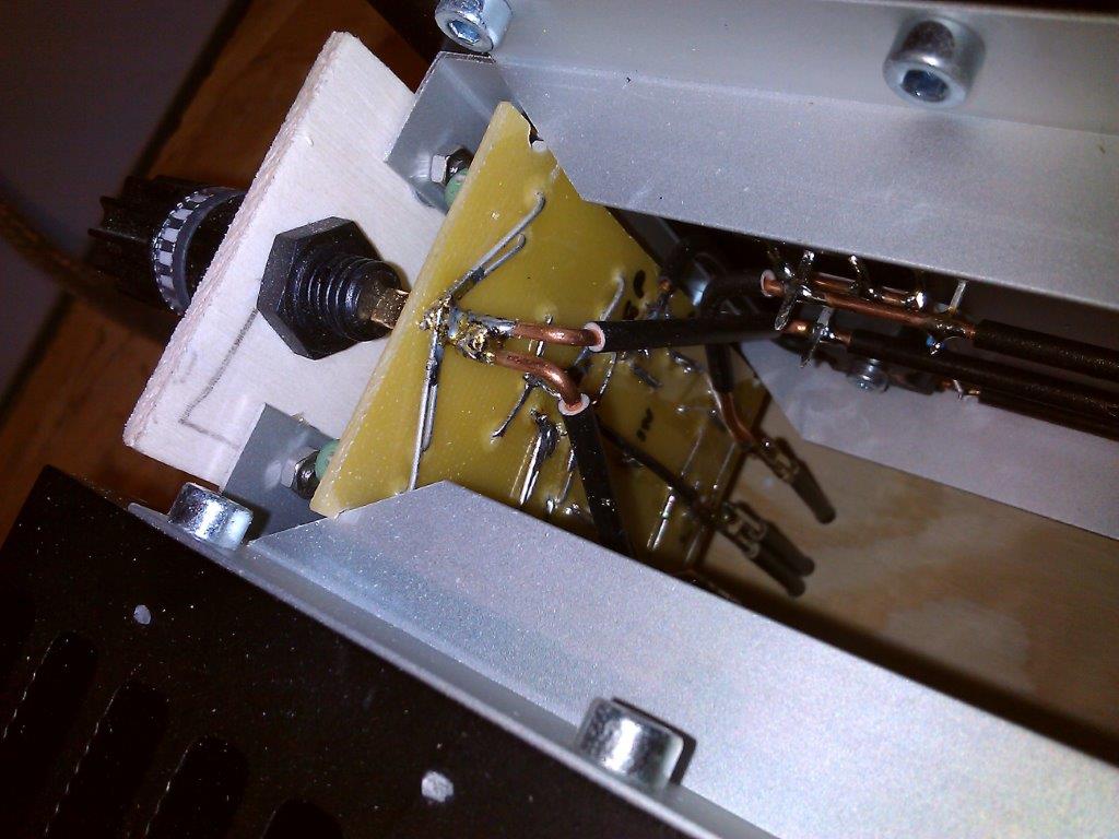

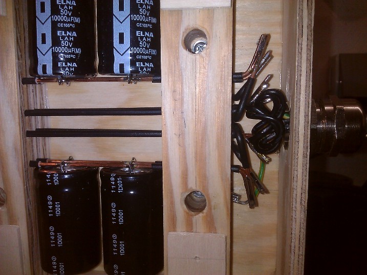

No, its solid copper wire with PVC insulation Ye2.5. Usually its used to wire buildings mains and it comes in 100m rolles.
To get straight pieces, cut about 300mm. Clamp one end and pull the other end using a comb plier. Since copper is a soft metal this pull will straighten the wire.

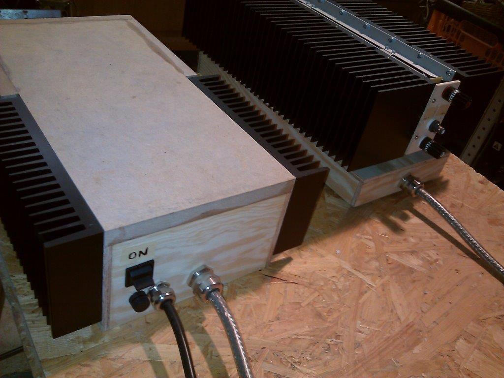

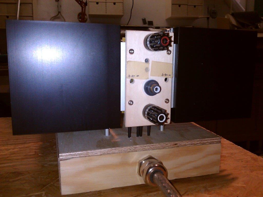

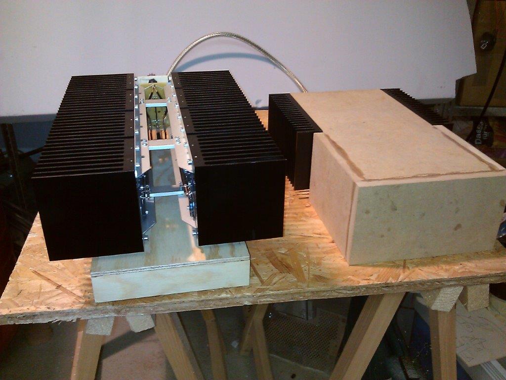

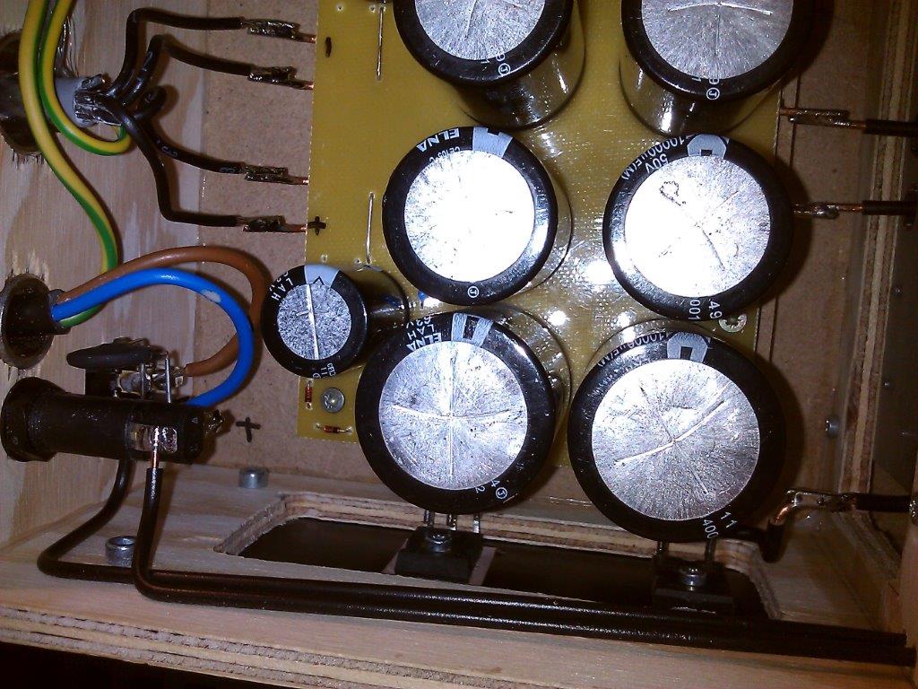

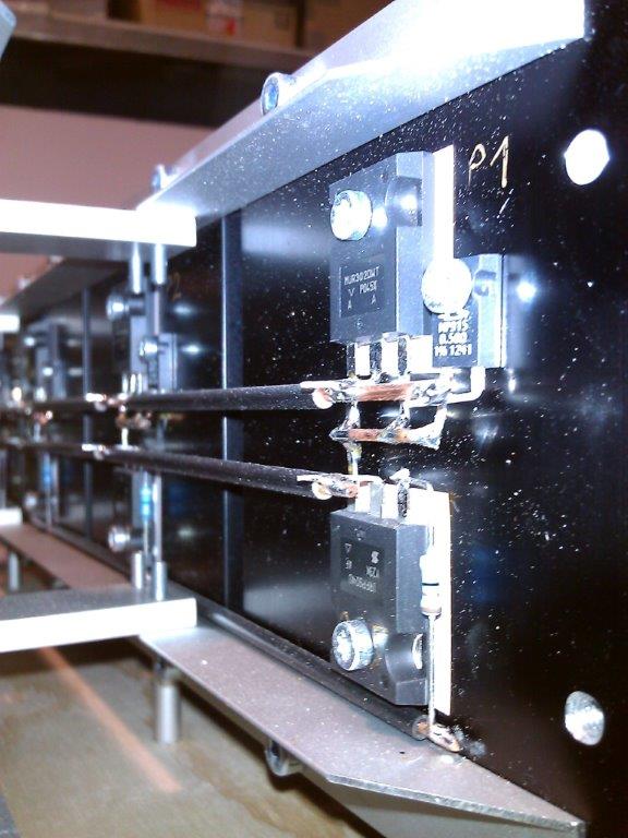

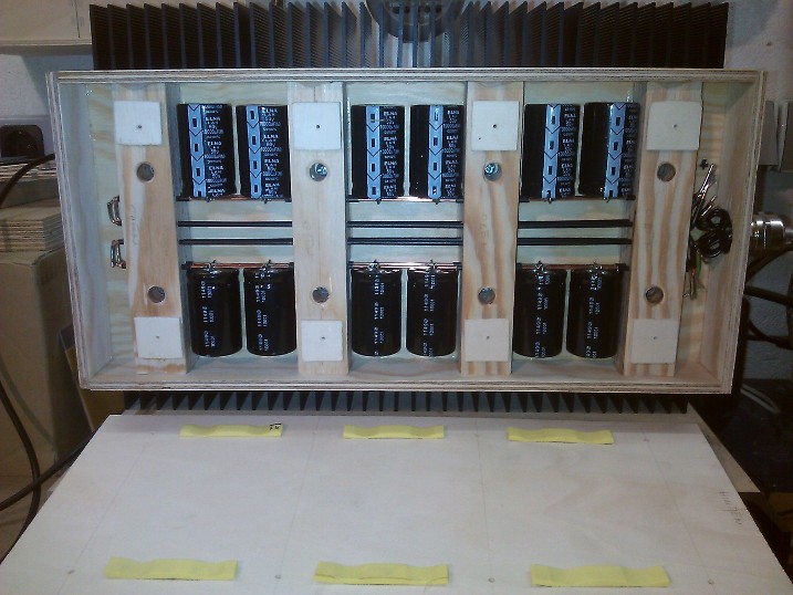

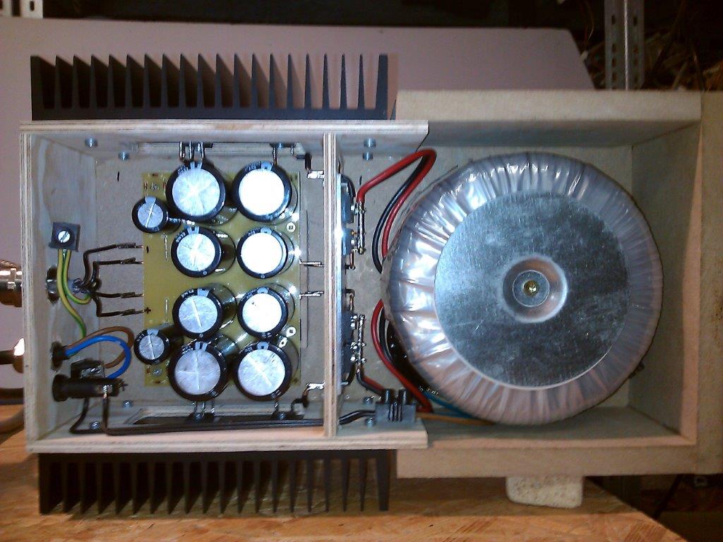

My F5TV3 project started with a wish to achieve more class A power then a standard F5 could give. A tunnel in combination with two blowers was bought to get rid of the heath. For several reasons I do not tell the readers here why I decided to quit the tunnel and replaced it with two 200x40x120 heathsinks from hifi 2000 in each channel. The PCB is placed so all 4 N and all P get their “own” 200x40x120 sink of a total of 400x40x120. Power is taken from 2x44.5V DC. This “high” power was from the beginning ment to achieve a more powerful class A F5TV3.
The problem for me now is that my goal to stay under 55 C on the sinks result in 120mV=240mA over each of the source resistors on both the N and P side. This gives me a total of 4x240mA=960mA.
With 2x44.5V DC I can have a lot of power in class AB, but what can be taken out in class A before F5TV go into class AB???
