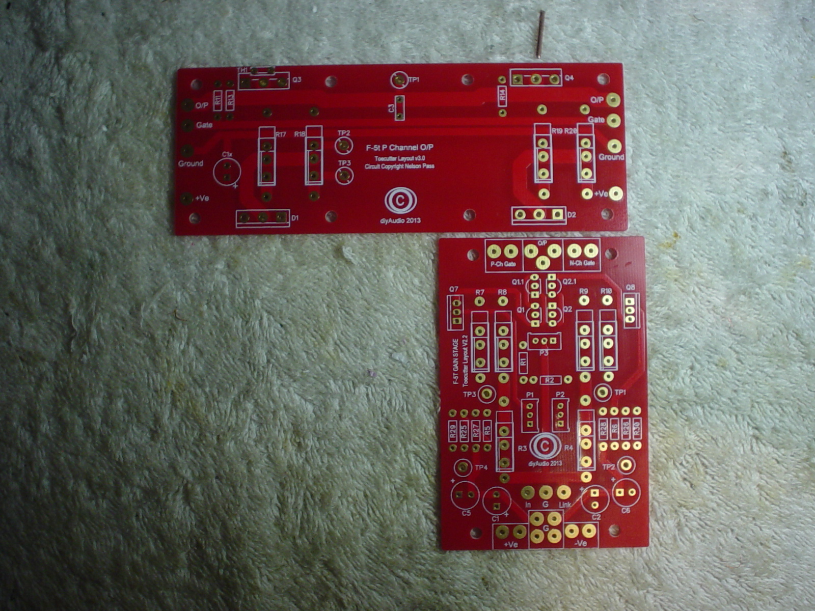

Capacitors C1 and C2 are hung across the voltage rails close to the cascode BJT for front end voltage support. The schematic doesn't show a C1x or C2x. If you have these positions on your PC board then you could just stuff more capacitance, could hurt.
C1x and C2x are on the output boards.
Interesting, I haven't seen the pcbs for front end and output seperate. My boards are one board per channel with the "front end" in the middle of the board, that's why I have no C1x and C2x. Follow your traces and see where they connect. Still if they are caps across the v rails then more is better.

Would C1x and C2x be appropriate on the second board in a daisy chain?
I too have the same question as BigE as to why C1x is there on the output board. Since these boards are new and most members are perhaps unfamiliar with them I have attached a pic. Checking continuity on the boards I can tell that C1x is between the power supply and G so it is similarly situated as on the FE board. The schematic only shows C1.
Since these are separate output boards is there need for adding more decoupling caps?
Perhaps it depends on whether one makes the V and G connections from the FE board to the output board or directly from the PSU board to the output board. If the latter then C1x should be populated is what I think to serve as decoupling.
Would appreciate if the more experienced would chime in.

I believe those are there for further decoupling of the rail supply voltage, if you need it. I guess the longer the wires are the more you may need that. But is optional.
