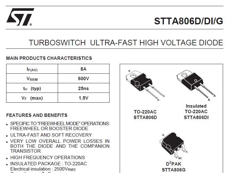

Is this diode suitable for F5 turbo ?
No, 8A not enough.
Here is a better option if you want ultra-fast.
STTH30R06CW STMicroelectronics | Mouser
But I think there are better options though. I see this one is not soft recovery.
This diode ISL9R3060P2 PDF Datasheet 30A, 600V, STEALTH? Diode have the amps you require, is soft recovery, 600V reverse voltage and is the single type. This might be just what you are looking for.

Non repetitive peak current of 325Apk.
Do you really need one of these 30A devices for each output device?
Andrew, yes, I would strongly advise it for a 50 - 100W Class A amplifier. A diode that goes short-circuit is not good for the health of the amplifier. It is not that much more in cost, and more a case of better be safe than sorry.
Put it this way, that is what I would do, and what I have done for my KSA50 clone and my bridges run cool to the touch in the KSA50.
well. when the output devices can only handle 12-20A there is no reason for the diodes to have to handle 30A.
and this is not for the bridges. it is in parallell with the source resistors.
OK, maybe audiok must qualify if referal is made to the diodes parallel to the output devices or to the actual bridges in the PSU. If audiok refers to the diodes parallel to the output devices, then yes, I agree that 30A devices are not required and that 15A devices will be sufficient.
I suspect the repetitive peak capacity of 8A diodes is sufficient for the Source of each output device.
If an ordinary F5 using single devices were going into ClassAB, the current peak will be quite big and here a 16A device may be more suitable.
But all the F5 versions that use 2pair, or more, have generally lower current going through EACH output device and it's here that the 8A diode should be sufficient.
The peak non repetitive current of a MUR820 is 100Apk. A pair of these offer 200Apk output when used with a 2pair F5.
A 3pair F5 will have a non repetitive 300Apk capability using 8A diodes.
This is far in excess of what the mosFETs can pass.
