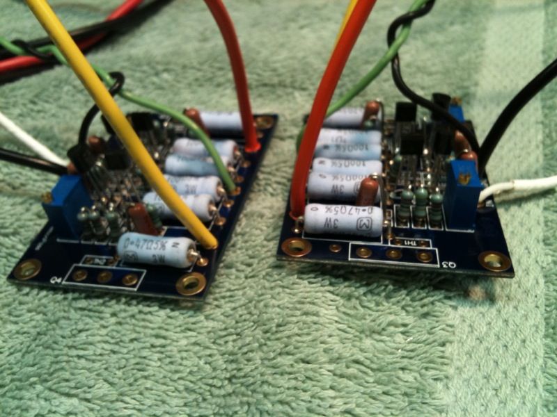

Let me try again, that wasn,t right. Check to see that you can adjust the voltage across R3 and R4 from zero to 5v with the trim pots.
That works fine

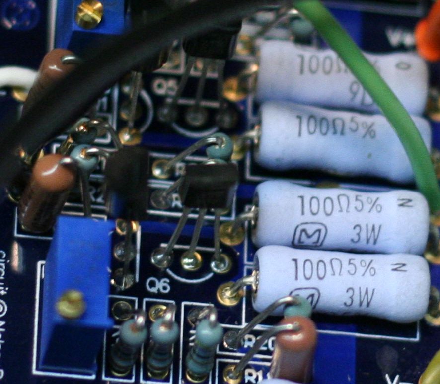

Across R3 and R4. Do you have the schematic? That should be the same voltage you get from the rail to the gate pin of the output fet, which is pin 1. Dont put the fets in until you have this under control.
If Pin 1 is next to the Q3 designation and opposite the Q4 designation, then I have 5v there when I have 5v across r3/r4.
hmmmmm
Looks like I've mixed up the data sheets, had the n channel and p channel mixed up. Dang I hate it when I do that.
I've swapped them but I have the same results.
Q3 is now a Toshiba 2SJ201 P channel, replacing the indicated IRF9240 P Channel
Q4 is now a Toshiba 2SK1530 N Channel, replacing an IRF240 N Channel
I guess I've blown an expensive pair of Toshiba outputs?
