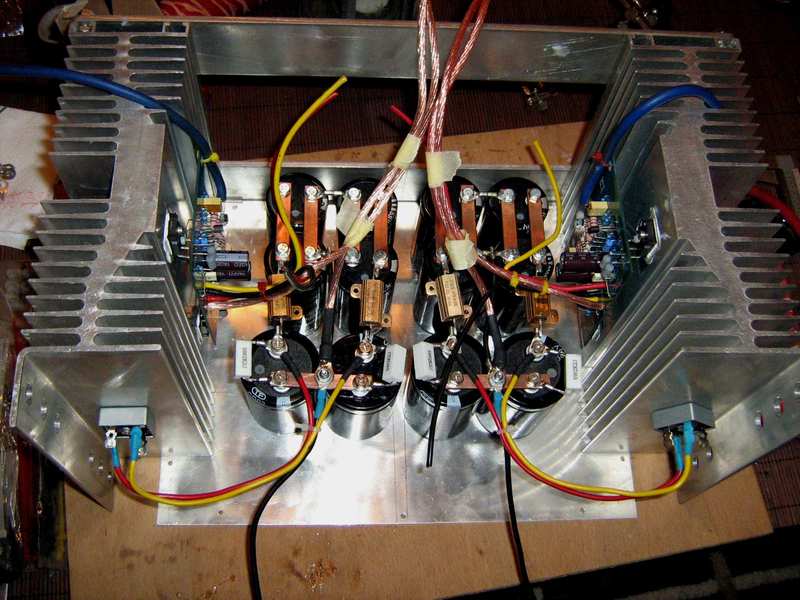

I think these are the first DIY pcbs from Serbia. Should be heatsinked and started in a few days, as soon as I sort the transformer...
(click on the link should open the images) The PCB design was done by DIYAF member, Borko KA, thanks to Papa.
and a detail at input... An externally hosted image should be here but it was not working when we last tested it.
An externally hosted image should be here but it was not working when we last tested it.and a detail at input...An externally hosted image should be here but it was not working when we last tested it.
(btw. - it's certainly better when input jfets are kissing each other ....)

Choky, you forgot to say something , so I'd feel free to comment on that PCB: Ugly!

Stein,
Suggest you replace those block bridges with fast shottky diodes like the Fairchild 'stealth' ((ISL9R...), the 8ETH03, the Cree CSD... - (no Trr at all = no current spike), etc.
- all are TO220 size, so could easily fit on those "magic" h/sinks.
The improvement is quite significant.
Upgrading those WW power resistors in the C-R-C may be worth doing, too.

I know all this my dear friend, and I would be delighted to replace the aforementioned parts with whatever you send me
Getting something other than this requires ordering parts in advance at least a month earlier and as I'm in the process of looking for the right amp for my ESLs it is not critical. I even used the not recommended IR's IRFP9240 for starters because if I ordered them in time, I'd still have two weeks ahead of me for doin' nuthin'... As Choky, that is ZenMod, repeated many times, this is Serbia... (still far much better than in Africa)

regarding parts ....
for some - you just forgot that we discussed some other solutions (diodes ) ;
power resistors in CRC filter - it's certainly better if they have some own inductivity ....... so - unless you use real chokes , you can't find better ones than you already have
