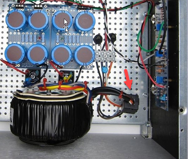

What is this?
Appropriate any help in clarifying the purpose of what the red arrow is pointing to. And any direction on more info on it.
