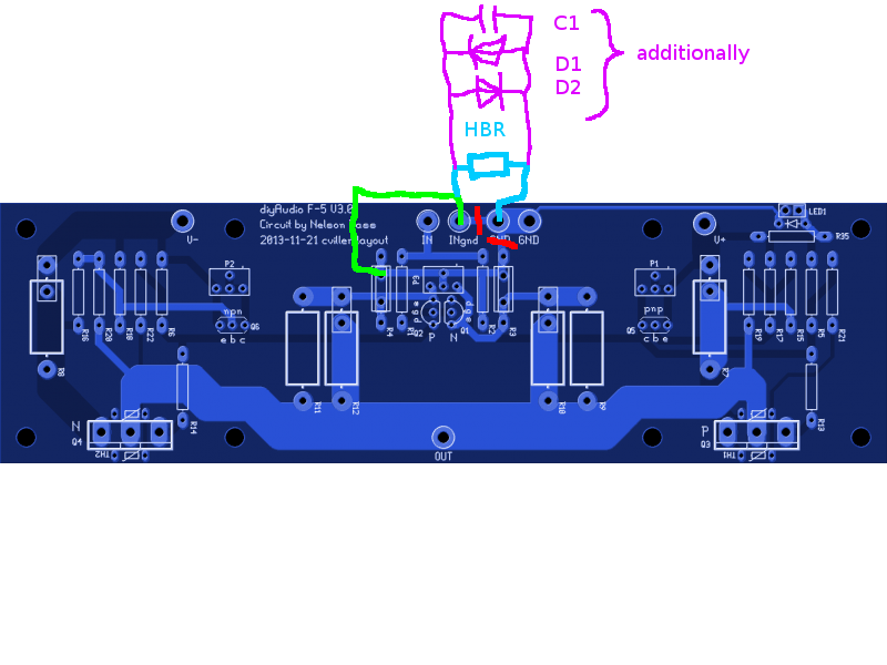

Hi all – I finished a standard F5 build consistent with 6L6’s build guide a couple weeks ago. All looks pretty good – voltages are good, both channels biased without a sweat, and sounds great overall, but after much research I think I have a cross channel ground loop. Apologies for the length of this post, but I’m trying to explain as thoroughly as I can. Here’s where I am:

Under the following circumstances, the amplifier is dead quiet when connected to 88db sensitive speakers (measured with ear and scope):
  • Inputs shorted and/or empty
  • One input connected to preamp / one input empty and/or shorted
When I connect both inputs to a preamp, a 60hz hum kicks in (measured with scope) that’s audible about six inches from the speakers. This hum is persistent across:
  • Two different preamps (one with an earth ground pin the other running off a two prong wall wart);
  • A passive stepped attenuator;
  • When cheater plugs are applied to F5 or earthed preamp (a very quick test I assure you).
This behavior makes me believe that it’s a cross channel ground loop as described very succinctly on slide 14-15 in this version of Andrew Russell’s discussion of hum/noise in amplifiers (link).
Reading this and D.Joffe’s paper on ground loops (link) leads me to believe that hum breaking resistors (HBRs) on the F5 could be a remedy to this issue.
The most comprehensive description of how to implement HBRs on the v.3 F5 boards appears to be in post #15333 of this thread (link), specifically following the modifications explained in this picture, which includes cutting the ground trace at the two red lines.
589544d1483471768-f5-power-amplifier-pcb_fix-png
My issue is that I haven’t been able to find much further discussion of the utility of this modification to these boards (I have looked, but haven’t found much). Specifically, I don’t want to take a scalpel to my boards if this isn’t an effective/appropriate solution to this issue.

I guess what I’m asking is: should I cut these ground traces or are there more options I haven’t explored?

I'm with @rookakoma. Presuming you're not using a dual mono power supply you have a big 'C' from the left input ground to the left channel board to the capacitor bank ground to the right channel board to the right input ground.
If your pre-amp also doesn't have a dual mono supply, then it will connect the left channel ground and the right channel ground through its PSU. That forms a loop. Your transformer is inside that loop.
You can test this theory by cutting one of the capacitor-bank-to-channel ground wires and replacing it with a longer wire that runs alongside the other channel ground wire, continuing along the back panel and then to the channel whose ground was cut. That will reduce the area inside the loop (and more importantly remove the transformer from it).

Yeah, I see that now. Instead of cutting a wire, couldn't you just move the preamp in front of the power amp and run the phono cables separate on each side?
Wow — that was easy — you guys nailed it on the transformer being in the loop. Tested with the preamp routed to the front and noticed a huge immediate difference. Rerouted one of the F5 signal grounds to avoid making a loop with the transformer as a more durable solution. Noticeably quieter in all configurations. One channel a little louder than the other, but the quiet channel requires an ear pretty much directly on the speaker to hear anything. I’ll mess around a bit more trying to get both channels equal (they were equal when the pre was in front), but this is pretty close for a newb like me.
