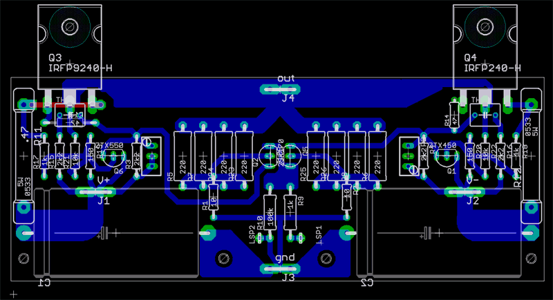

Should the PCB have decoupling caps for the power rails?
I do not see them in the schematic, nor on pictures of the F5.
...my board so far, could not go for NP's long, thin boards as my sinks are 20cm width, but I can get it in custom heights, I think about 35 to 40cm high should be high enough.
Nordic said:Should the PCB have decoupling caps for the power rails?
Not a bad idea, it does improve the square wave if your PS doesn't
have a low enough impedance up a 1 MHz or so.
Nordic said:
...my board so far
What type of jfets are you using ?
udailey said:Nice catch estman. Still nice looking layout and easy fix.
Uriah
Yes, it is nice. I would make star for inp GND and then join it to the C1,J3,C2.
