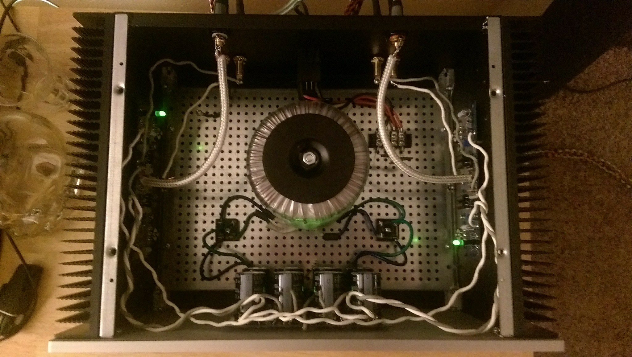

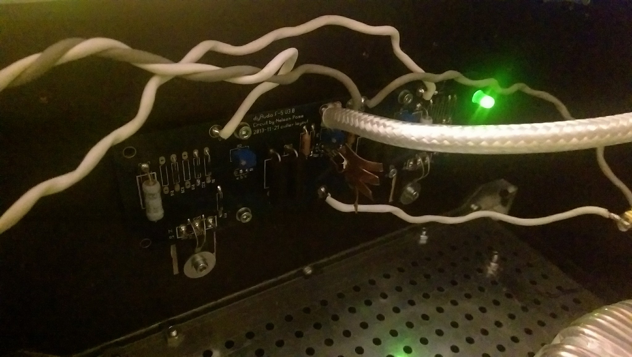

you need to slightly increase input JFet drain resistors ( in parallel with pots) , to ensure some leeway for setting
I believe that you mean that you can't move it further ..... already ending pot's travel ?
No the pots are where they need to be for .6v bias. I turned them all the way open (no resistance) and offset stayed at 170mv, then I closed them a few turns at a time to gradually bring bias to .6v, and offset never changed.
I noted from the past that closing P1 normally increases offset and closing P2 reduces it. In that way I was able to "walk" the offset to zero as the bias came up. Not now.
That's the kind of offset I was seeing when I had the BJT's in there to limit current. I was also getting about .07V through the input jacks. But since you're getting bias through the source resistors, I don't see how that could be the issue. Those are the same boards I used. Is there voltage at the input jacks? What are the actual rail voltages? What are the voltages at the BJT legs?
Thought I'd toss a couple pics of mine out there....
-22.77 +22.87 rails, zero volts at the input. Are the BJTs Q5 and Q6? Do I just check each leg with the negative lead on the ground?
Yes. Ground to leg. I seriously doubt that's the issue though given your rails are actually below spec. Mine are running at 34.5V and thats why Q5 and Q6 we're opening with the stock resistor values.
I just want to be clear I'm no seasoned pro at this. This was my first amp. I'm just tossing out stuff that I tried or would try in order to figure out what the circuit is doing. And to that effect, I'd start wondering what the voltage is doing at the JFET drain resistors.
I'm getting 4.93v across R6 and 4.94v across R5. It should be 4.2, not sure if this is indicative of a problem.
This is a completely stock F5 using the 3.0 boards. Something changed somewhere.
I understand that, but the boards you used aren't laid out and marked according to the layout shown in the original F5 article. They're laid out and marked according to the F5 diagram in the F5 Turbo article. If you stuffed the board according to the original article you've probably got resistors in the wrong places.
McQuaide, unless I am totally missing something:
The offset should reflect the difference between how "hard" Q3 is driven relative to Q4. For the picture that you showed earlier, you are getting 3 mV difference in the bias between Q3 and Q4. So, your offset should be reading 0.003 V. It looks like you are either measuring the offset from the wrong place, or as Kosst said above, that the circuit is not a stock circuit. Andy
Bingo, this is the first time I've biased it since adding the speaker protector board and I was measuring at the binding posts. Measuring at the board output yields zero offset.
This makes me wonder why the speaker protector is adding DC.
