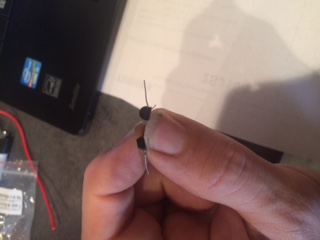

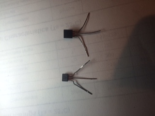

Thanks for the input guys. I have attached a pic of the two Jfets. It's hard to read numbering but the 2sk370 is on the left. I have limited knowledge and test equipment but have run another crude test which seems to confirm wrong part. Using two volt meters checking continuity across source and drain, can use lead off one meter to turn gate on/off. The 2sk370 reacts as it should....outer pins are source/drain and center pin gate. The 2sj108 it would seem source and drain are beside each other and gate is outer pin. This does jive with the N jfet (wrong part)
I think I have answered my own question/confirmed wrong part, but there is always possibility of user error!
-cheers
-cheers
I cannot see the markings at all but the part that is round on one side is *not* a
2sj108. A genuine 2sj108 is in a smaller package that is flat on both sides, like
your other transistor. (That one may well be a 2sk370).
Dennis
Thanks Dennis. That boosts my confidence that tests were correct! Frustrating learning experience, but that's part of the fun I suppose. Time to strip burnt components and start over.
