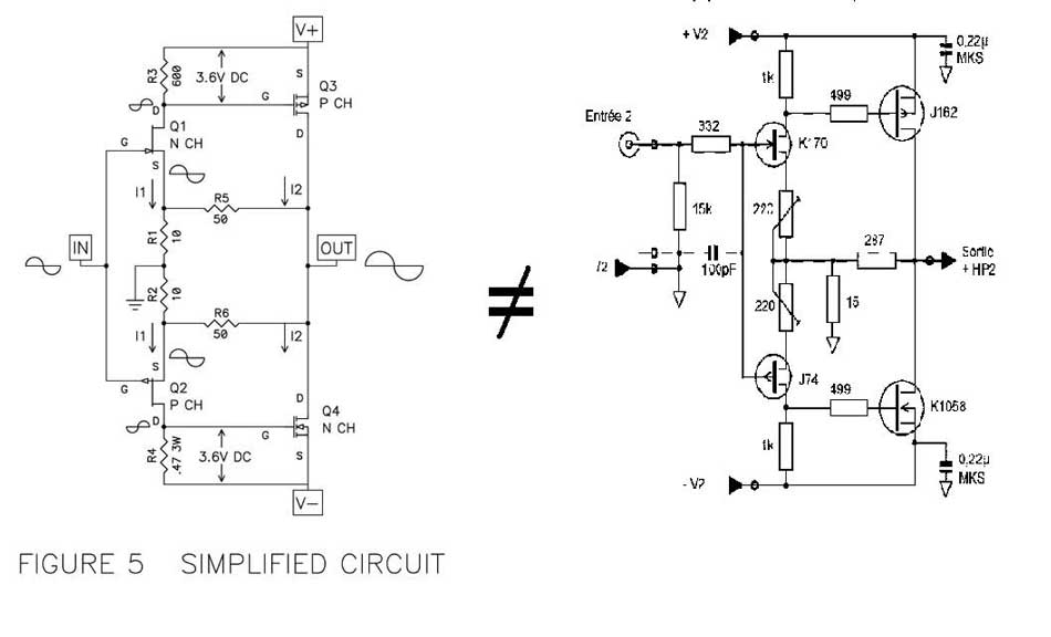

Back to the feedback network in the f5. Looking at the more triditional method on the right for the moment neglecting the
common feedback resistor. Distortion in one jfet will be injected
into the other one by the voltage developed across r15 giving
a push pull distortion signiture. So we have a pushpull front
end runing a push pull output stage.
But in the f5 the front end is operating as a pair of single devices
this is powering the push pull output stage.
Hay I could be wrong but like the girl in the song said "at least I
an't drinking"

woody said:Back to the feedback network in the f5. Looking at the more triditional method on the right for the moment neglecting the
an't drinking"
yup - that's exactly the point - in F5 each input jfet can't see and feel another one ;
they are diff amplifier , but not LTP ;
Papa probably tested each variant , and decided/implemented what's more kinky
devil is in details , we agree on that already
Zen Mod said:in F5 each input jfet can't see and feel another one
Not entirely true.
jacco vermeulen said:
Not entirely true.
lay dawn and make me 100 push -ups , ya cwayzee dutchie ;
then look at your hands , fists , whatever you use to make push-ups ( thumbs , even ) ;
is ground closer to each hand , than hand to hand ?
in any case , ground is closer than 50+50 route............... and considering that you already have big-bang where + is situated in equitation .......
I think I found (by simming my a** off) one significant reason for that specific feedback arrangement:
Compared to the conventional hookup the open loop gain can be made a little higher, all else being equal -- all DC/large-signal operating points, output loading from the feedback network (I missed this one in the last try a while back) and closed-loop gain. Now when I look at it is rather obvious, the path to GND from either source can be made "better" without increased load for the output and thus without increased dissipation in the network. Looks like the best possible way of implementing a low impedance feedback with least negative side effects.
Consequences are lower output impedance and more error feedback, producing less distortion. But the differences aren't that big, in my simulation, all within a +-5% margin (also for the various distortion profiles). When I inject a noise pulse in the MOSFET gates, there is ~30% less feedthrough at the output, and when I drop the AC open loop gain with series RC's across the I/V-resistors (R3, R4 in the simplifed circuit) to get the same open loop gain the feedtrough is the same. This seems to fit the ~2dB more loop gain I roughly figured out.
Other differences, again Nelson's arrangement looking better overall, are distortion under very heavy class-B excursion, and voltage clipping behaviour. I found the single-ended vs. push-pull considerations and their distortion consequences only a minor issue, but probably there is also something to that.
- Klaus
- Klaus

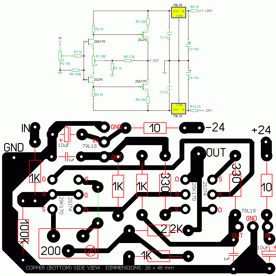

Re: PCB
Yes, but then the input FETs won't be facing each other for better thermal coupling. Jumper may be avoided by moving drain lead from input J74 through 200 R pot, but that's unelegant.
There are situations when jumper just makes more sense
estman said:Hi Juma,
you may want to turn inp. 2sj74 180deg, so we get rid of jumper
