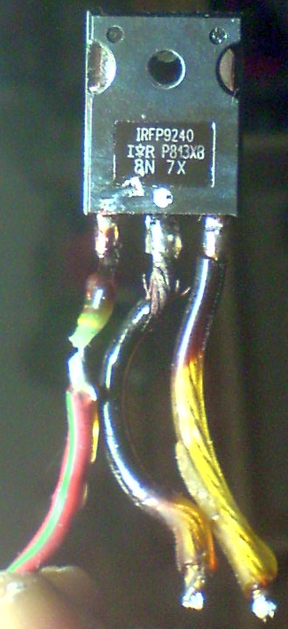

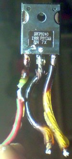

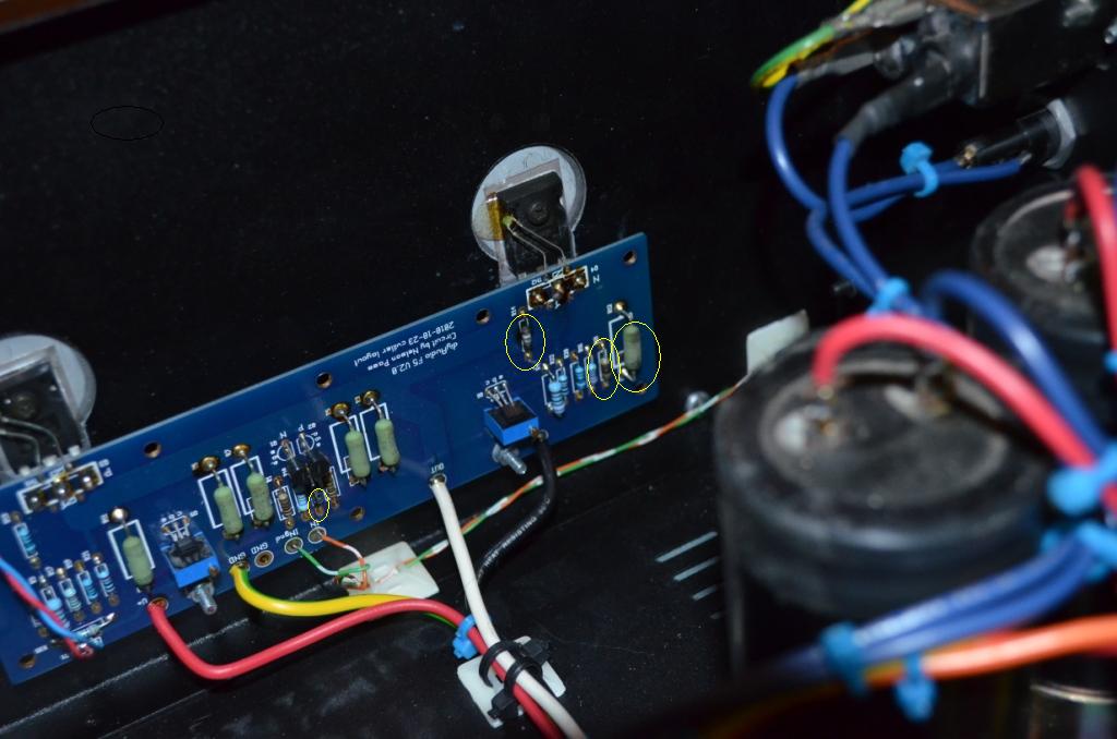

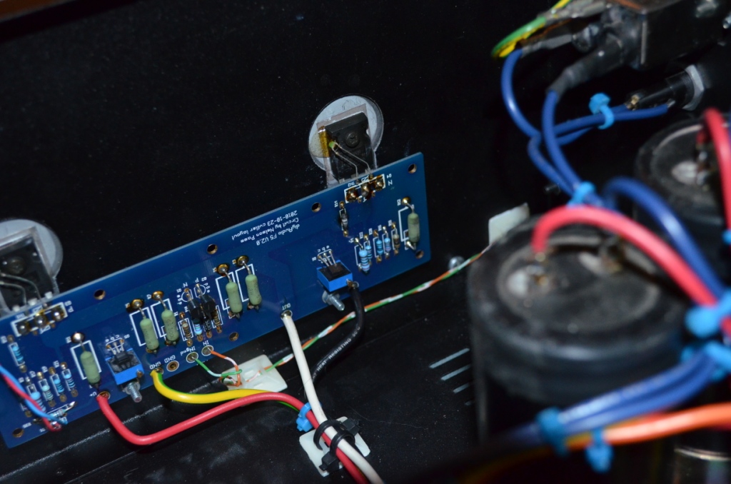

Well, after my misadventure during building and setting up something eventually failed.
If you remember I made the mistake of setting P1 and P2 to their mid positions at first turn ON.
This resulted in an initial bias of some 4A ISTR.
After correcting the mistake everything then biased up correctly and it's been happily running for about 6 hours or so.
Well, finally one of the MOS-FETs must have failed,. taking its gate stopper in the process.
Nothing else looks cooked but could something else be amiss too ?

Maybe the secondary winding of the Jensen [driving the failed MOS-FET] is open. Please ignore my reply; for a second I believed that it was an F6 instead of F5.Well, after my misadventure during building and setting up something eventually failed.

... Well, finally one of the MOS-FETs must have failed,. taking its gate stopper in the process....
Sad old story: poor thermal connection between the MOSFET and the heatsink resulting in cool heatsink and burning MOSFET.
And the story ends like this:
K&D,
you're better off by placing a pressure spreader between the mosfet and the screw/bolt head.
A plain washer works, best is a spring disc, or coins with a protruding edge (spring disc effect)
Mounting a power device with just a screw may still be acceptable for class AB (to some), but a high dissipation purpose definitely requires a washer.
