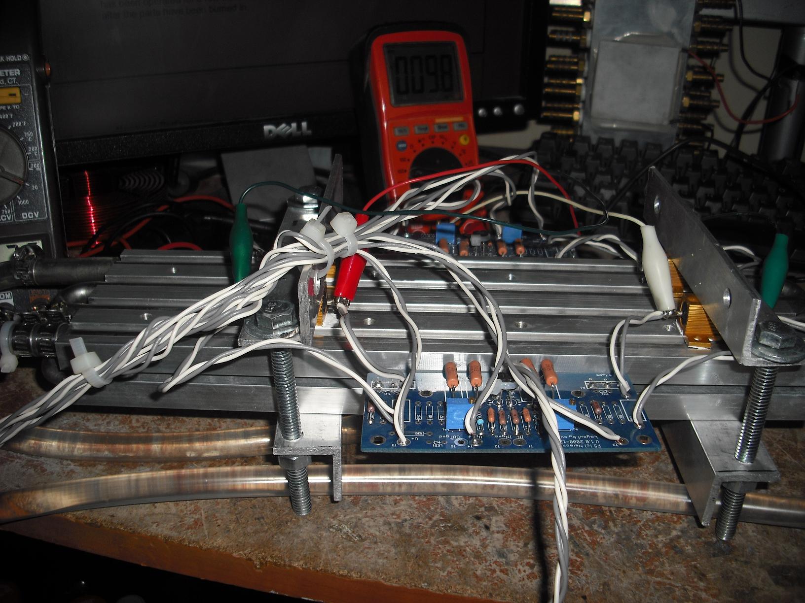

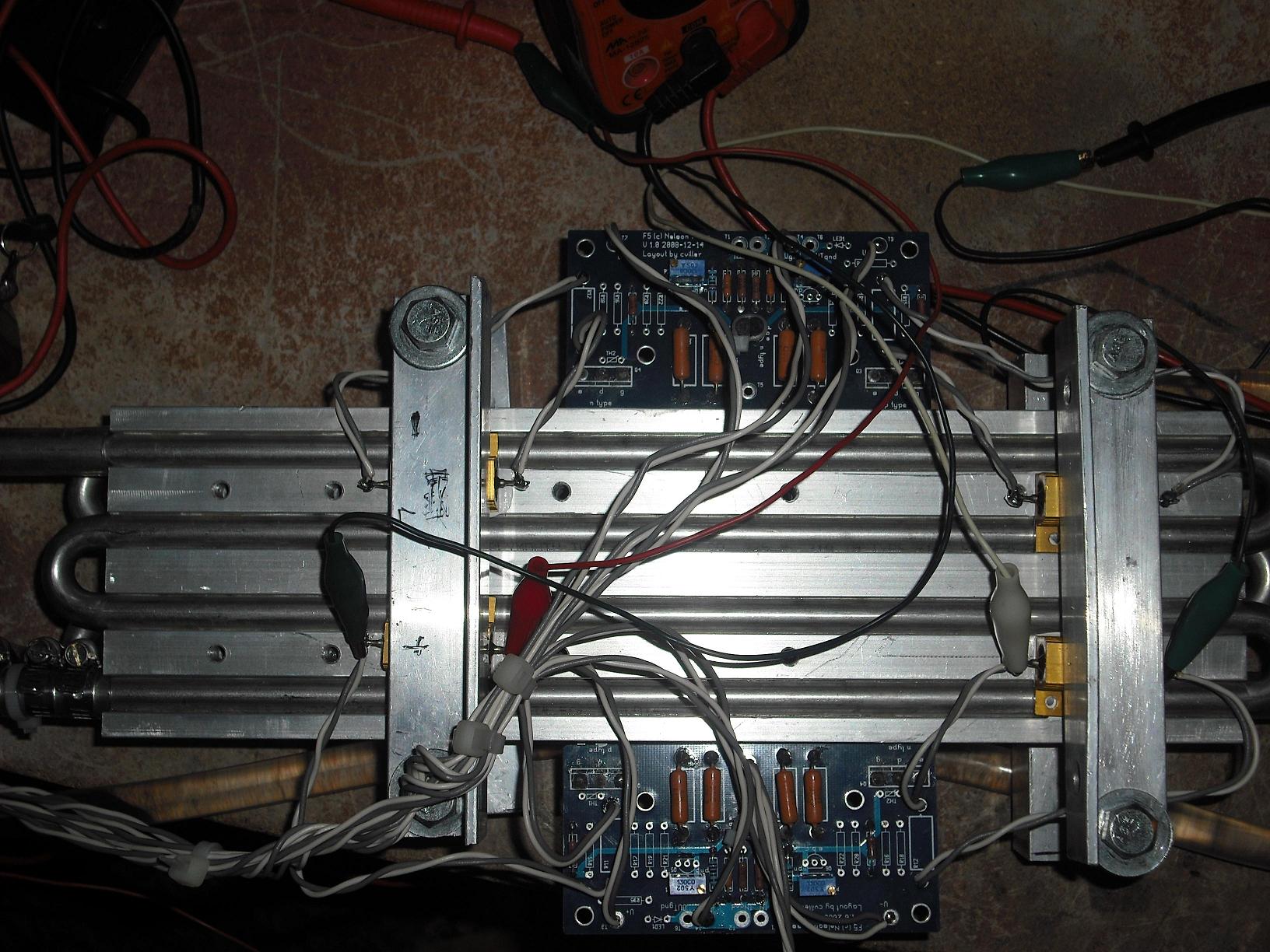

last night i took the chance of raising the bias level on my F5 monos a bit, just to hear if there is any difference. My loudspeakers are the well known DTQWT's by Troels Gravesen.
Their sensitivity is 95 dB/2.8 volts, with minimum impedance of 6 ohms, a nice load for the F5's.
I can say that the difference, with bias raised to 0,740mV (1,57A) is astonishing compared to the standard 0,590mV ! Now I really understand how high is this amp's quality.
Level of detail, soundstage and pinpoint image are on par with a triode amp (e.g. a SunAudio 300B I had the opportunity to hook to my speakers), with great bass frequencies added.
My F5's heatsinks are really huge. See here:
http://www.diyaudio.com/forums/pass...-your-diy-pass-amplifier-131.html#post3124930
With a room temperature of 20C (68F) I'm getting (measured by my multimeter's temp probe)
heatsink : 35C (95F)
mosfet case : 55C (131F)
R11/R12 surface: 75C (167F)

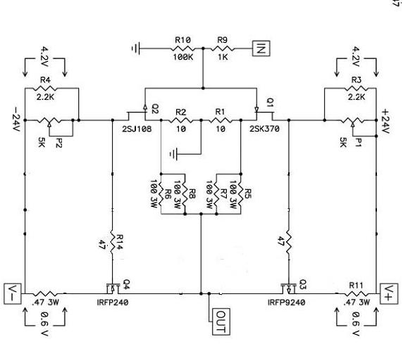

The source resistors are Mills MRA-5 (0,47ohm, 5W). I didn't install any temp controlling diode nor protection circuit (see schematic, as found some time ago on this thread).
Should I be concerned about the resistor temperature ? I can't find on the Mills' datasheet an actual suggested temperature range. Should I replace them with the MRA-12 (12W) ones ?
What bias level and temperatures can be considered to be safe ?
I'm not trying to set a 2V level of course, but I would like to keep it around 0,7V since the sound quality in my setup is really higher than the standard.
Thanks a lot in advance. Have a nice weekend

A small heatsink may help. I had to install them on the Ohmites supplied with the Tech-DIY kit - because of high ambients, my resistors were hitting close to 70 degrees surface temps too.

At the risk of sounding a "nutter", I'd suggest you block some of the fins of your heatsink with something and get your power fets body up to about 75 - 80*C, heatsink temp to "whatever *C" (this isn't at all critical except for possible internal component's temp - well within the safe operating area of the devices and the amp definitely sounds better when hotter.
Also, try cranking up the current thru the Fets to about 1.7A+ (Fet dissipation about 40W ea @23V) while you're monitoring the fet case temp - expect another improvement in the amp's sound - IMO, naturally!
As Sangram mentioned, Caddock MP930 well recomended here.
740mV across 0r47 is only 1.2W
Why are you concerned at running the resistors at ~23% of their maximum Pd?
If the tempco is high then consider using a pair of 1r0 5W in parallel rather than one big resistor.
Maybe better still use three 1r0 2W giving an effective 0r333 6W and with ~525mVrs you end up at your new 1.57A of bias.
This requires a little calculation:
The rated junction temperature of the Mosfets is 150C
The thermal resistance of the junction to case is 0.69 deg/watt
The case temperature + thermal resistance * watts cannot exceed 150C
So Watts * .69 < 95C, and Watts < 137 for the case temp = 55C
This of course is the absolute maximum. The rule of thumb is that every
10C reduction in junction temperature doubles the life of the transistor.
:cool:
:cool:
Thanks mr. Pass for taking care of my question! And thanks to everybody of course.
I'll give a try to those 30W resistors, to be completely safe
