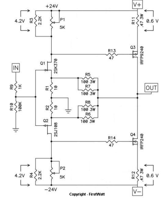

The offset is - Vdc, I'll tail the story. I completed my F5 mono block are very good work and very good sound normal. I burn in about 100 hrs go by and once I saw my speaker' cone one is sucked in I'm hurry switch off my F5, and resume SW on is not happen again till I complete listening. The day after I try again take off speaker cable and put my DC volt meter to biding post switch on F5 the DC offset is normal at the beginning once I play CD player the DC offset go up again and I off and on SW F5 is normal till I complete listening. And now DC offset is -20 Vdc all the time.
Thank You
Thanks of both expertise
Thank You
Melon Head is quite right to suggest poor joint in first instanceto start fault but now dammage is there to stay?
How hot is inside box?
Remove J fet and test them
See what came out of mosfets whit no Jfet (VGS = 0)
If this is more easy to see current protection you don't need for testing
http://www.diyaudio.com/forums/atta...r-amplifier-f5-no-tempco-no-current-limit.jpg
Many different F5 SCH during much time Q5 Q6 (is this corect?) no need.
Put picture your SCematicH here next time to make beter help.
And no more speaker connected till all work ok
Use resistor but if you don't have dont use. Test ok with no connection.
I know is late now for poor speakers look at NTE7100 data sheet
Picture beter than 1000 words
I have NTE7100 and speakers ok since a long time.
