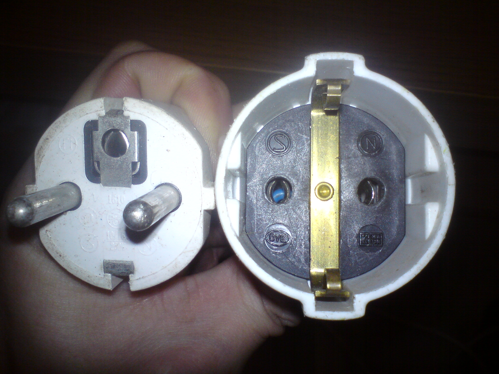

here is the typical plug
over here youcan turn the plug 180 degree and plug it back in. so no live/netrual.
It doesn't mean you don't have live/neutral. We can do it too here in France and there is indeed live / neutral. Mains is asymetric by nature, i.e. one can measure 230V between Live and Neutral, but also Live and Earth. But between Neutral and Earth you don't have anything significant in general.
Do bear in mind that the power is distributed in 3 phases (triphase) before big district xformer. Once here all loads (phases) are power-balanced against it, and Neutral is a special return path to the big xfo they assign you. So between phases you would have 380V, perhaps your neighbour has a different phase from xfo than you :) but perhaps the same. Between Phase and Neutral they give you you have the 230V ...

i would suggest getting one of the neon bulb pocket line-testers. once you've wired up the amp make sure that the switched side is the "hot".
