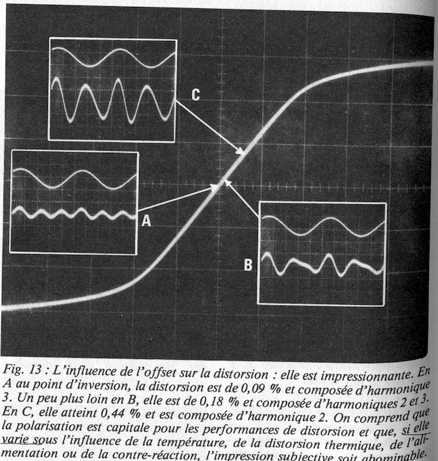

How about the third harmonic?
Because we actually like to reduce that .. . and not to the expense of the second.

The third harmonic is in-phase with signal and cannot be cancelled by a a push-pull pair. If a 3rd order term were included in the two amp chain equations, it would show up as an additive rather than subtractive term in the output. I conjecture that the odd harmonics would look something like:

So if we make the solving a bit more complicated, we could say - instead of nulling second harmonics al together - for example set that at 10 dB higher than 3rd harmonics (which is a given and can be calculated, given the measures characteristics of the devices).
The picture below shows what I think happens, this picture is from a differential pair by the way (Héphaïstos, in L'Audiophile 2/1988).
With P3 we also move the operating point a bit up or down, and are content with the trifle of added second harmonics (as long as they are in phase, being natural).
