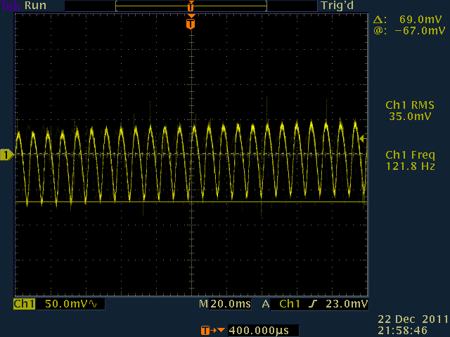

How much ripple on the PSU is accetable? I am using 36,000uF - 4 x 0.47ohm - 36,000uF, for each channel. I am using a copper plate to tie the four caps together. I'm taking the ground off two corners of the plate. What I'm seeing is more noise depending on which of these two ground points I measure from. I get 26mVAC between one of the corners and the closest cap which is the final cap on the positive rail. If I measure from the other ground point to this same cap, I get 75mVAC or so. I am getting 150mVAC or so on the first cap after the rectifier bridge. I was getting more like 1mVAC on my F4, hence the concern.

Well I don't think it's a PS issue at this point... Pulled one of the input cables out accidentally when I was troubleshooting, and the noise vanished... So, with either channel connected and the other disconnected, quiet as a church mouse, both channels connected, the buzz is back. It's not much, but enough to be noticeable with my 105dB/w horns. I don't think it can be a ground loop, even does it when connected to a battery powered JBOZ that's not connected to anything that's grounded...
Any ideas?

So, I rearranged things and am using some heavy copper wire in a U shape. I'm getting 125mVAC before the CRC and 35mVAC after. Both rails are close to the same here. What is acceptable?

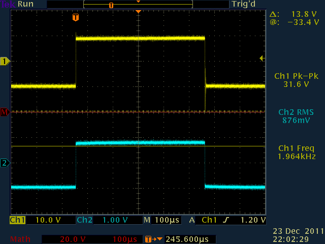

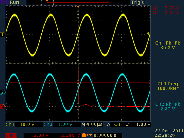

Things look great at 8 ohm load. The amp clips at 40 Vpk-pk. The square wave looks nearly perfect at this point. I'm very happy.

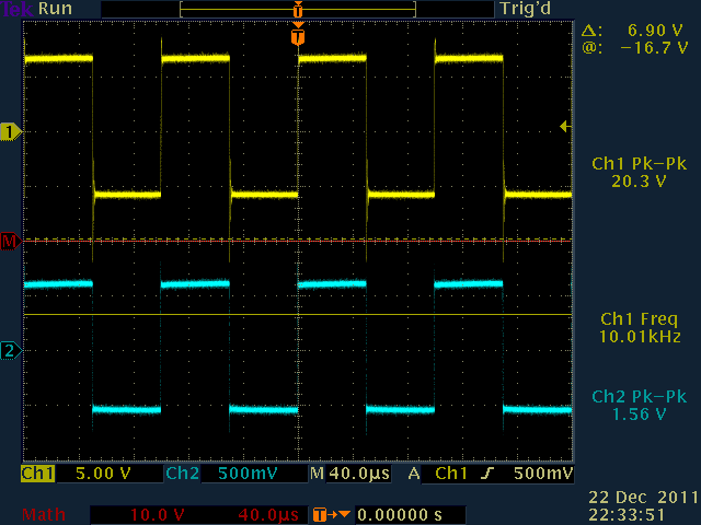

I'm also interesting in driving a pair of AKG K1000 headphones. They are 120 ohm impedance and rated at 1W maximum and are 74dB/W. So, I figure about .4W to get to 100dB. Once I get close to this (using a dummy resistor), I start to get some strange behavior on the falling edge of a square wave (see attached) and even get some nasty stuff on the sine wave output (nearly vertical lines on the bottom half of the sine wave, didn't remember to get a capture). The nastyness starts once I exceed 27 Vpk-pk. I'm thinking I probably need some sort of compensation, or way to deal with these headphones. Any recommendations? It's strange to only see on the bottom half of the waveform.
The other deal is (and related to my quoted question above) it's unclear what the noise floor of this combo will be. With no source I'm getting 35mV pk-pk noise on the output. The frequency seems to jump around, it's hard to measure. Is there a way to measure (and formula) whether or not one would hear a hum or buzz, without listening? I'd assume it would depend on the sensitivity of the speakers, and how far one was away from them and what not... but such a calculation would be useful.
The K1000s, the K701s and most of the AKG range of headphones are really best mated up with current drive o/p stage - I think, but don't really know for sure, that the problem here is related to the higher impedance load to the amp - perhaps you could drive an 8R load with your amp in the usual way and connect the headphones across that to see if the problem of distortion at 27V p-p is a function of the signal o/p exceeding your rails or just gross overload of the amp.
No doubt, a readjustment of the amps parameters could easily tailor the amp to suit the load for the 'normal' max power of the K1000 headphones.
it's the latter. If I put a 8 ohm load in parallel, the issue goes away completely.
Any idea on what to add to the output? Perhaps a 22 ohm resistor with 47nF cap in series, across the output? I'll dig through my part box and try this first.
If you just wanted to use the amp to drive your headphones, I'd suggest that you reduce the amp's bias but as this will radically alter the cct operating conditions, don't think you'll get good results that way.
