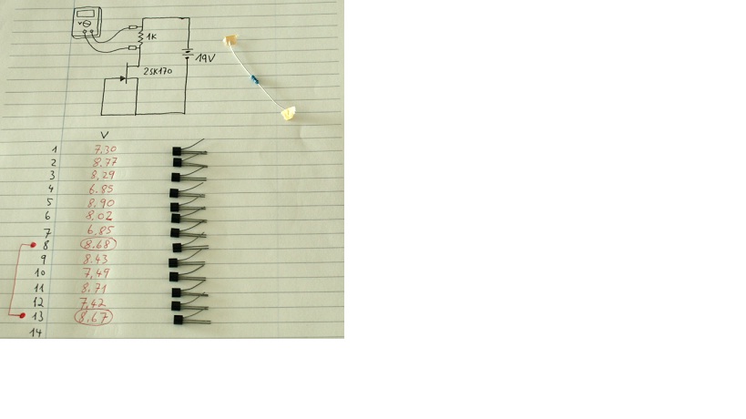

jFet Idss testing
"John Curl: I hope that Nelson has shown how to do this, BUT it is fairly easy with just a multimeter. You just short the gate to the source and add a 9V battery from the drain to the source. This gives you Idss. But how to measure? Put a 10 ohm resistor between the drain and the battery and measure across it. 0.1V=10ma and so forth. Matching Vbe is much more difficult."
The picture is from Babowana's old website

The methods described in post #11251 and #11254 are both very accurate.
The greatest contributors to inaccuracy are (in random order) :
1) Multimeter accuracy and resolution
2) Thermal drift of the JFET
3) Drift of your multimeter
To observe (2), put a low Idss JFET (say 7mA) on as described in #11251 for 5 minutes, and observe how the reading goes up and down, then breath on it, or just move your body away from the bench. If you have a 4~5 digit multimeter, you can see these effects quite clearly.
Single point methods only give you match at one point. See :

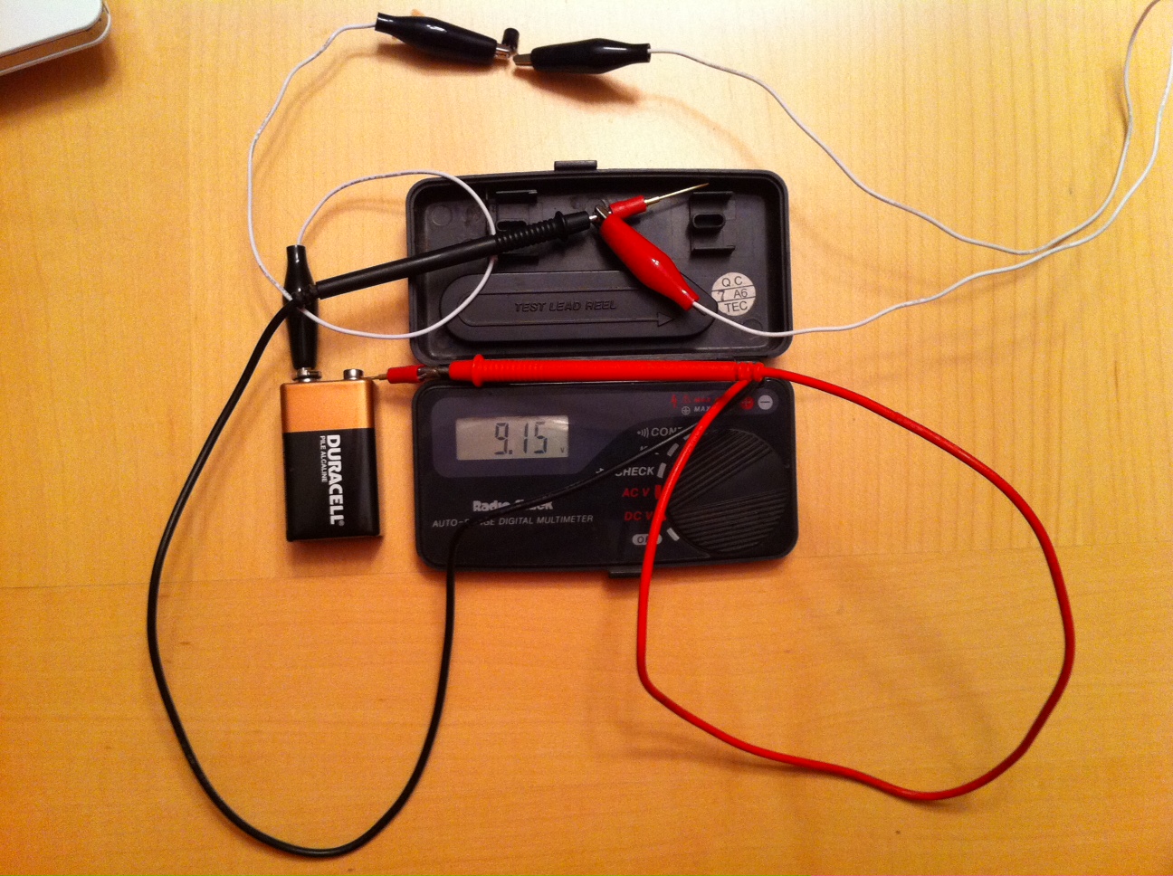

As a first, test the jFETs for Idss.
Using the method 6L6 supplied, I get 9.15 volts (new 9V batt voltage)... which I'm guessing means they are bad and I need new ones.
erpiii
