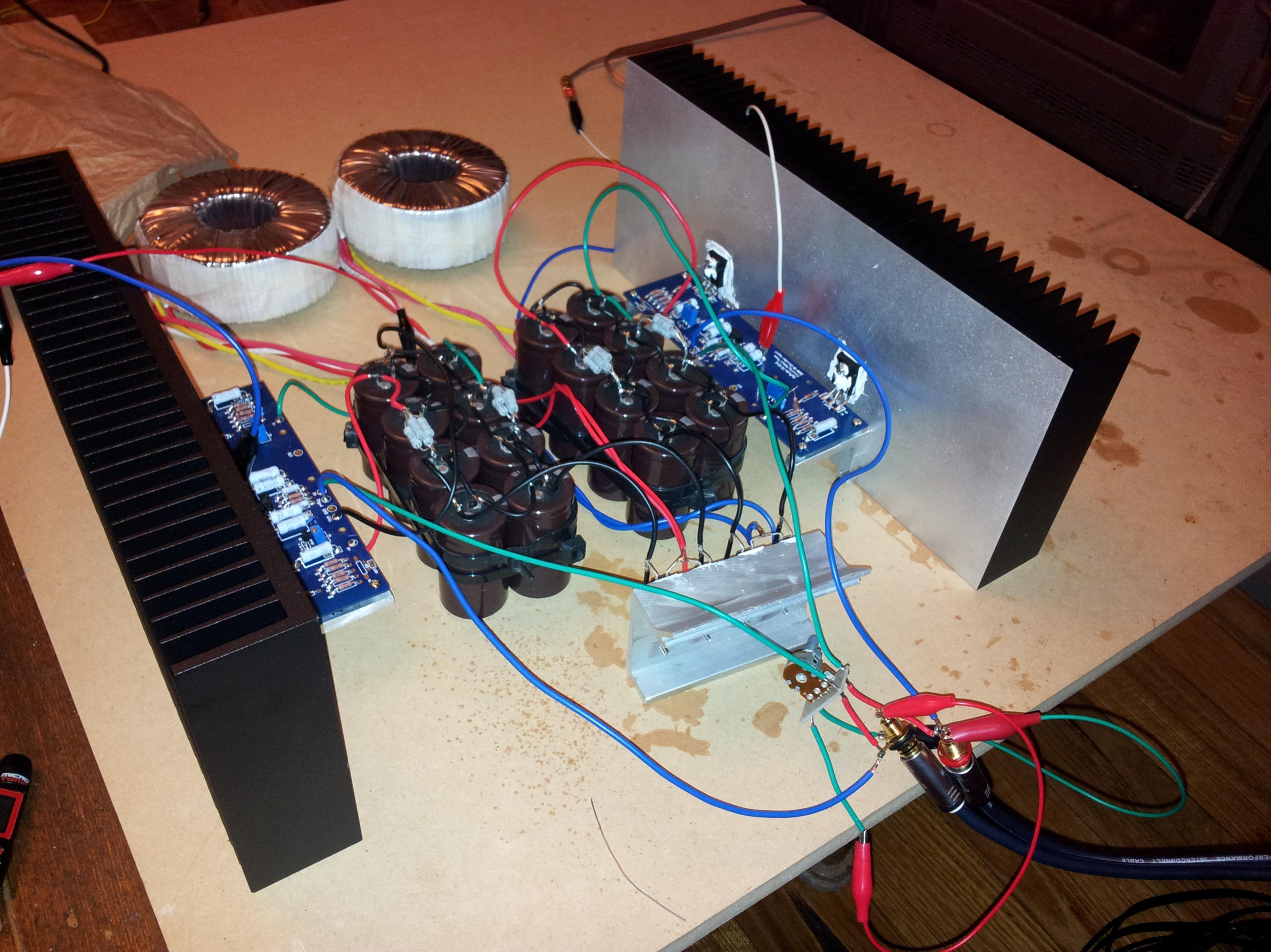

Just wanted to share my build so far.
Also would like some constructive criticism.
First impressions are very good in my system compared to my 845set. I noticed pretty much all the things other builders have described in previous posts. Highs are more detailed, bass is fast and tight. All good.

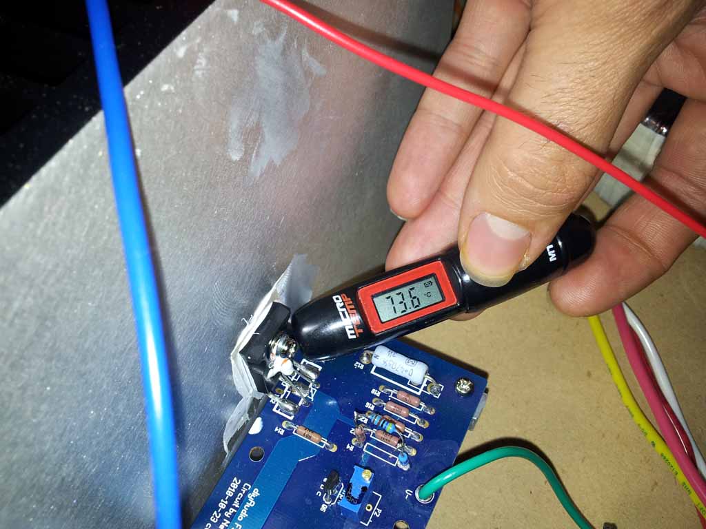

In the attached photos are the temperatures I've measured, i feel the mosfets (Fairchilds running at 1.4A) are running a bit cool due to the big heat sinks(conrad 151 x 350), as somebody told me these sound better at 100 degrees C.

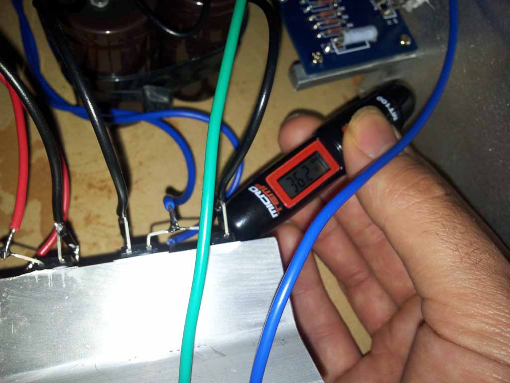

The diodes I'm using are BYV29. As you can see they are operating at 36 degrees C
Also in the photos you'll notice R4 has had the resistance increased quite a lot on one of the channels, i got up to about 9k! I know others have had to increase R4, what did they increase to? I guess its a matter of how far out the Vgs is on the p channel. Is it worth getting closer matched mosfets? Ive got some matched jfets on there way.
As you can see I'm using very standard wires. What are some examples of better wire which could be used in the various parts of the circuit? Probably invest in some shielded for input. Also layout will change once i get it into a home. Other suggestions?
This build is going to be a work in progress for some time to come. I'm really looking forward to experimenting in the power supply, different resistors, caps, etc.
What are some other parts people have changed over and noticed changes and improvements?
Any advice welcome.

Hi ryan. Your build looks good so far. What grade of jfets to you get? You might find that it is easier to get the vgs up high enough when you have higher idss jfets. Regarding the temp, I don't think you should worry about running them too cold. When you assemble the chassis, your heat sinks will lose a lot of efficiency.

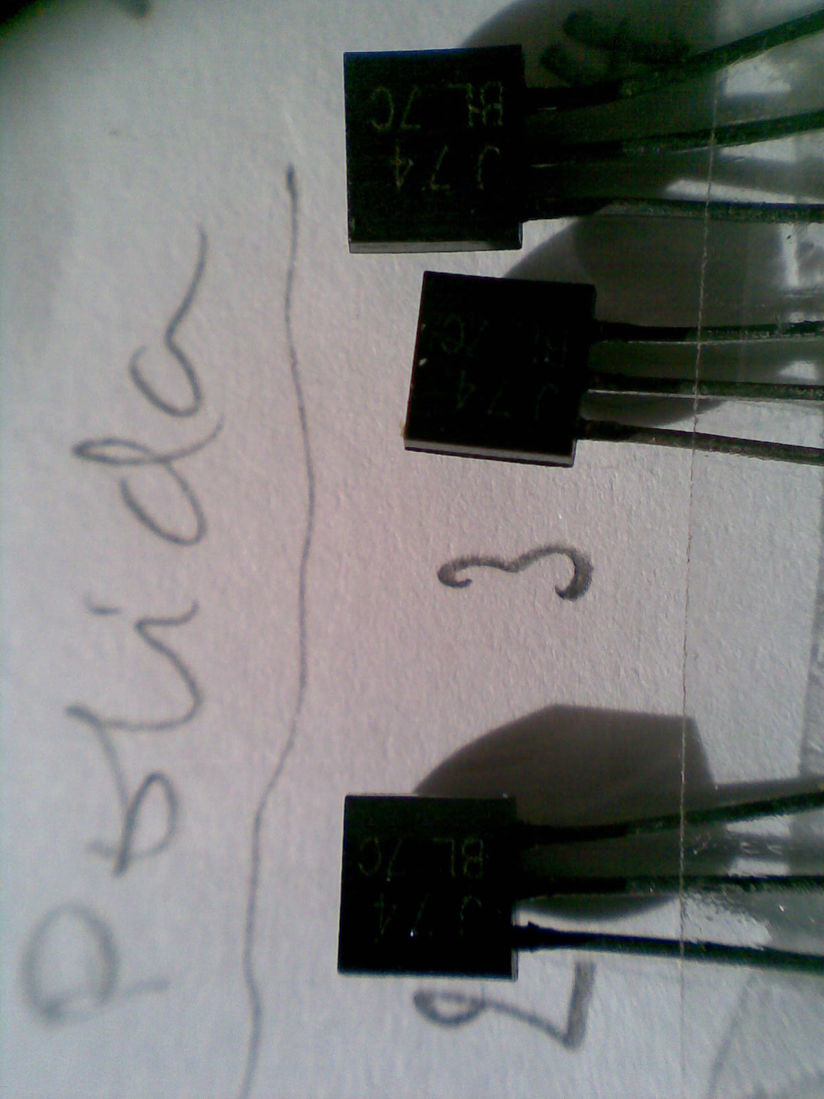

UPDATE and WARNING :cuss:
I have recieved a new batch of FETS from new supplier. These new ones are OK. I will post separately on those.
The 2SJ74's I bought from my first supplier are FAKES. That is why they do not match the 2SK170's in any way.

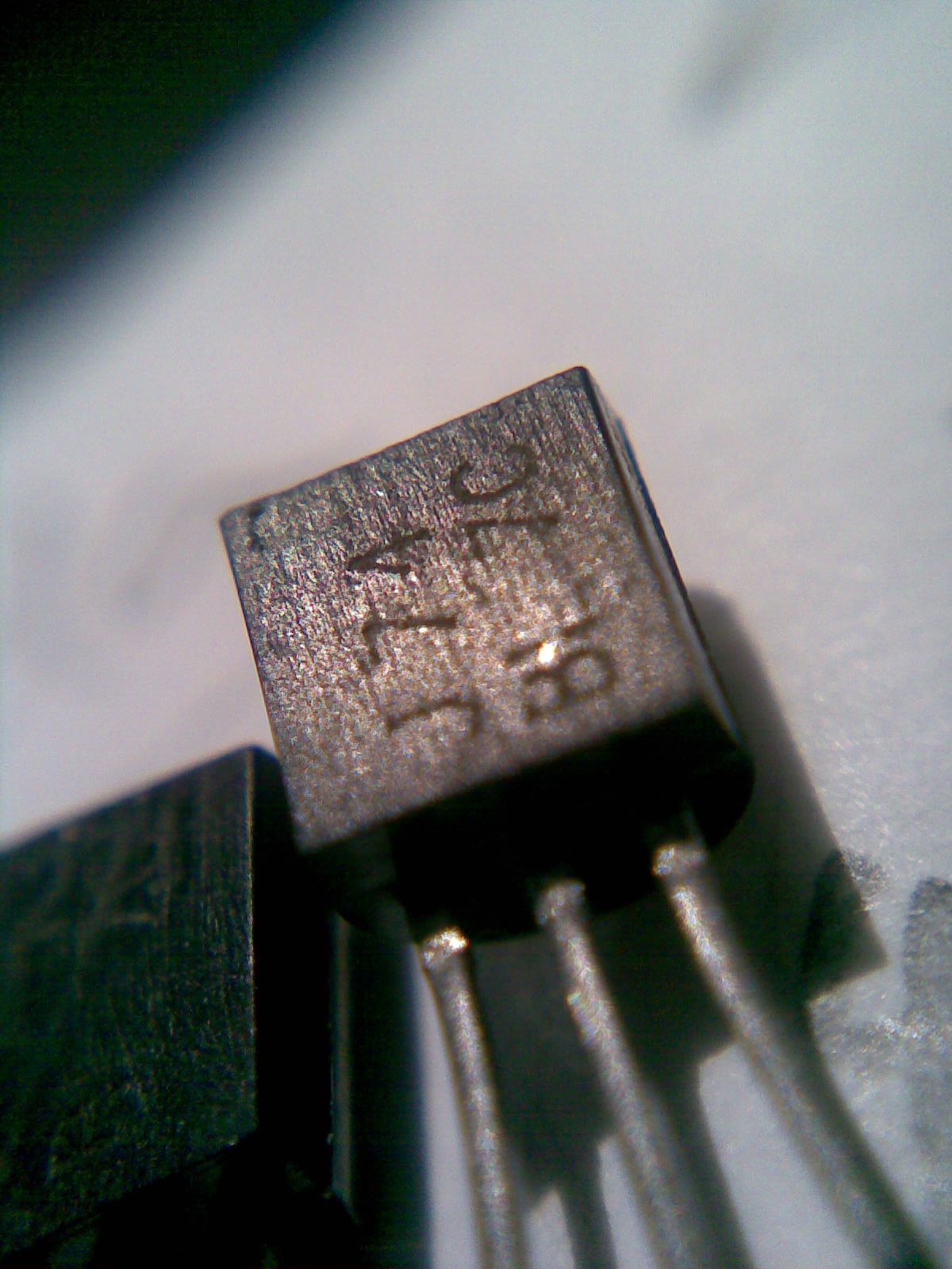

Some pictures:
You can see the scratches from the sandpaper they used to get the original FET name off. The new name is 'melted' (a hot die) into the transistor.
Here you see the faint original number 1271 on it. Wonder what FET this actually is (at 20 mA Idss) and rather low transconductance.
Here you can see the name of the supplier who is to go here: :wave2s:.
oh well . . .
albert
... i feel the mosfets (Fairchilds running at 1.4A) are running a bit cool ...
That's not cool at all - look at the datasheet (thermal resistance between semiconductor and the case) and you'll see that the silicone inside your MOSFETs is well over 100 degrees Cels.
If you push the temp. on the MOSFET's case to 100 C you'll be very close to destroying them...
Thanks juma,
Can anyone advise on a safe max temp on the junction?
If im getting 76 C on the case (front) does this equate to about 88 C on the junction, if im reading the data sheet correctly?
Or is the "case" the back of the mosfet?
If so i guess i cant really measure that effectively.
