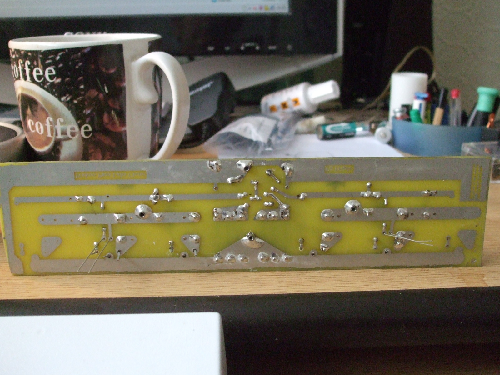

Just before I disaper in the loft for the next few hours I tought maybe I can post a couple of pictures of the Fair PCB.
I got room for a triplet but I do not realy make to many changes as I want to compare the sound of the Fairchild with the Toshibas
So I am commited now: 31V 2.5 A rails about 42 W disipation on each.
If they blow I think it be handy to know (I got speaker protection that need a proper testing as well)
If you do not hear from me soon it means that I am to busy listening to sweet music

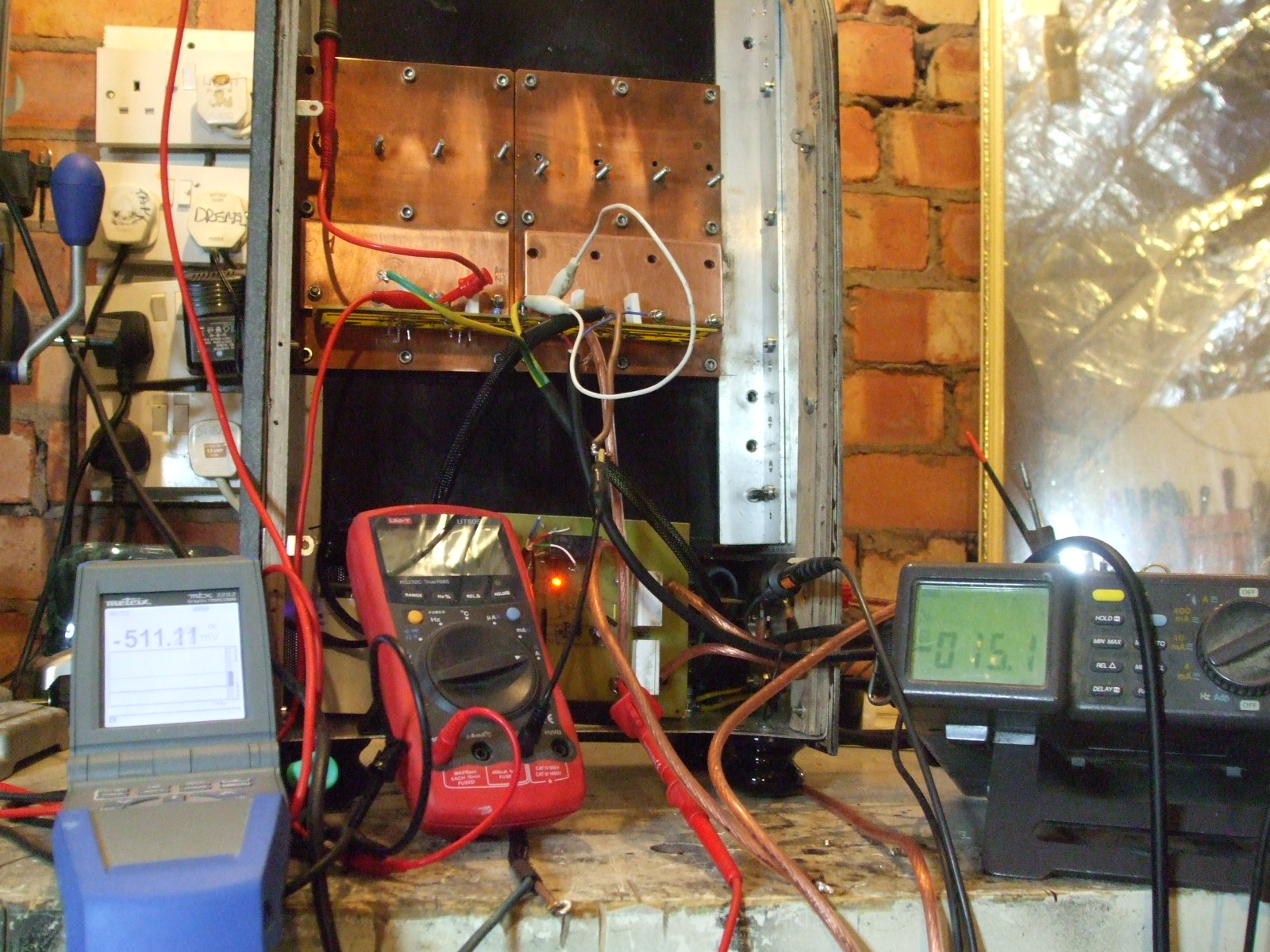

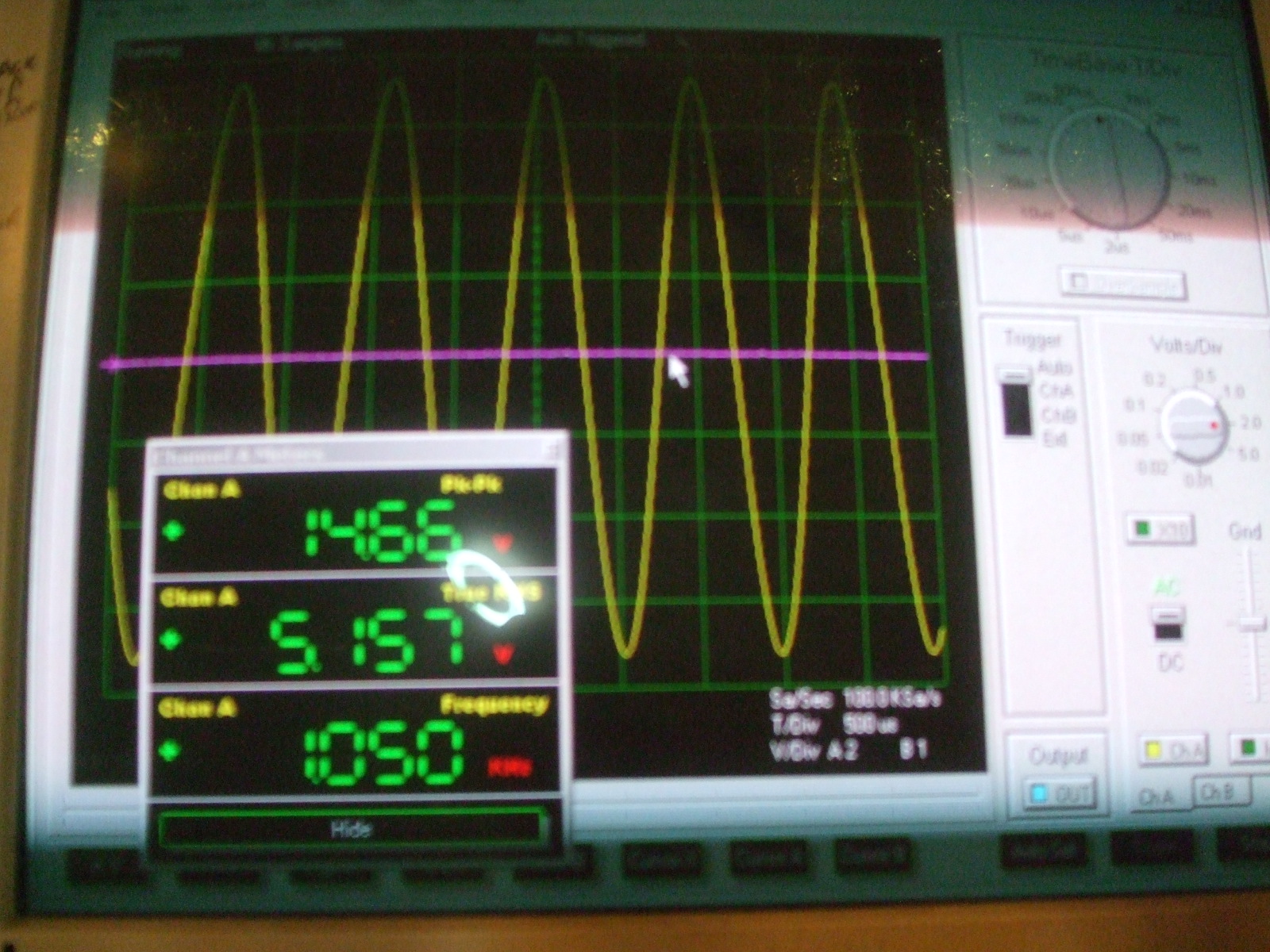

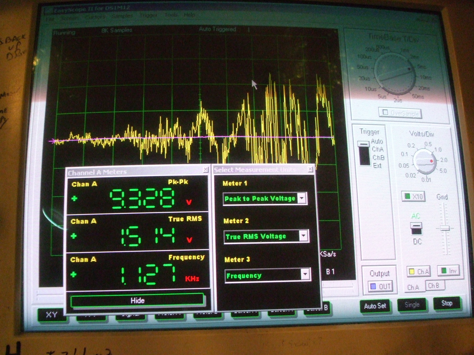

I got the thing running (ang on a minute may be ugly but still F5 )
So re start
I got the first channel of the F5 running with the Fairchild and tought about posting same results.
First impression sound wise on Gales Gold monitors (4 Homs ).
Bit more dinamics and gain bit less harshnes on Hi frequency when compared to the Toshibas.
1)Just warming up at the sound of Doors and taking it easy at first
2)the rig (yess sorry 3 meters one just mesuring current on the positive rail bit like belt and braces
3)1 KHz 14 volts peack (for now)
4)2.7 A (rail )38 C on the heat spreader about 1 and 1/2 hour in A bit less than what I was especting to be onest it maight mean that the heat is staiing in the mosfet.
Just for those that missed a bit (no much chance of that me think)
I use Kerafol 86/83 on 13 mm thick coper heath spreaders Mosfets are bolted realy tight and sprereaders are bolted on to the heat sink (300 X 400 X83)on hand lapped faces with a bit of graphite thermal grease the lot is capable to dissipate 250W for a sink themperature of 50 C
I will need to mesure up the Junction temperature at the Drain pin as close to body of one of the FQP19N20
So same 200 Homs pots and a tiny PT100 on order.
Tanks for help
PS R5 and R6 are still 2.2K same as for Toshibas I remember there was an isue with tose values a while ago so it may be handy to know
PSS watch out for + felt tip on board of my previous post is wrong and you may cause same serious dammagge
