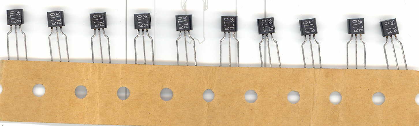

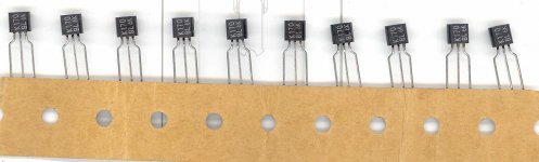

Do you think these are genuine or counterfeits? Thanks.
Where did you get them from?
http://www.diyaudio.com/forums/swap-meet/159691-toshiba-2sk170-v-sales.html
that was easy
pretty impressive pictures
I dont know, but maybe both bulk or reel might have been available, on order
that was easy
that was easy
or maybe not
my own have straight legs
I got mine from Spencer, a long time ago
matched quads
idss clearly written on each
got hit by 'osmosis'
hey, please mark my words
I do not know
but what I see in your picture looks slightly cheap and 'dodgy'
or in other words
doesnt look carefully made like we see other Toshiba's
writiing looks a bit quer
Jfets arent sitting straight
legs arent paralel, or nicely seated in the tape
and tape looks, ehh, cheap
as said, I do not know

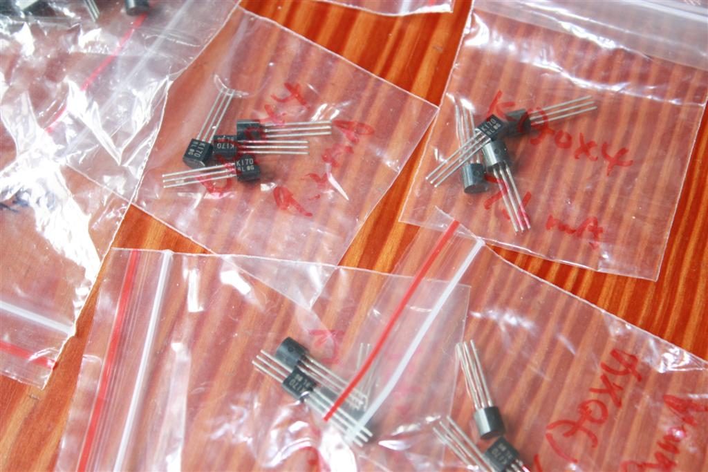

Spencer's new stock are bulk, but tape is also genuine.
http://www.diyaudio.com/forums/vend...anted-but-hard-get-they-here.html#post2130034
So you cannot judge on the package alone. The only way to test is curve tracing.
Patrick
Patrick
what I see in your picture looks cheap and dodgy, or in other words...
pretty authentic.
