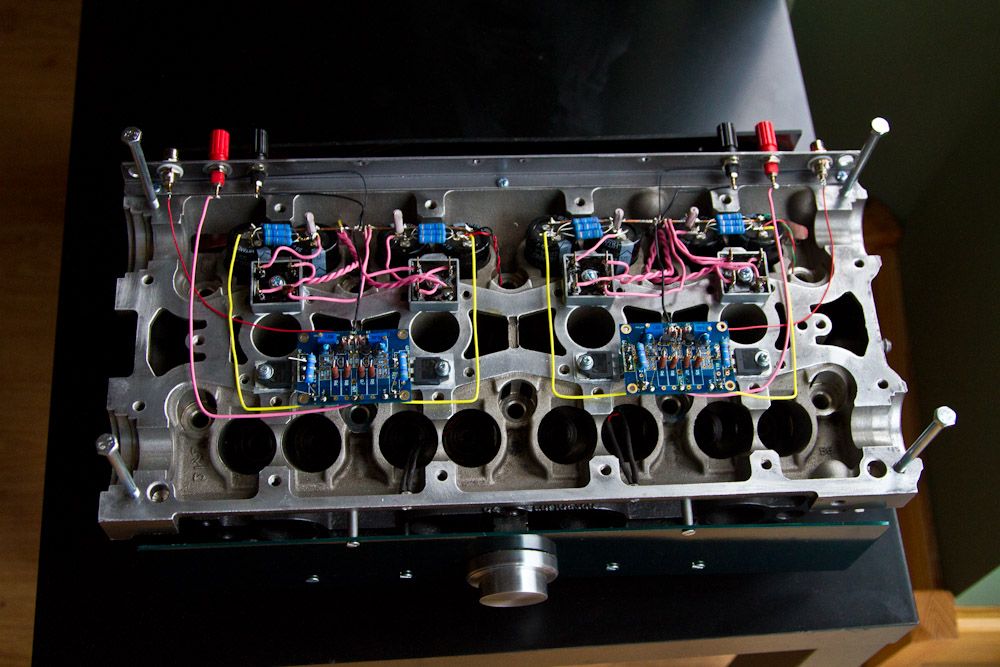

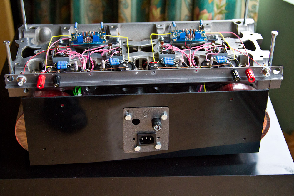

Here are the pics I promised earlier in the thread.
I have a problem though...... something is going on with Q4 when I connect up the speaker (just one channel, left side in the pics) for some reason when I connect the speaker the 0.47R resistor for Q4 smokes. It does this whether the inputs are shorted or not.
Could this be oscillation? I did use a gate stopper - its on the board, (PDs F5 boards) but I haven't seen anyone else report problems even though it could be mounted right on the leg.
Fran
Fran
No, they're in fully - well tightened down.
I went back and added in the temp compensation stuff - thing is, when I tried back out in my workshop, it all powered up fine. I had these hooked up to my stacked quads when the resistor smoked. I wonder if thats something to do with it. They would present a pretty bad load. No problems when hooked up to the test speakers.
I'm doing some more investigating.... can't see anything wrong in my wiring etc....
Fran
Fran

Nice... a high rewing 16V - F5 !
Did you check the isolation for the MosFet?
Arne K
Fran

Your pictures missing rca ground!!!!
No, RCA ground is there alright - its kinda tucked around the RCA jack and runs along the piece of alu angle to the star ground on each PS.
The amp plays perfectly with my horns.... so I'm starting to think that this may be an issue with the other speakers I hooked it up to.... stacked quads. I reckon it doesn't like the impedance presented by them.
Anyway, I haven;t actually made up my mind on this..... need more time. I was blaming my valve pre but now I don't think it was the issue.
Fran
Fran

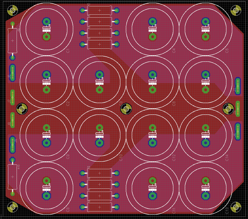

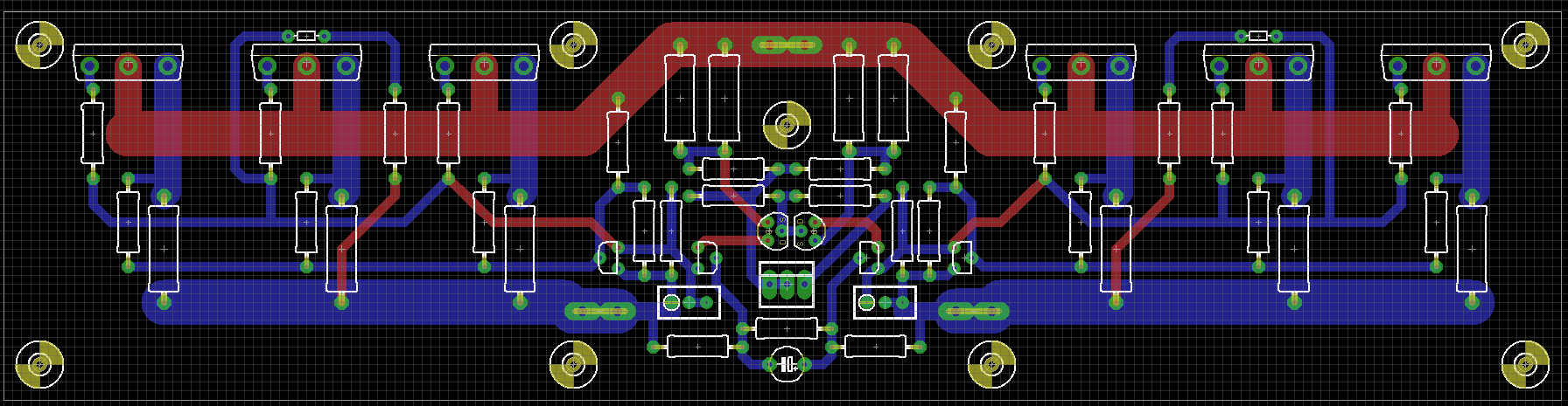

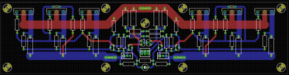

Think I finally found a configuration I am happy with.
CRC PSU 3 x 18,000 uF - 4 x 1R0 - 4 x 18,000 uF, one for each channel
F5 cascoded input with 3 x output pairs.
38 Volts supply, around 70W/8 ohm.
Now I just need to get PCBs made, unless I have a few last minute changes.
