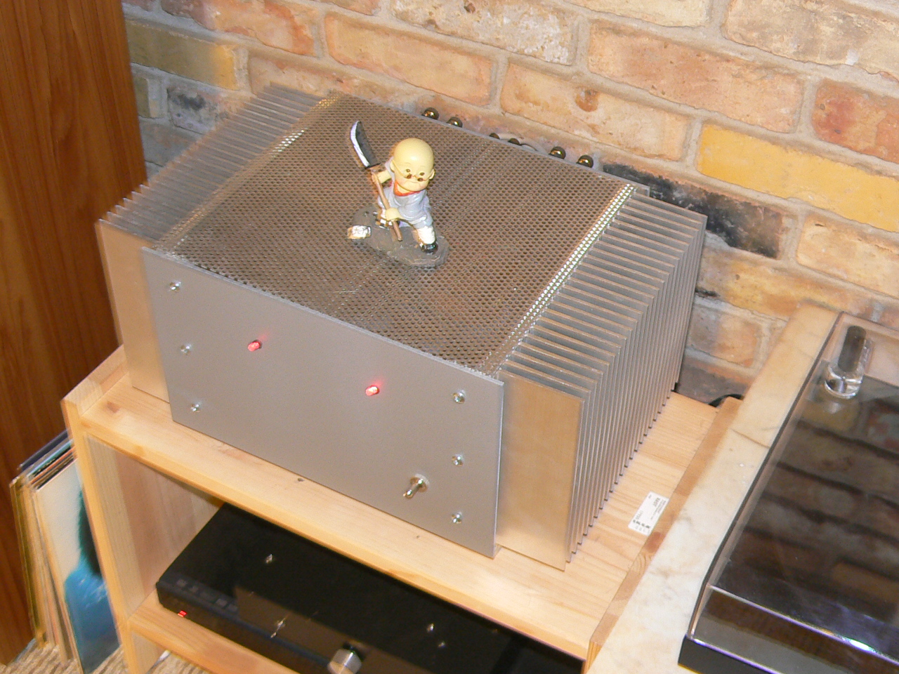

Could use some decent feet.
The picture doesn't show it clearly, but it is on spikes about an inch high.

Spikes into that wood shelf !
Sacrilege.
Actually spikes on ceramic tiles on wood. It's a temporary arrangement while I put together better stands.
Hi,Actually spikes on ceramic tiles on wood. It's a temporary arrangement while I put together better stands.
is ceramic tile as a foot any better/different/worse than spikes+ceramic tile or no foot at all?
Never tried the tiles alone. There is a difference with the spikes over no feet for sure. The tiles were to prevent the spikes from digging into the wood. The best sound was with the spikes on a 1" thick marble top with heavy wooden legs which I built for my turntable.

Looks like 7x10 pieces from heatsinkusa. I have the very same setup and they are just barely adequate. Hovers around 48-50 deg C most of the time.
8x11 with 2inch fins. They are R-Theta heatsinks. Should be in the ballpark. I hope.
Slightly under the 96 in² the F5 article recommends. Probably be alright.
