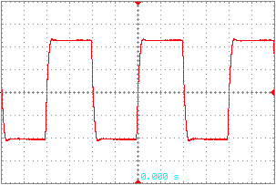

jackinnj said:
There are two peaks, and it seems to relate to stray input capacitance and the value of the input resistor.
So I picked a convenient channel and looked at the square wave
at 100 KHz while playing with the Mosfet Gate stoppers and the
Jfet input resistor.
Reducing the input 1K to 820 ohms gave me a slight improvement in
overshoot and increased the slew rate slightly. Going to a lower
resistance increased the overshoot. Frankly, I don't see a
compelling reason to change the 1K value unless you are dealing
with an amp which has severe overshoot.
I varied the values of the Mosfet Gate resistors between 47 and 150
ohms. It didn't make enough difference to comment on, but I have
seen it have an effect before, so you wouldn't want to rule it out.
Of course a small capacitor to ground at the JFET gate kills the
overshoot nicely. A few pF does the trick.
Here's a 100 KHz scope photo with the 820 ohms, no capacitor,
and 75 ohm Mosfet Gate stoppers

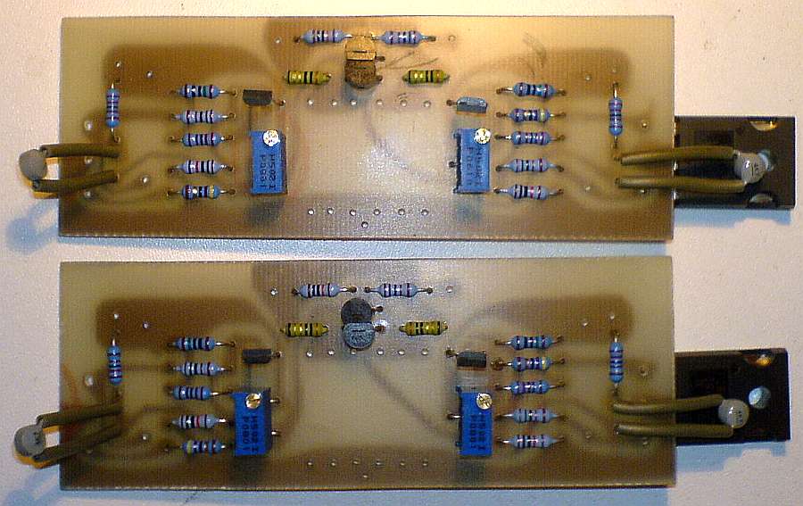

stefanobilliani said:
Nice Board Juma : mine is in acid right now
:cool:
Good ! How do they look ?

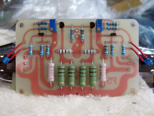

Mine are out of acid, and stuffing is on the way (see attachment - still waiting for FQA 12P20 and power resistors, but I succeeded finding two pairs of J74BL / K170BL)
They arent out yet ; also waiting for the J74 to come , and need to find the thermistor . All the other parts are ready . Chassis and heatsinks included . Mmmmm I will install also a stereo log pot .
:cool:
Re: Re: Re: Re: Re: My F5
:cool:
Why is it taking so long ? I etched mine PCBs in 2-3 minutes with 10% HCl solution and 8% H2O2.
I dont know , but its taking too long infact and I am a little worried for the traces . I went to the electronic store for a prepared acid . It is 60% Ferric chlorid crystal ( FeCI3 6H2O ).
The brown stuff ? 25 years ago, barely teenager, I had bad experiences with it (etching lasts forever, stains on clothes won't come out...) and I never used it again - it's pain in the neck !
yes youre right , I will not use it anymore .
:mad:
edit : reading that and the etching thread it seems I am a bit late with this , but I'll change , promised , no more brown stuff .
:devilr:
