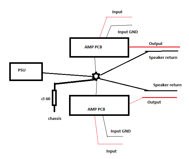

Put a CL-60 in the red cross point (as Nelson suggest). You're done with the loop.As this
You can put another one in the preamp green-cross.

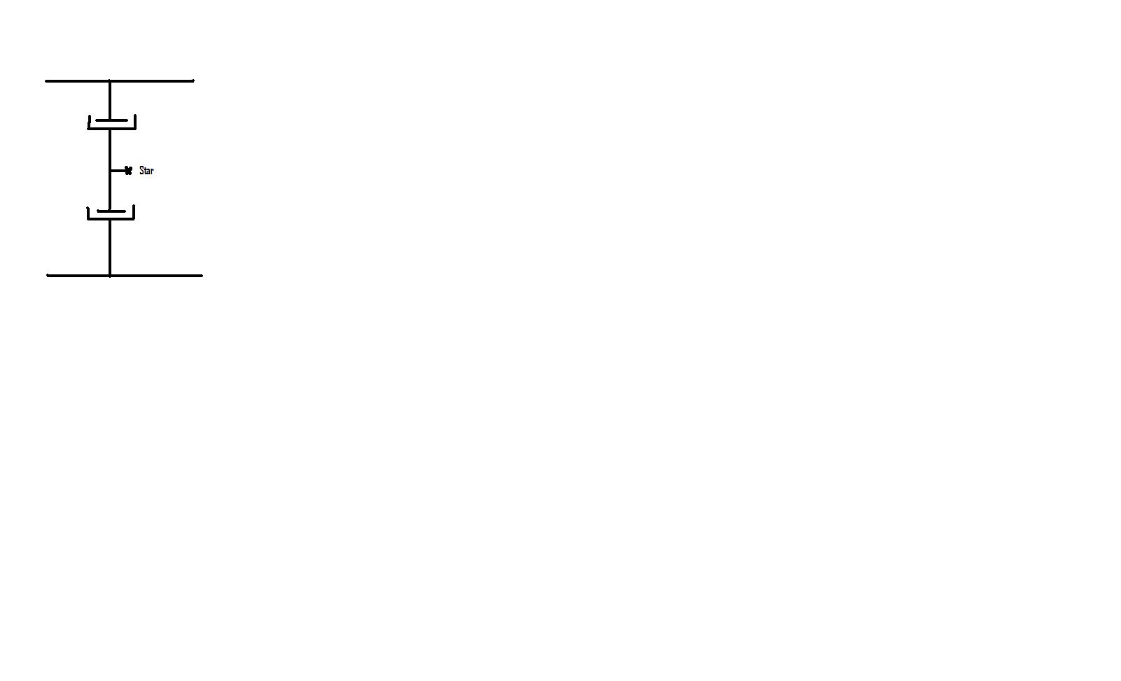

Regiregi may be right but in the crapy drawing I made some one may decide to fit one on the mains plug of the preamp and cause same serious damage.
Me think that we need a beter drawing showing where they are and it is my fault that I posted that Iquam work is much beter but it does not show the connections to the pre and such and most commercial cables have the screen connected to both ends and it does not need to be.
Regi
Edit: Sorry, forgot the attachment...
So if you put a cl-60 from psu gnd to chassis ground like the power supply example in the F5 manual, then the ground loop will be gone?

I am preaty shure you can do much beter. What is the function of the TH1 in Papa drawing?
found this way beter than any I could possibly post

Sorry but yes, THEY WILL, that's why they are there. Because of the added resistance. Of course it will not cure ALL ground loop problems, but it will with the ones that are caused by mains protective earth. At least to a certain degree. In case of a fault, they carry big currents, so they get hotter. As they get hotter, their resistence falls, what allows the to carry even more current. Until your PROPERLY SIZED fuses blow.The thermistors ad resistance (10 Ohms) to the ground it will not cut a ground loop if there is one
Please someone correct me if I am wrong.
Anyway, said that, I prefer to have a back-to-back pair of diodes with a resistor and a capacitor in parallel. Using a diode bridge of 35Amps allow VERY big currents to flow for a short time. Even if you burn the diodes, the fail closing, so they will still conduct until the whole device is melted. Even melted, it will still conduct So a very big sized fuse would be installed if you reach this point.
Bksabath, what's the downside of having the CL-60s in the primary windings? Please, don't account those things you're afraid regarding bare wires and so. We asume a correct safety implementation, not leaving bare wires floating around the case ( )
An expert should confirm me but, I am pretty confident it will.So if you put a cl-60 from psu gnd to chassis ground like the power supply example in the F5 manual, then the ground loop will be gone?
Yes, that's exactly the way to do it neutrality.
So it is ok to have your star ground point "floating" as long as it is connected to the chassis through a cl-60?
