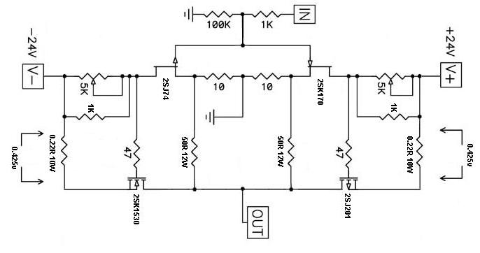

Hello,
I am hoping to build the Toshiba 2SJ201 / 2SK1530 (Non-balanced) version of the F5, using the 2SK170 / 2SJ47 input FET’s which are BL type (I have a few pairs I need to use). Would this circuit, with these values work? Or will I have to buy GR or V type JFET’s?

BL's are fine , and exactly what majority use
circuit is probably fine , too
Thank you Zen for your advice, I’ll build it and see how it sounds.

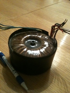

I have almost everything I need for an F5 amp now. Boards + parts, heatsinks, casing, connectors, caps and a nice pair of filterchokes.
My problem is that the trafo has 2 x 25Vac (off-load) secondaries. I tried to figure out if a choke - input filter is a possibility, a that might be a solution. I wired the psu - parts up as a choke input filter and used light bulbs as a load. Drawing 2,8A I got 40Vdc (secondaries i series) and that is a bit low I guess. NP says 23-24V in the F5 article.
Could winding down my trafo and make a CLC filter be a solution? It is the one in the picture and it is potted with something in a plastic bucket, so winding it down seems a bit troublesome. Is it possible to heat the thing up and get the potting substance of?

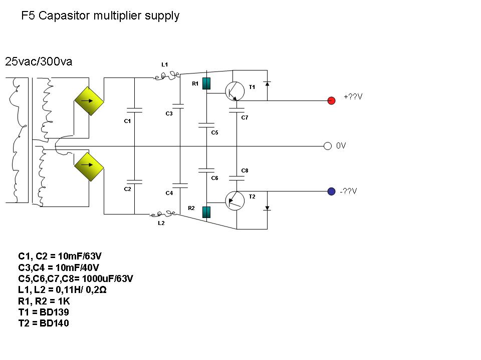

nope
make cap multiplier in both legs
it will shave ~ 4Vdc
Tried reading up just quick. Could it be something like this:
What voltage would come out?
