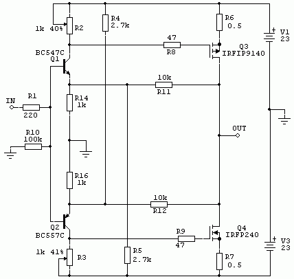

Bipolars would work in Q1/Q2 position for F5? Anything to keep in mind or can we just swap in something of the right V rating and a high enough beta?
No, BJTs can not be used as a simple drop-in replacements for JFETs.
With some adjustments, a simplified schematic for F5 with BJT input would look like this:
There is no reason to use 2SK246/2SJ103 for the frontend. Their Yfs is too low and hence you lose too much open loop gain and hence amount of feedback. And you need to increase the values of the feedback resistors, which also reduces closed loop bandwidth.
If the motivation is to be able to live with high voltage, you can just cascode the 2SK170/2SJ74s with J111/J174 (Idss about 25~30mA). This will give you something like 5V Vds on the toshiba JFETs, and it is self biasing. Simpler than using BJTs.
At least this is what I would do. Of course there are other solutions that will work as well.
Patrick
The circuit shown in #8231 has no bias on the BJTs as they see no voltage on Vbe.
You need something like an amplified diode, but my knowledge of BJT circuits is poor.
AndrewT ?
Patrick
That circuit (post #8231) has very exact bias (about 7mA) on input BJTs through R4 and R5, R14 and R16.
It's tested circuit.
If you think of Vbe what is it - voltage between base and emitter, not just base to ground.

I thought you were using them in place of the K170/J74.
Even then, as cascode, the 2SK246/2SJ103 offers too little voltage (Vds) across the K170/J74, something like 2~3V. This means that any variation in Vds due to the high effective source resistance of the cascode device under dynamic load will have an effect on Id of the gain device.
On the J111/J174 I am using, I managed to get about 4V Vds on the gain device, and the Yfs is quite a bit higher than K246/J103. So I can only suggest that you try them for a comparison.
But Juma's BJT solution is also good, nice & simple. I like it, especially when used with truely complementary MOSFETs like K1530/J201.
