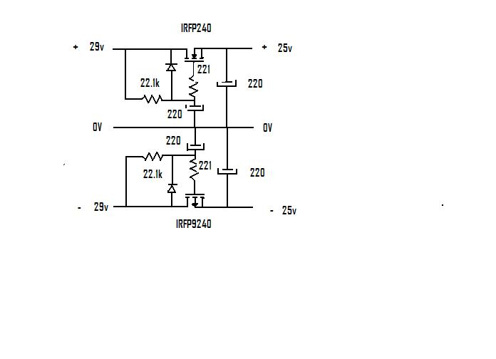

On my Parallel caps I did it like this, because of the nice color contrast with the copper wire and brass bolts on caps, how ever doesn't always make good contact maybe didn't get all the enamel off the wire or not a good way ?.
Hi awc,
try soldering your copper cable to one of these ring terminals.
3.2mm Ring Terminal Red 10pk | R1-3V
should give you a better contact. I also ise these with flat ofc cable I bought a while ago. Looks sharp and can handle lots of current. Yours is a little on the lean side IMO.

Luke, I would opt for heavier gauge wire. One choice that is inexpensive is 12ga or not quite as good 14ga solid core AC mains wire (the stuff that goes in walls)...

Can you use a 2x21Vac toroid instead of a 2x18Vac for this amp?
Yes with a capacitance multiplier to drop a few volts.
??Yes with a capacitance multiplier to drop a few volts.
The voltage 21VAC will give you rails that are too high for the jfets. You can lose a few volts in a cap multiplier like suggested - google around to learn more, they are quite nifty. Here is a basic explanation:
Capacitance multiplier - Wikipedia, the free encyclopedia
You can also lose the volts in with a cascode of the frontend, but that is at least as complicated.
