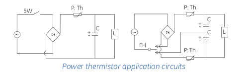

Hot CL 60 thermistor in the Ac input line
I follow the power supply schematic in the manual but use 160000uF of line filtering from a 500W transformer.
i notice that in use the thermistor is very hot to touch.
With the Ac input switch off, I can only touch it for about 5 seconds.
I am aware that the thermistor should not be touched when the power supply is switched on as it is carrying live current
Is this normal?

ac line thermistor
This is the thermistor that I use
GE SENSING / THERMOMETRICS - CL-60 - THERMISTOR, SERIES CL
Farnell order code Order Code: 1653469
The application circuit from the manual is attached.
i notice that the thermistor is in the secondary circuit . F5 manual use the thermistor in the primary circuit.
Is this difference significant ?
Sorry my knowledge of electronic is basic.
kp93300

Thermistor temperature is proportional to the heat it dissipates.
At a 1.25A current level it dissipates ~1.7W heat, at 2.5A some 2.75W.
At 3.75A it's 3.65W and the maximum it handles is 4.5W at 5A average.
In a monoblock F5 at the primary side, a CL60 would dissipate less than 1W.
Connected at the secondary side, dissipation is much higher and temperature of the thermistor would be too hot for the touch.
Placing it right in front of 160.000uF (or 80.000uF) is not the wisest thing to do.
Read the CL60 line in Fig1 of the CL datasheet : www.thermometrics.com/assets/images/cl.pdf

Hello kp93300,
It's best to bypass that thermistor with a relay a few seconds after startup.
This way it can cool down and function again as soft start.
If it stays in the circuit it remains hot and its resistance low, it won't work again as soft start if you quickly on-off-on the amp.
Also put the thermistor before the transformer (on the mains).
See my post for more info: F5 finished

CL 60 thermistor
Thank all for the replies.
I have the thermistor behind a soft start board that i bought from Connexelectronic.This is on the primary side of the transformer.
i have used this set up for the past one month .
I check that the maximum operating temperature of the CL 60 is 175 deg c .
I think CL 60 will be ok
