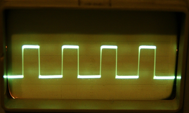

I finally connected together correctly generator and scope.
Here is a picture with a 20kHz square signal on dummy load (i try higher frequency signals also - looks good too), In addition, I connected a scope with 8 ohms speakers- and played Denon audio technical CD (with different signals etc) Even at max volume with passive preamp there is not visible clipping.
After this I conclude that my amplifier works well technically. The rest is a matter of taste.
